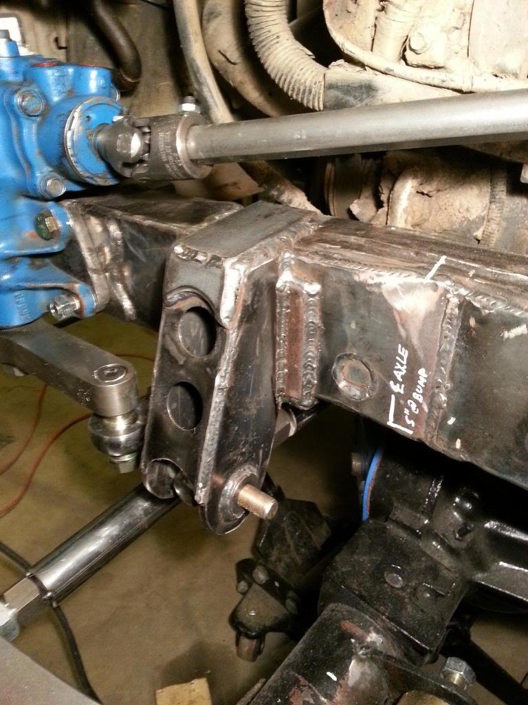

    Panhard is basically done. First work with the dimple dies :cool:

    QUOTE=45acp;7851351]Panhard is basically done. First work with the dimple dies :cool:
    [​IMG][/QUOTE]
    Dimple Dies are the shiznipple. You gonna tie that sucker in on top of the frame rail too? I would recommend it. Take some 2" wide barstock or so and lay it on the frame and rinnung down onto your panhard bracket for extra piece of mind.
    You can see what I did here ( I didn't want to cover up my dimple dies either):
    It encapsulates the frame on three side then, super beef, lol.
    Also are those weld washers or regular flat washers you're using?
  16. Dec 13, 2013 at 10:23 AM
    #1536
    45acp
    45acp [OP] Paint me back in Wyoming again...
    Aug 9, 2009
    #20861
    6,705
    Jonathan
    Boring, Wisconsin
    1981 Long bed 4x4
    It's tied in on the bottom and basically tied in up top. Can't see it from the pic, but I have a 1/2" wide 1/4" thick piece that's welded to the rest of the bracket that sits above the frame rail.
    Those are just regular grade 8 washers. In addition to 2 more of those inside the bracket, there are smaller dia/thicker grade 8 washers on either side of the heim acting somewhat as misalignment spacers. Not that I need much movement for the panhard, but it should work ok.
    Edit- Panhard tabs/bracket is 1/4" plate, heim sits on a 3/4" bolt.

    where you drunk when you welded that? lol
  18. Dec 13, 2013 at 2:56 PM
    #1538
    45acp
    Aug 9, 2009
    #20861
    6,705
    Jonathan
    Boring, Wisconsin
    1981 Long bed 4x4
    Which part? :anonymous:
    A lot of the welds look like shit, even more so because my welding has improved so I basically went back over almost EVERYTHING. Mostly because I was worried the old welds didn't have enough uniformity or penetration.
