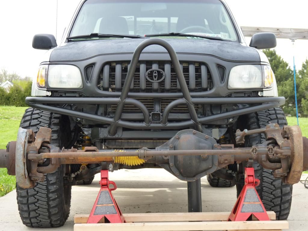

    JVC Deck, 10" sub mountd in rear seat cubby, 2 LED off road lights mounted in grille, amber raptor style grille lights, LED rock lights, square led bed light, custom made fuse block tray, 12 blade Blue Sea fuse block, 100a marine circuit breaker, black plasti dipped full grille, tinted tail lights + third, Uniden 520 with 4' firestik, Bilstein 5100s with 620lb Eibach coils, Diff drop, Chevy 63 leaf swap, TG creeper joints, 14" triangulated biletein 5125s, 8" extended steel braided brake line, TG Rock Sliders, CBI Moab 1.0 front bumper, custom fabbed bed rack, full TRD E-Locker axle swap and matching re-gear with custom stand alone wiring circuit, 29 spline pinion flange from an 06 wishbone runner, tubbed for 35x12.5" general grabbers on Ultra type 181 wheels, crush sleeve eliminator, Mini ARB compressor, front ARB locker, garage fab aluminum front skid plate, custom built high clearence rear bumper, removable mothafuckin doors
    jon, did i mention how I really really dig your bumper?
    Its just really nicely done and aesthetically pleasing and accomplishes everything it should for a rock crawler. I love my CBI bumper...but for rock crawling its big, yours is tucked up there for a great approach angle.
    after seeing how that one was done, if i did it again i would forgo the good looking cool factor of the plate bumper for one like yours.

    81,618
    Monte
    Wyoming/St. Louis
    The Trifecta of Taco's
    he sold the bumper...haha

    It is a beautiful bumper. I'm not even a fan of tube style bumpers but that one looks beast.
