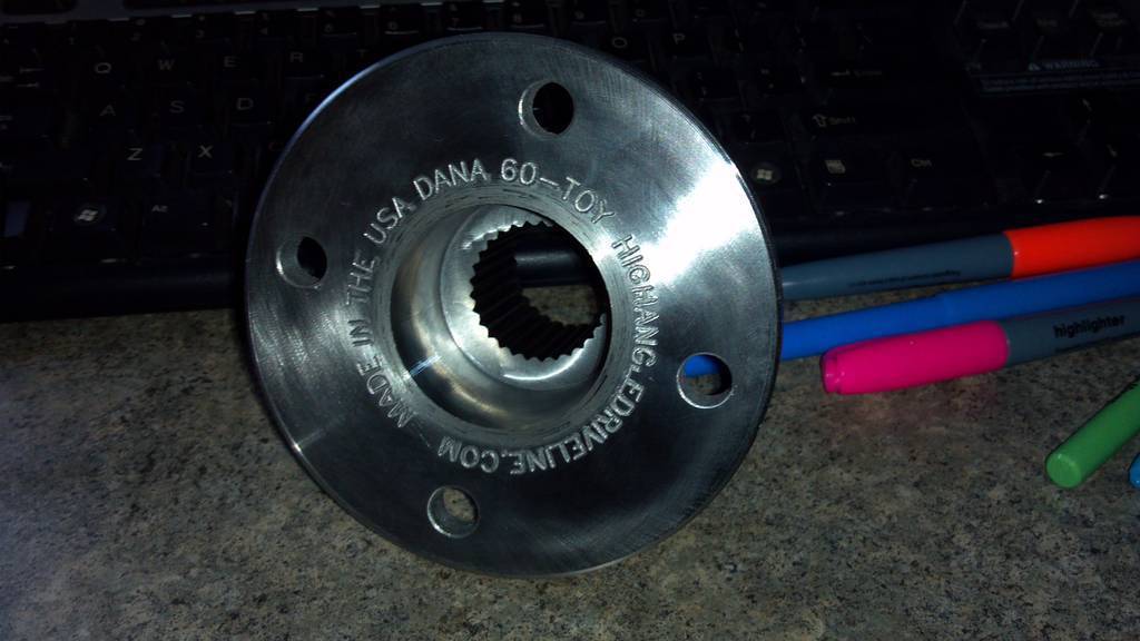

    Looks nice. I have one from TG and one from Sky. Bought them used but new. 'Cept they are double and tripled drilled. Hope that bad boy has the right pattern for your shaft!
    Lets keep the progress moving lol Summers coming :D

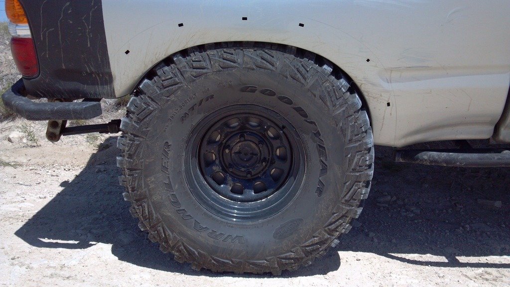

    Looking at doing a 35" MTR/OME lift on my Taco. Was curious, is trimming the bed a must? I'd really love to keep the bed uncut and clean for now, front would get glassworks fenders, and a tube bumper F&R/sliders.

    it is an absolute must. the tires will never fit in the fender without taking out around 1 1/2"
    the front of course also needs to be tubbed if you expect to stuff and turn the tire

    Yeah, if you expect to flex at all without rubbing, the wheel wells should be trimmed. Otherwise you'll likely damage the bed, flares, and probably the tires.
    Here's my 35"s stuffed most of the way without the flares and even with the bed clearanced, the corner of the wheel well is damaged/bent. Hard to see, but it's rubbing the opposite corner too.

    How much did you cut? That way I know to do a bit more since yours looks pretty close

    If you cut 1" you should be good! That's what I did and I don't rub. Nor does Paul

    Jon did 1.75 up front and I think 1 out back as well.

    Yea, that's what I'm saying...I think the gentleman is looking for rear clearance? Am I right?
    1" removed...

    hmm. ill probably to 1.75 all around then. might even need more since my BS will be so much (so little) what ever a smaller number means haha
