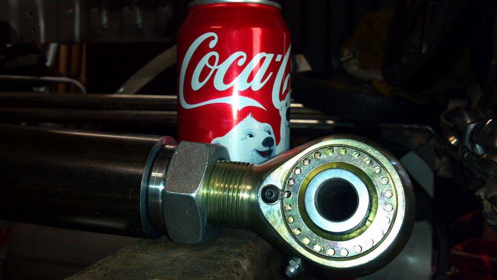

    I have been.:p I picked up the 2"OD .25" wall DOM (no more PVC! :woot:) and finalized the front lower links. Got em welded up, setup the axle at full bump so I could make a cardboard mock up of the oil pan. I'll weld up the oil pan tomorrow and probably get the engine removed. Next step will be rebuilding the firewall.

    Did you sleeve the lowers or keep them .25 wall?
    2"-1/4"wall DOM does have a greater MOI than 1 1/2"-1/4"wall DOM, but I did notice after the last trip my tie-rod is bend pretty badly already, I would imagine my lowers would be too if they were only 1/4" wall...

    I left them .25", less likely to take direct hits than a tie rod or rear links. Rear links will definitely be reinforced
