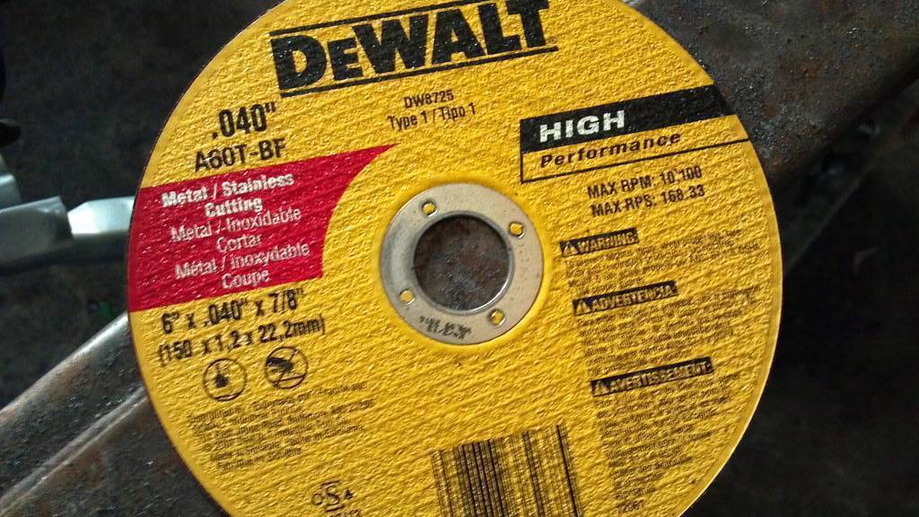

    Something I forgot to mention before - When I started cutting the boat sides I had picked up some of these 6" cutoff wheels
    $1.89 at the local Farm & Fleet for the same price as the 4 1/2". They work better and last a helluva lot longer. I'll never buy another 4 1/2 cutoff wheel ever again haha. Should have started using them a long time ago.
