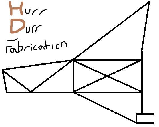

    Any suggestions on where to add any rolled tubing? Here's a 1 minute rendition of what I had planned -

    Paint CAD FTW!

    I would leave it how you have it, but add one tube dissecting the hypotenuse of the main diagonal along its unsupported length.
    And since you're not exo'ing, I don't think you need to roll anything, unless it gets to hard to follow contours where you want the cage. A rolled dash bar would be titties :D

    Rolled dash bar? Not sure what that looks like.
    Currently, the 'plan' was to keep the stock dash and steering wheel.
    I was gonna run some 2" tube behind the OEM dash tube to support the windshield ^ thingy
