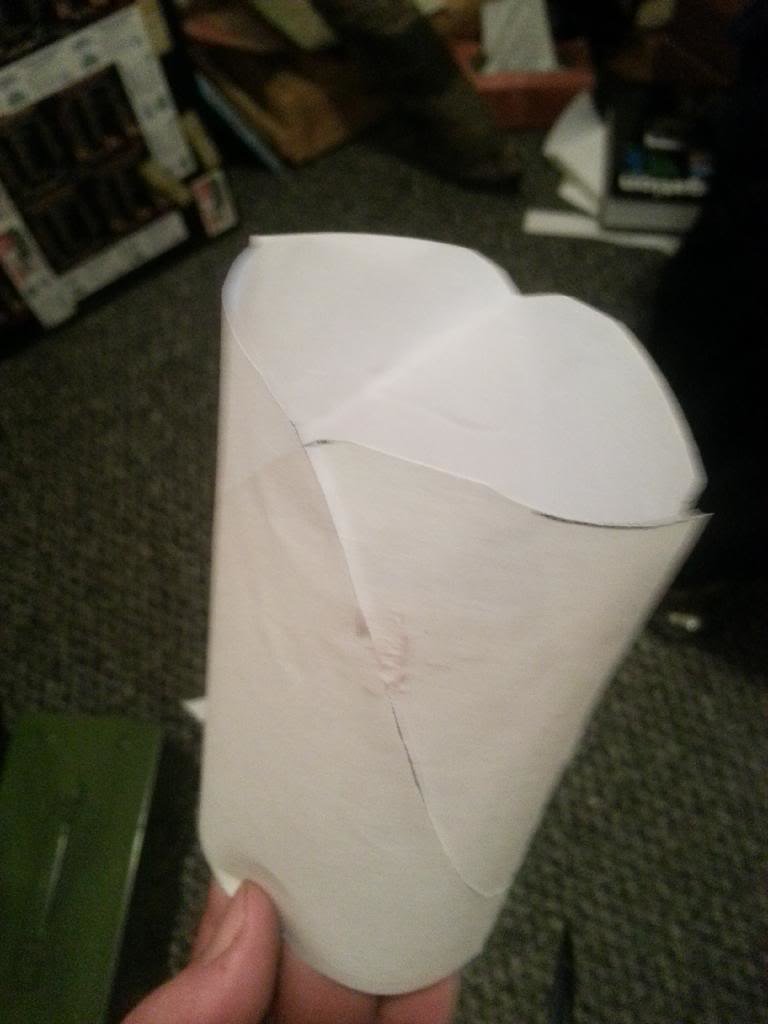

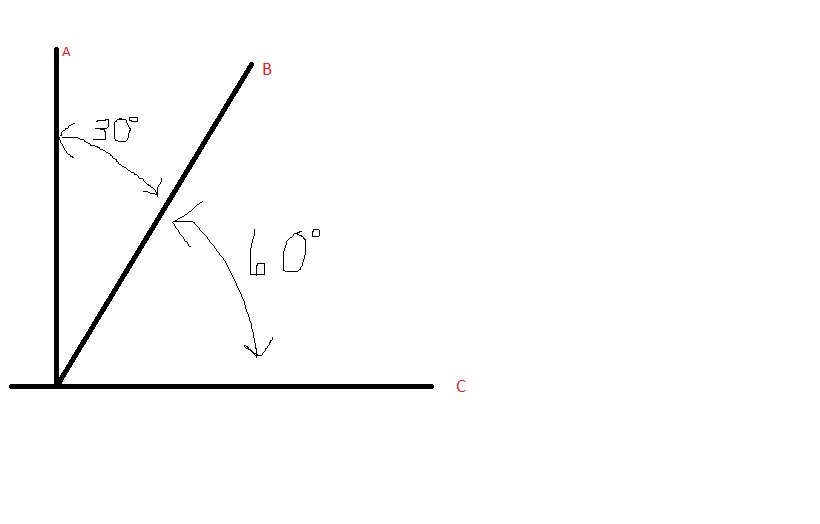

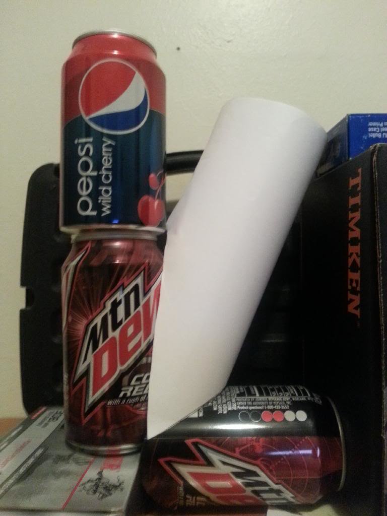

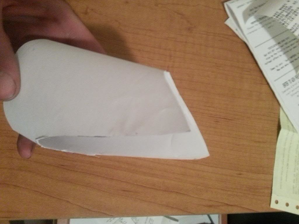

    I think i solved your troubles. So look at my paint-cad drawing.
    so i did my demonstration with pop cans and paper at 30* and 60*
    If you just take your two angles and print both and then offset the angle i.e. 180* such as my demo the have lines on there that rep 90*, 180*, and 270*.
    apply to pipe and cut.
    and finally you can see it compounds them quite nicely even when you just hack it together with paper and popcans.

    I'll be damned... I'll have to try this. Repped sir. :D
