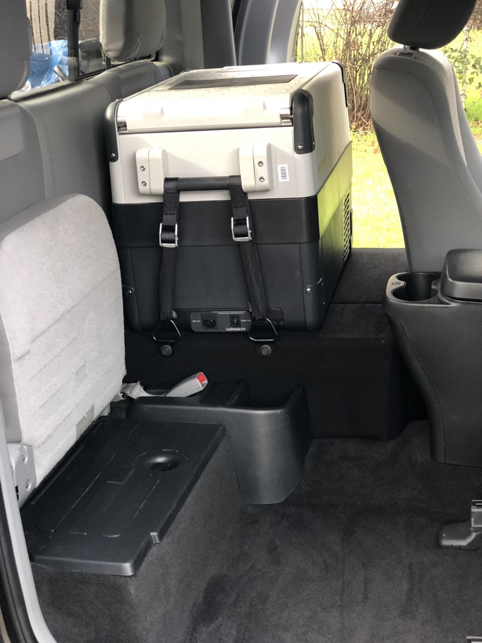

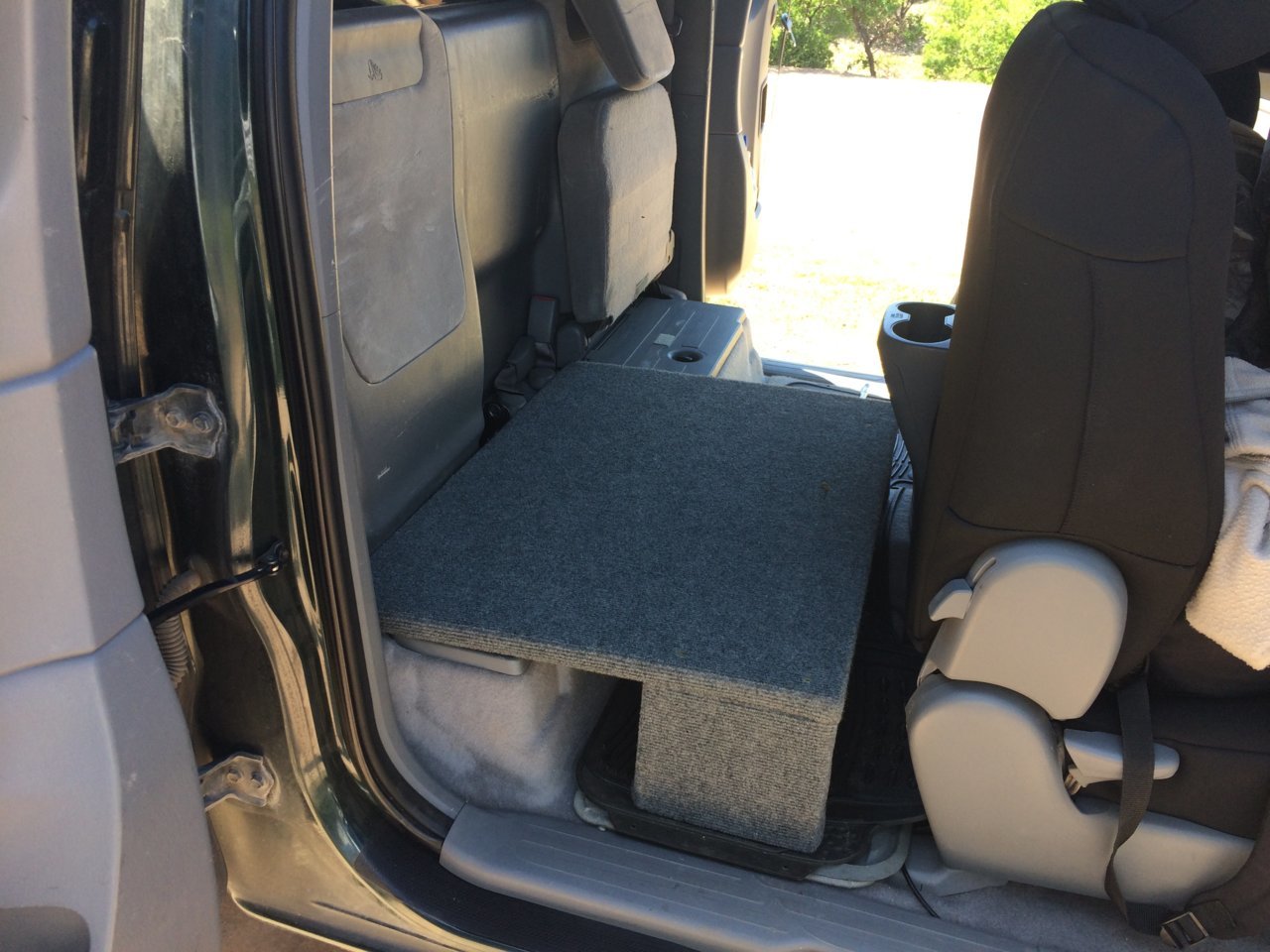

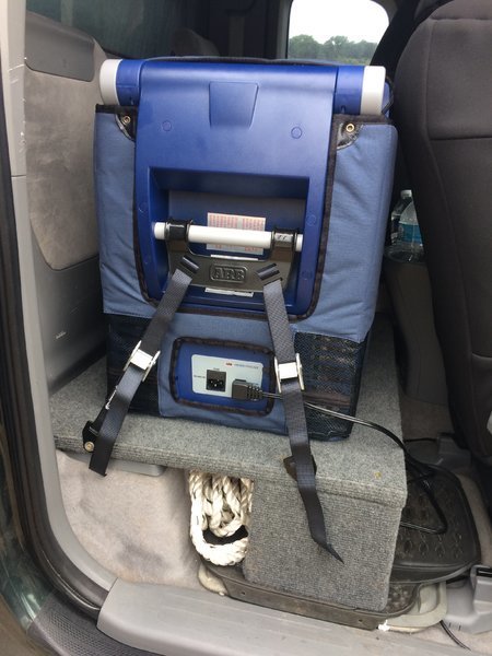

    Here is how i fit my 50qt ARB behind the passenger seat. Fit perfectly, you may consider a similar platform for your setup. I removed the bench seat and head rest from the passenger side. I recommend putting it behind the passenger unless you are under 6'0" tall. It would be a crunched fit if it was behind my seat and im about 6'1" for reference. The base of your fridge also looks a little wider than my ARB

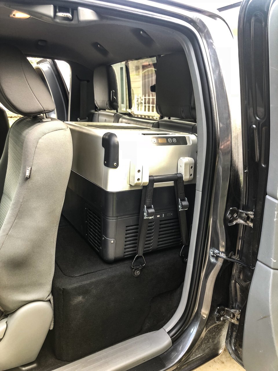

    Looks good dude! That’s basically what I am going with. Except I plan on putting my electrical and second battery in the same area. Here’s what I have so far. Obviously still needs a lot of sanding and wrapping with carpet.

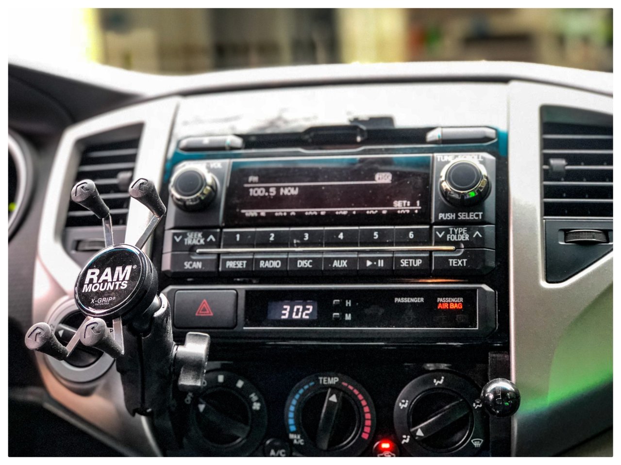

    Project of the day: A small but needed mount for cellphone and other accessories down the road. Got tired of the crappy cellphone mounts that fall apart in 6 months. B775C849-8B82-4563-A1F2-EE102C44690E.jpg

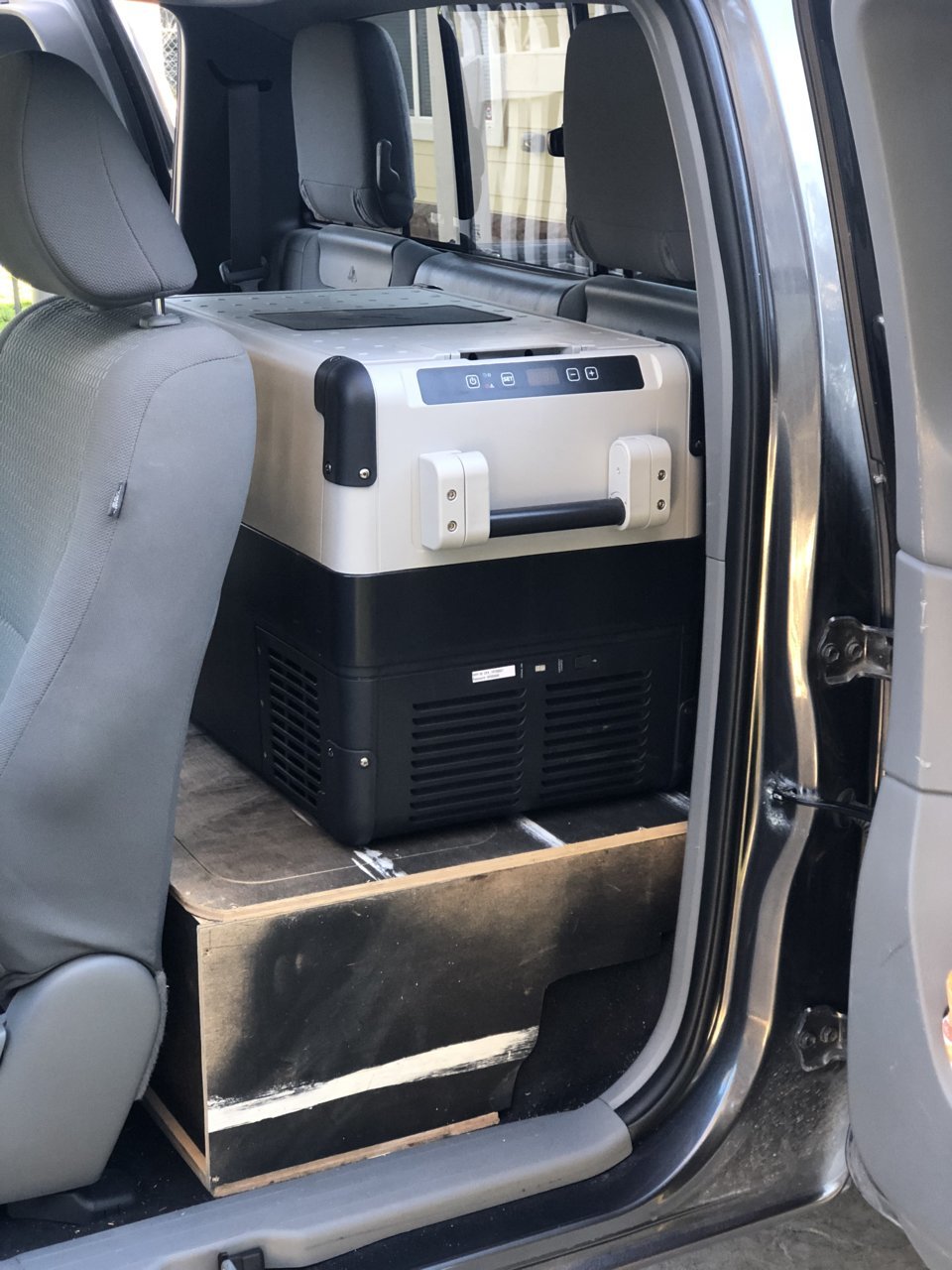

    Today’s project complete! The fridge now has a home. So does the second battey setup underneath.
    41C62C7C-CBC4-4EA7-9BAE-91D860ADDE03.jpg D0B670E0-B5E5-4888-A608-C9F68803D298.jpg

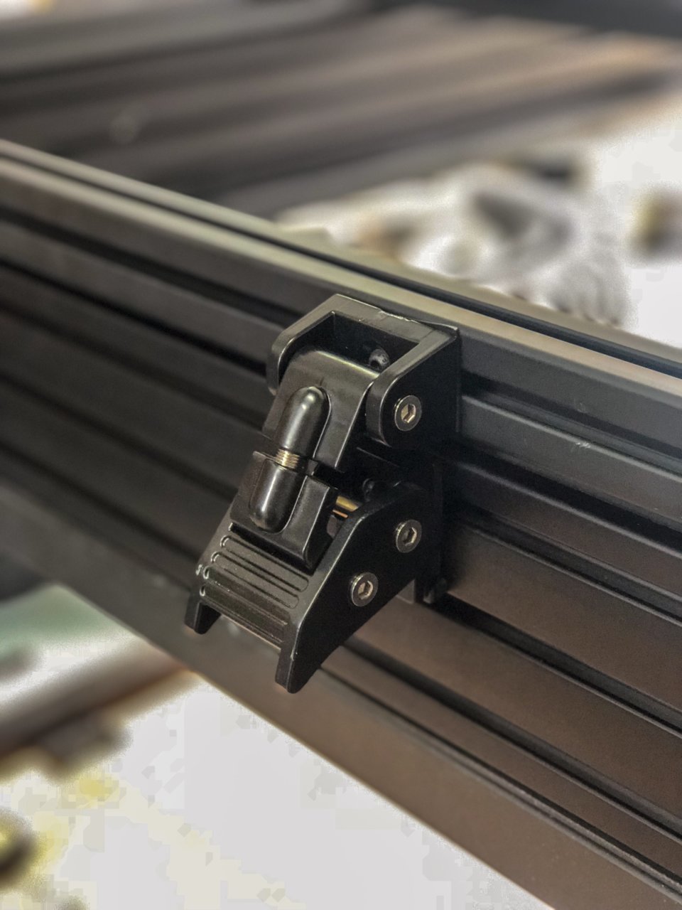

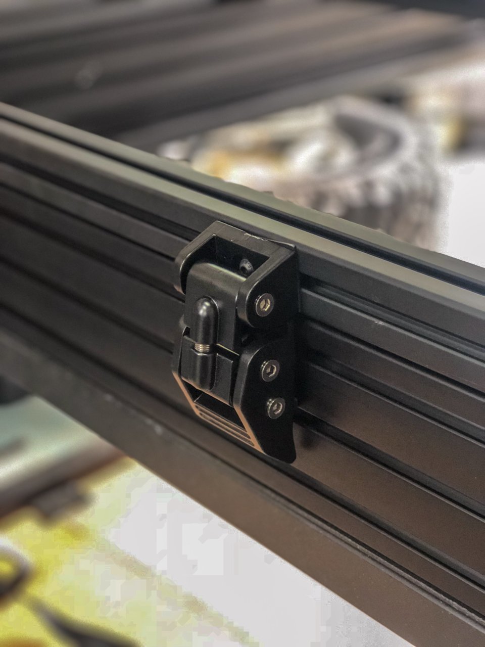

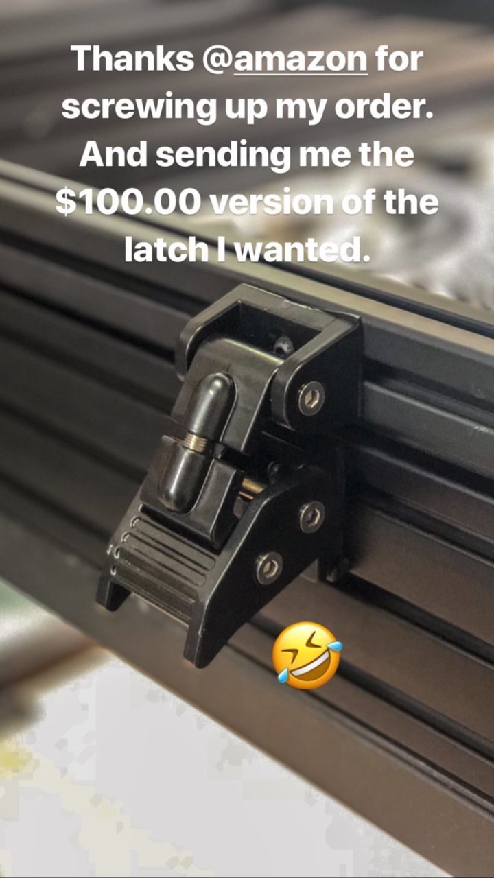

    So, update. I have been trying to find a heavy duty latch for the lid of the camper. I ordered a couple remote latches, try to do a strap type latch from the inside. 2BE43920-477F-4556-AF92-21AF2DEAEDBF.jpg E969DB20-D7D4-460F-A3F6-68D74F1BDCCD.jpg 08407858-7237-47F6-BAD4-5C6748406AA2.jpg I stumbled upon jeep wrangler hood latches. Ended up ordering the one in the first picture but really wanted the one in the second picture and didn’t want to spend $100. Well thanks to Amazon, they screwed up and sent me the nicer one. Installed it today and they work like a charm. Use some 5/16 back plates from 80/20.

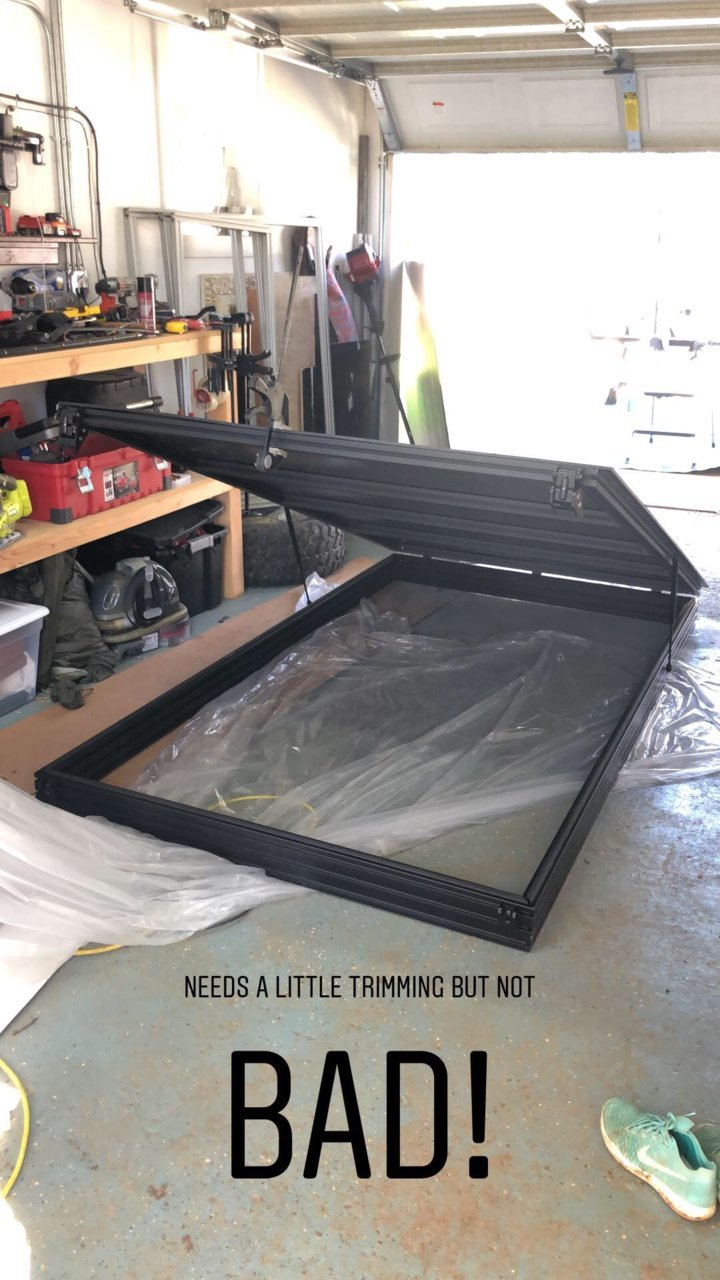

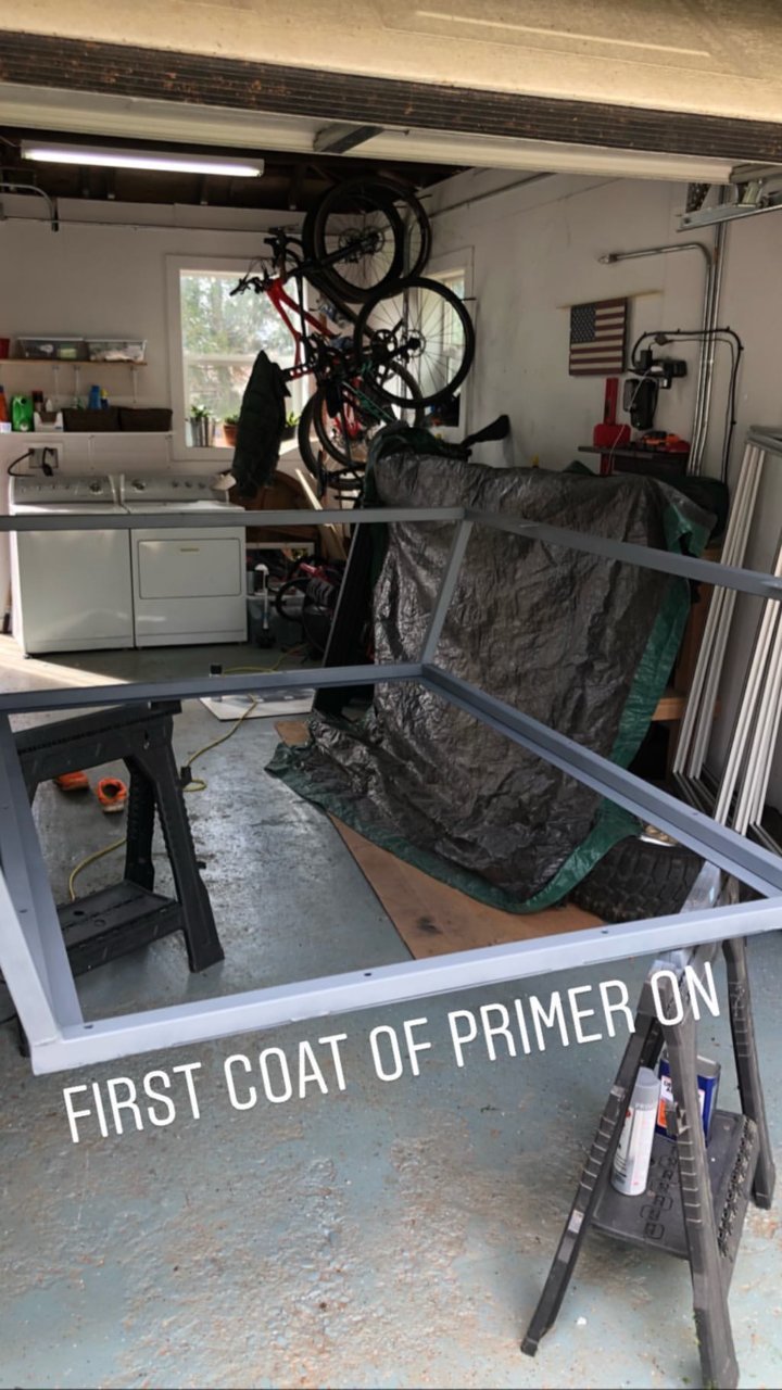

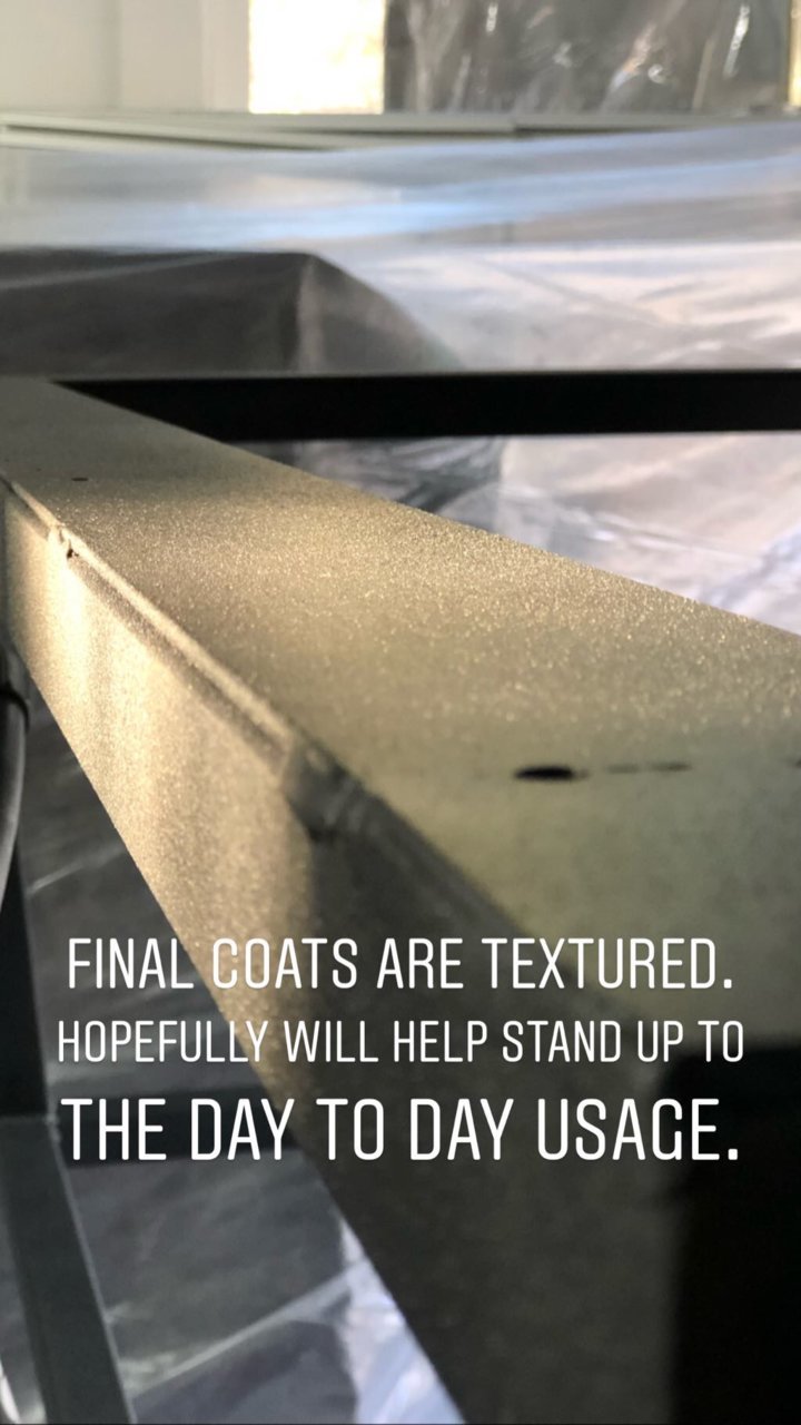

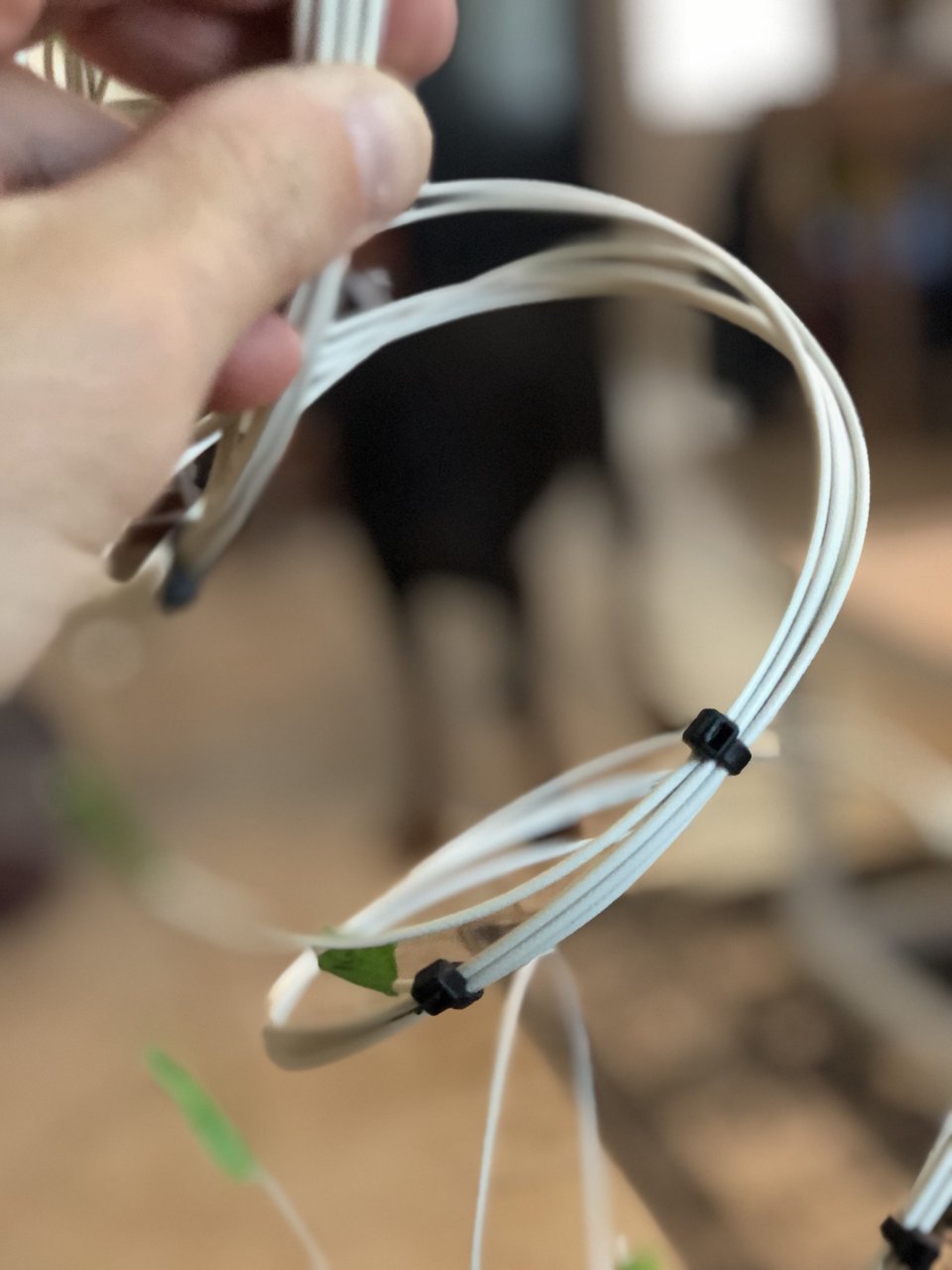

    Few more pics from the weekend.
    Painted the frame, primer, black and texture.
    Wiring harness for the 3rd brake light, rear floods, interior lights and (future fan)
    Also purchased all the HDPE starboard today. I hope to have this assembeled by end of next weekend. (IG story pics) @kirill.evdok3749C402-0AC0-4139-8431-37B93E359DCE.jpg7C53669F-DFD5-4987-9071-7BC0A3F053C1.jpg 37331AC3-247C-4F65-9670-B6D0E596EB20.jpgE6047EB9-1EA3-4910-9CE3-01E07BCBC0D6.jpg 12401EED-345A-4F19-B107-7D98BDB580F0.jpg
