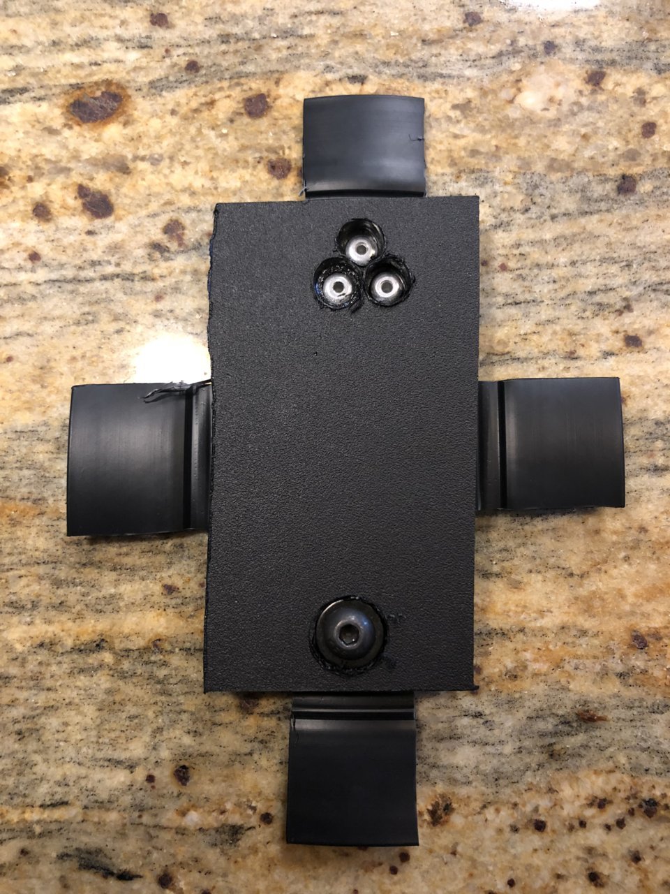

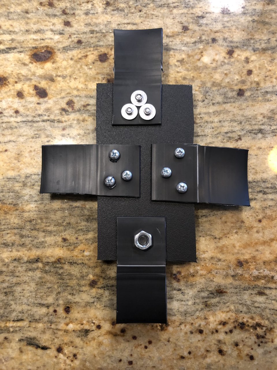

    19C8B24D-A9BF-4DF6-AF48-5E1E7EF24F9D.jpg Today’s project. Poly hinge is mounted to the frame. Unfortunately my original plan of using a high grade epoxy to mount the HDPE to the poly hinge ain’t gonna work. It will hold the plastics together in static form but not taking the abuse of being on the back of the truck. So! I’ve decided to test some options out this morning.
    Option 1: 5/16” nut/bolt combo
    Option 2: 3/16” Blind Rivets w/washers
    Option 3: 3/8” wood screws
    Option 4: 1/2” wood screws
    Wood screw are a bust, I couldn’t even get the drill to break tq on the 1st setting
    The other two options, I am going to test out at work under a load and see which one works better. More pics to come. FE86A7B6-90A5-458F-A002-99CD44176A3F.jpgF2062A43-C1CC-4182-AC0D-382CA9B4A61D.jpg
