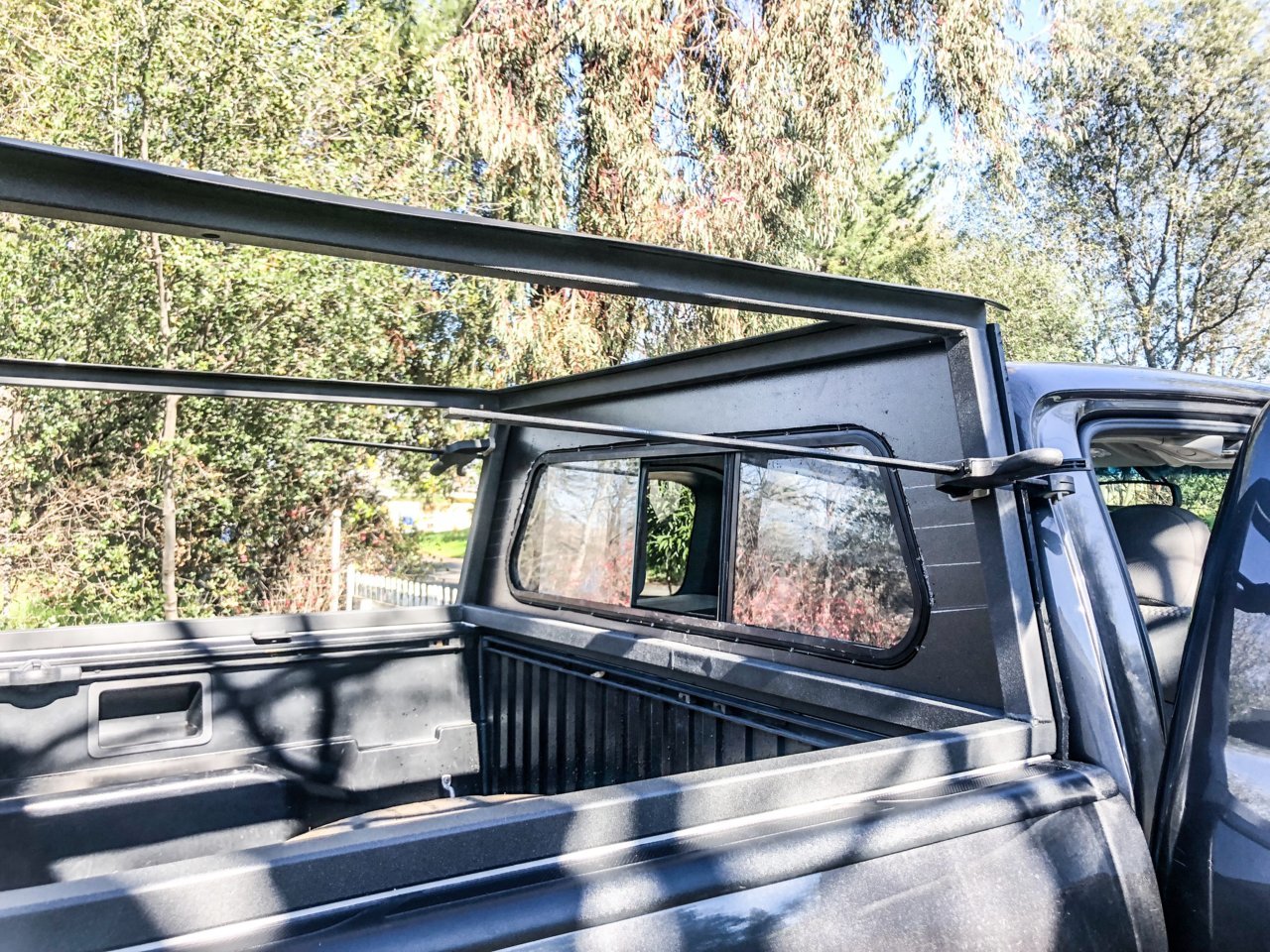

    More from the weekend. 80/20 top going on tomorrow. Along with latches for the rear, and cleaning up the edges, so forth.

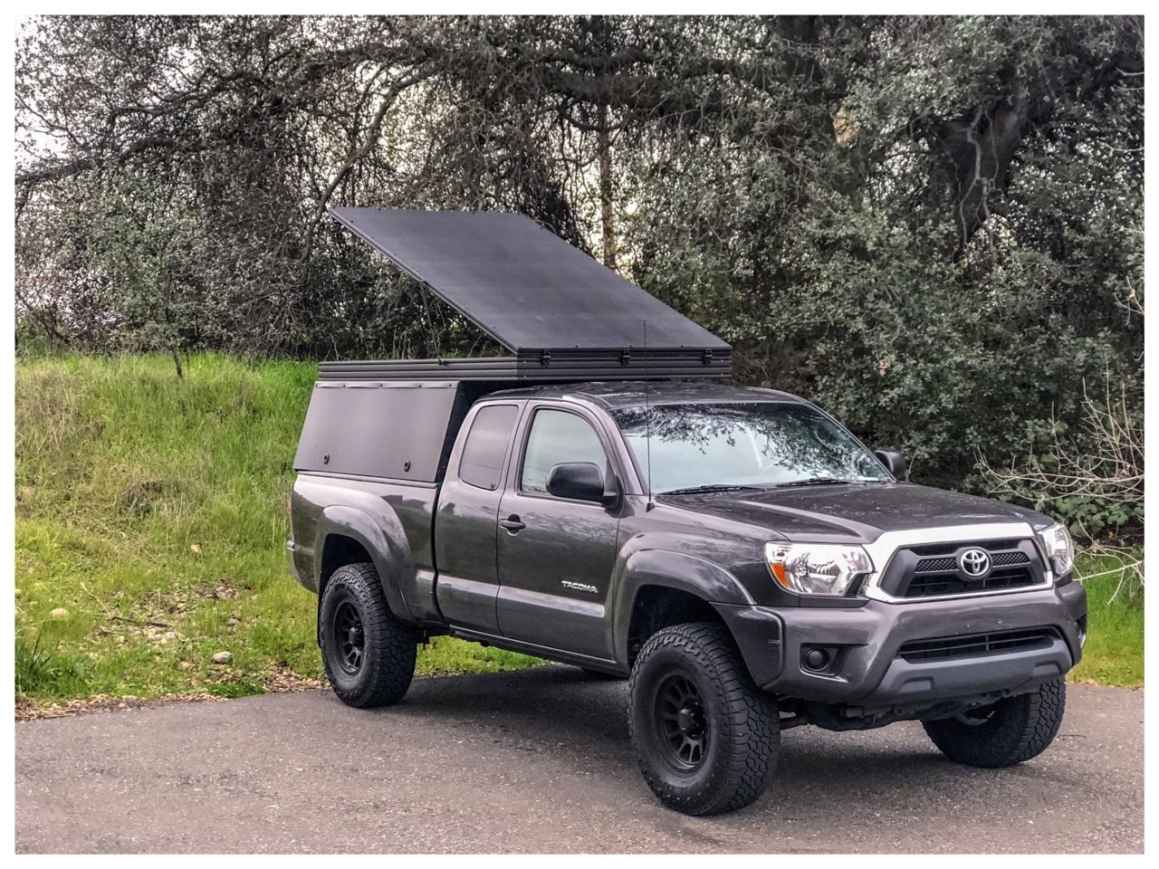

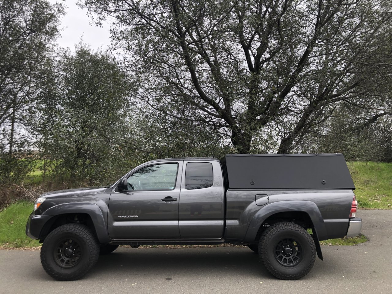

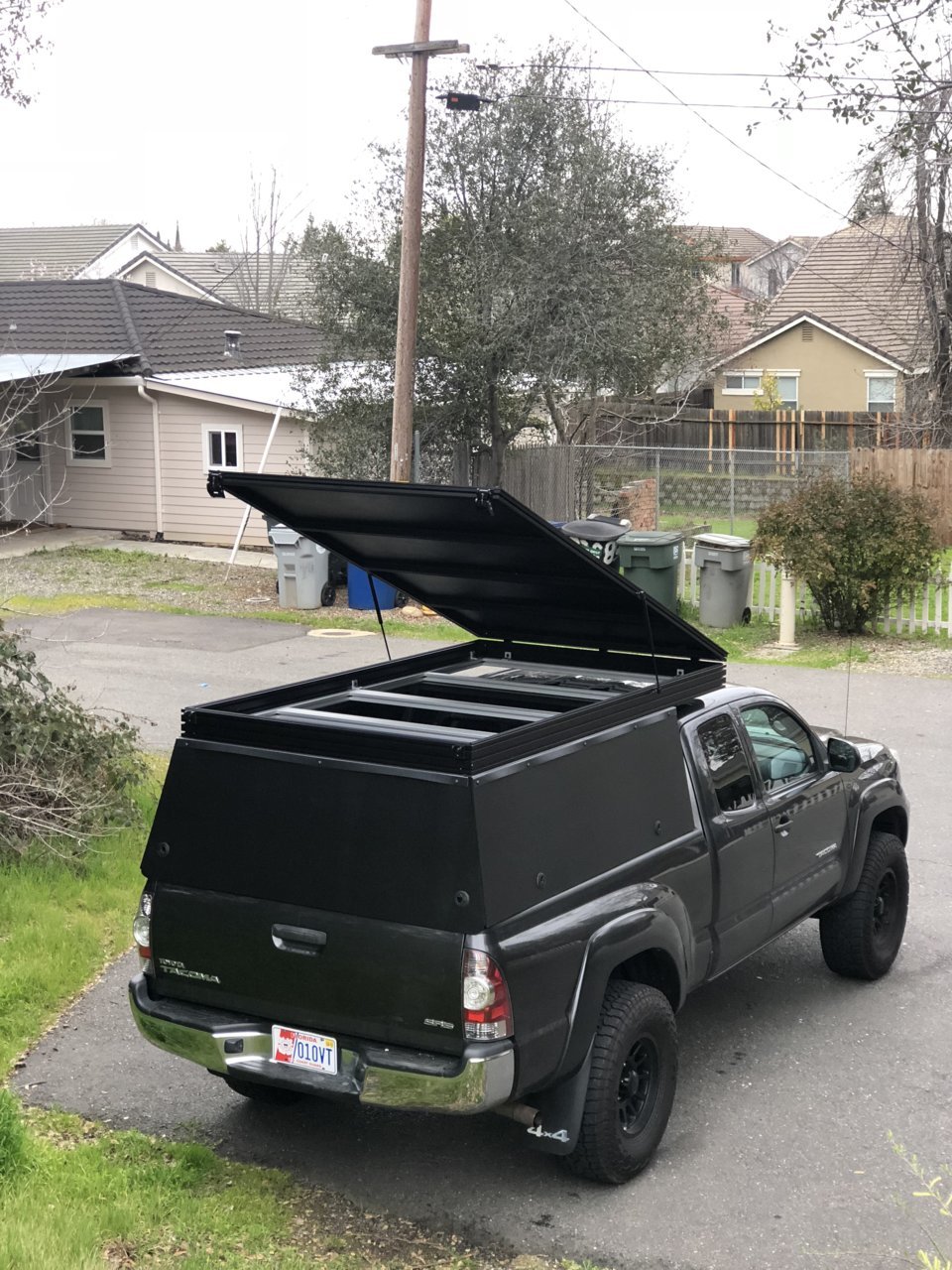

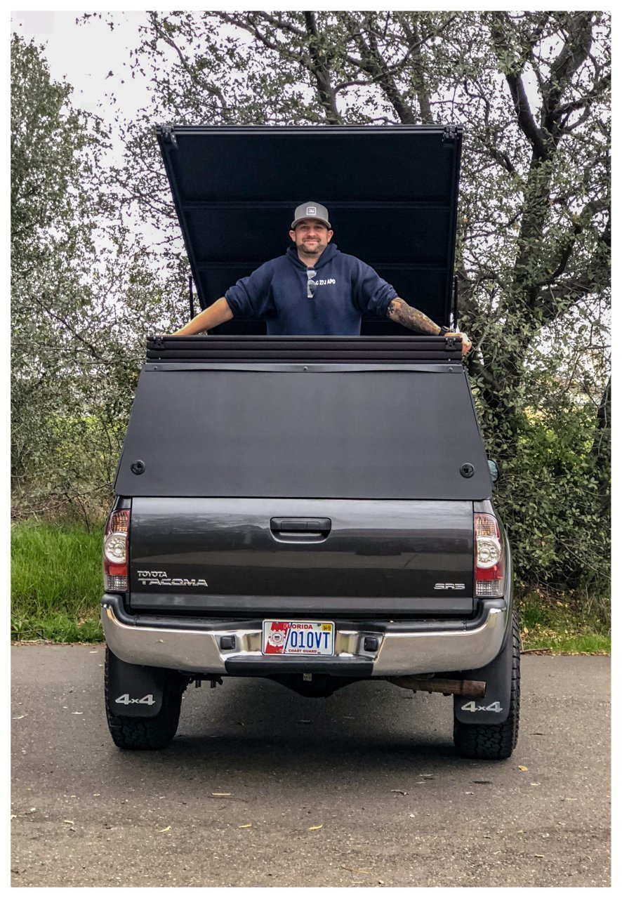

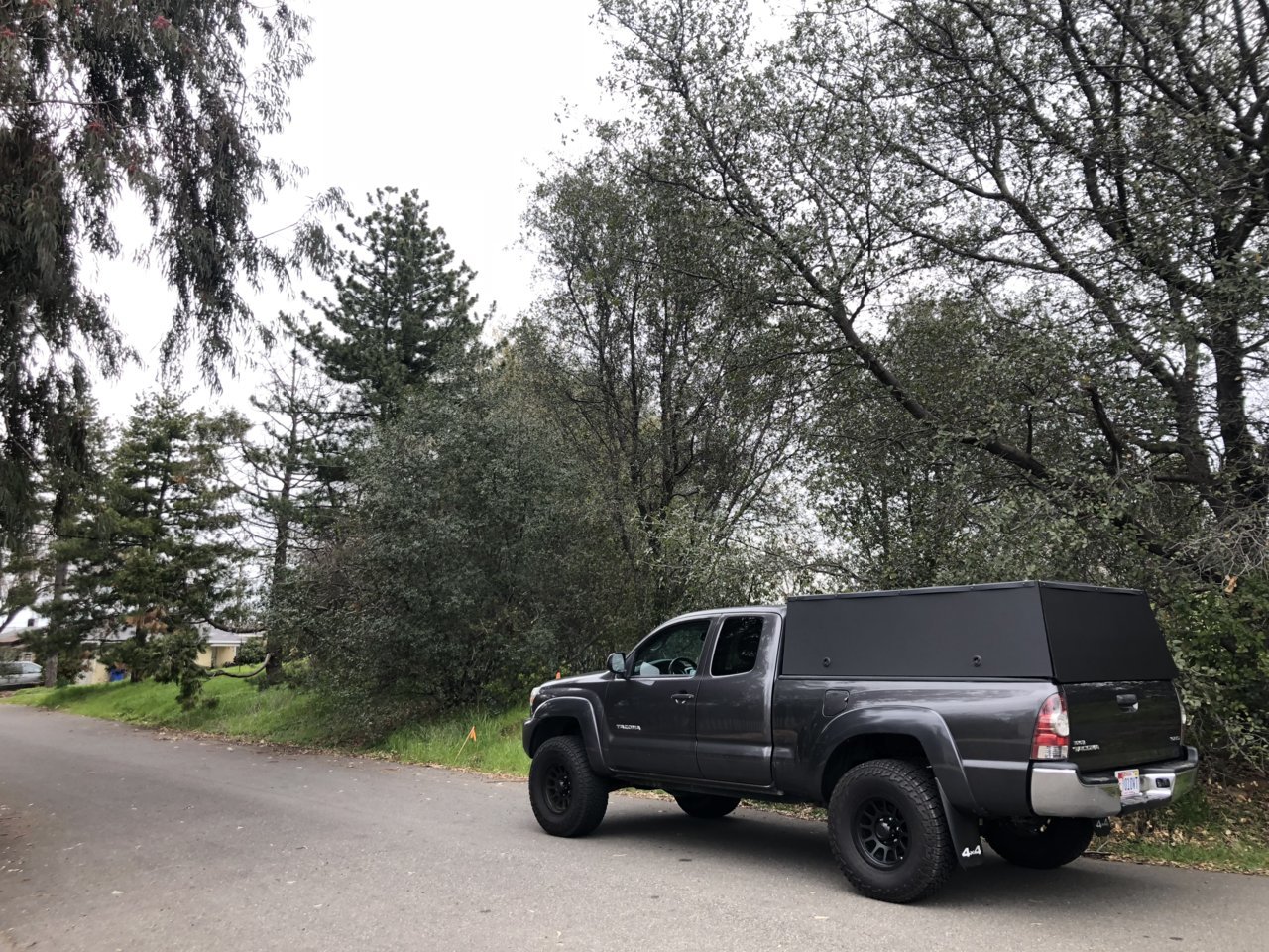

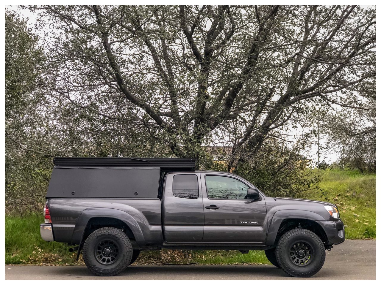

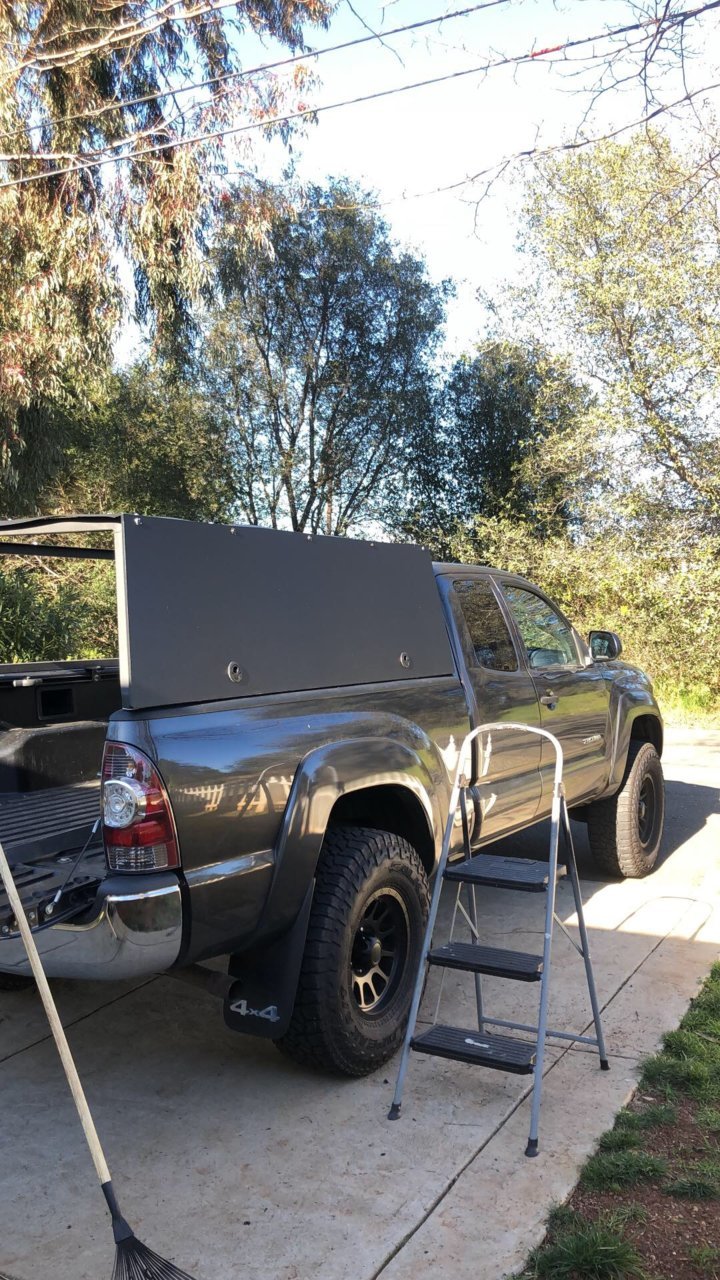

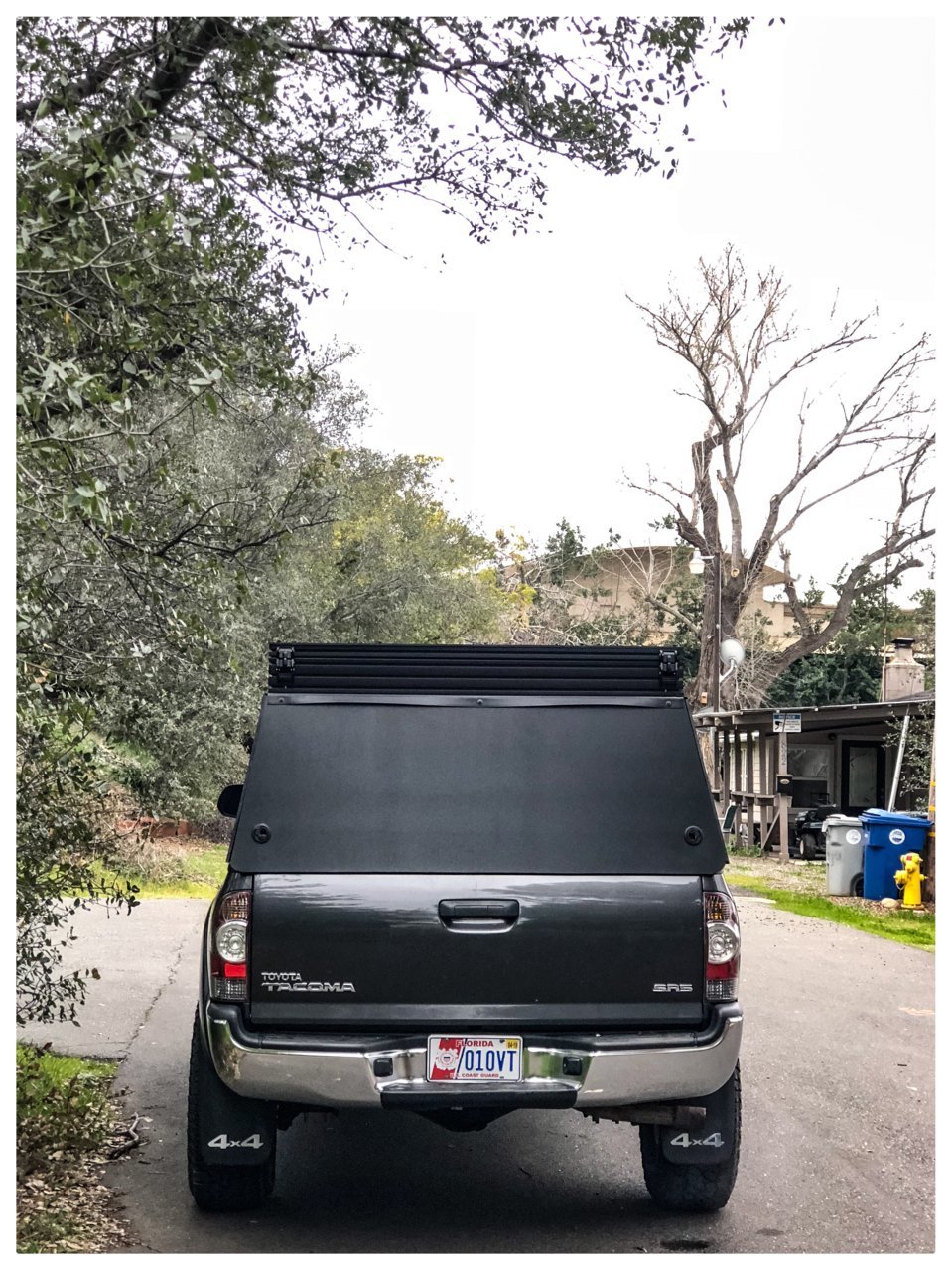

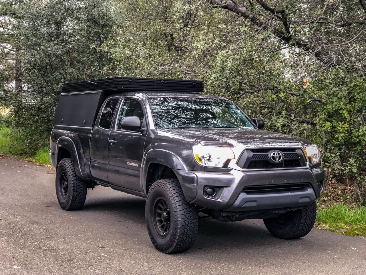

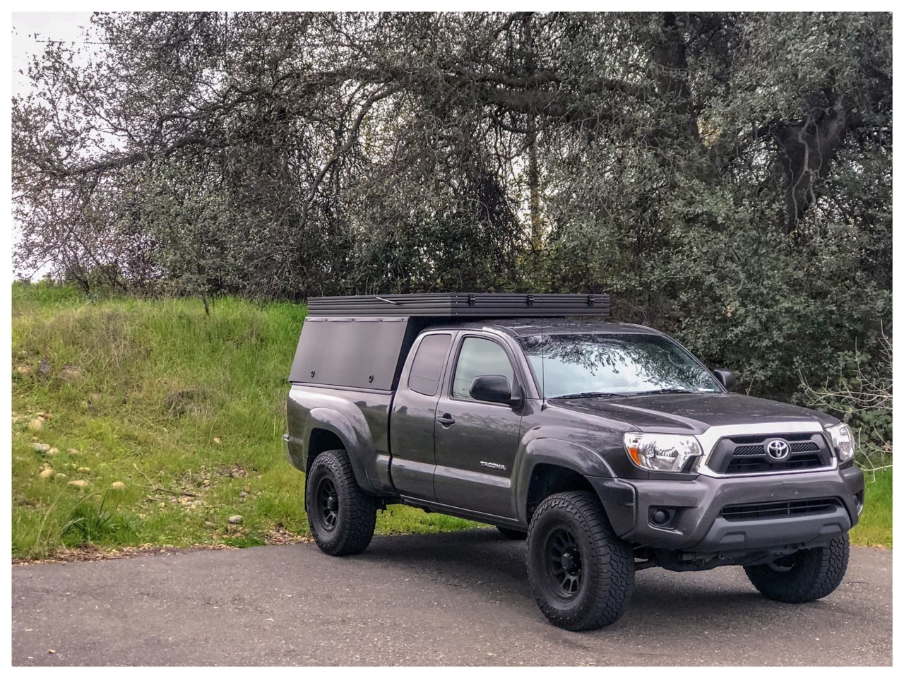

    Well the weekend is over, and the camper is officially on the truck. Need a new leaf pack for sure! AAL don’t do anything lol. Pics included below.

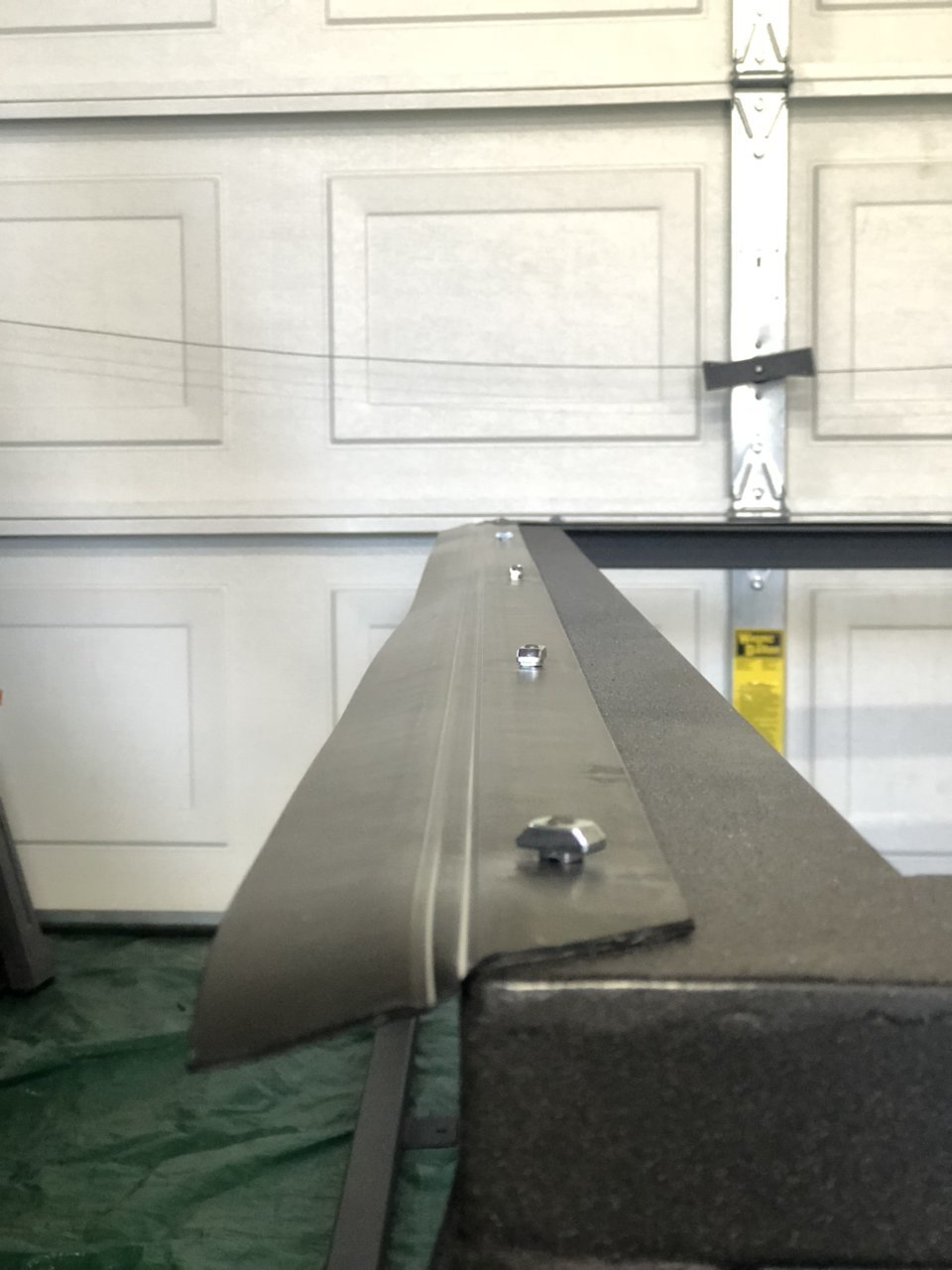

    So I haven’t exactly figured that part out yet, My plan is to use a keder rope that would fit inside the channel on the 80/20 but we will see. I’ve been talking to @Ripcord on IG and he is getting his done by a canvas shop, so I might go that route and have them advise me on some options.
    As far as detailed pics, I’ll take some this week and post up. Pic of the hinge below, the seals are waterproof foam seals that had single side 3M tape on them, I attached them directly to the framing. It’s going to rain all week here, so we will see how well they work lol.
