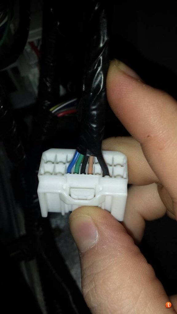

    Comparing the wire colors to yours it *looks* like they could be the same wire.

    I would remove the terminal from the plug itself. Once removed, start the truck to see if the ABS light and TRAC Off light stay lit up. If they do, it worked so snip away and install the switch.
    Taco'09 posted some good tips on how to do remove the terminal just a few posts back. I just used a tiny flathead and some curse words :)

    I have a 2010 trd 4x4 off road and this is the one that worked for me. If your abs ecu has the yellow stripe wire in the right pin on the wire harness I think you should be all set to use this thread. The write up is for a 2005 w/atrac.
    http://www.toyotanation.com/forum/6...31-traction-control-atrac-hack-writeup-2.html
    Check out the thread link above. It worked for my 2010 trd 4x4 and the write up is for a 2005 so you should be covered.
    There are many versions of this mod. If I were to do it again, I would trace the wire from the ABS ECU harness by the master cylinder, back through the driver's side firewall plug and tap into it there. That way your splice is sealed from the weather.
    I took the easy route and spliced it 4 inches from the harness and ran my wires through the firewall plug to my switch. I have not had any issues with corrosion, but at some point I am going to solder the splice and wrap it up tight for extra protection.

    Somehow I missed this post. There are a few guys that wired up switches, even an ATRAC switch to make it legit :D
    Start here:http://www.tacomaworld.com/forum/technical-chat/51946-4low-trac-30.html#post7948733
    There was a guy (slcnbldr) that did (this) ABS Kill on his 2012 TRD Sport 4x4, just check your wiring harness to see if it has the same color wires.:
    I would suggest pulling the harness as pictured in the OP to see what wires you have. If you have a Light Green wire as I did, you should be able to just add a SPST switch.
    If it's Blue w/ a Yellow trace, you might look at CROM's write-up: http://www.tacomaworld.com/forum/2n...kill-switch-mod-05-offroad-easy-way-pics.html
    You may also want to check out btnewman's write-up. He has an '07 Sport w/o VSC:
    http://www.tacomaworld.com/forum/2n...easy-caveman-can-do-abs-disable-mod-pics.html
    Good Luck and post up/PM with any other questions. Worst case scenario: you'd have to re-solder a wire and/or replace a fuse.
