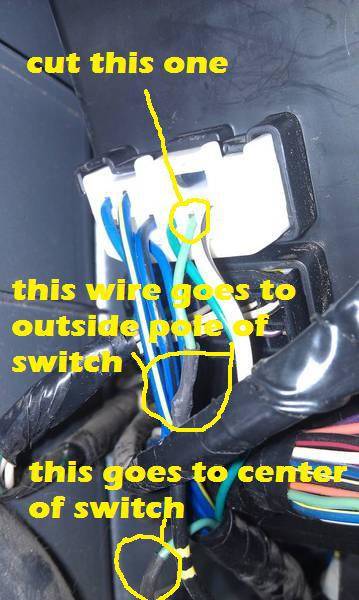

    Well, I can't say for certain, but the caveman mod specifically calls for a grounded 3-pole switch. I would try that...
    "[​IMG]
    and last, ground the last outer pole of the switch."

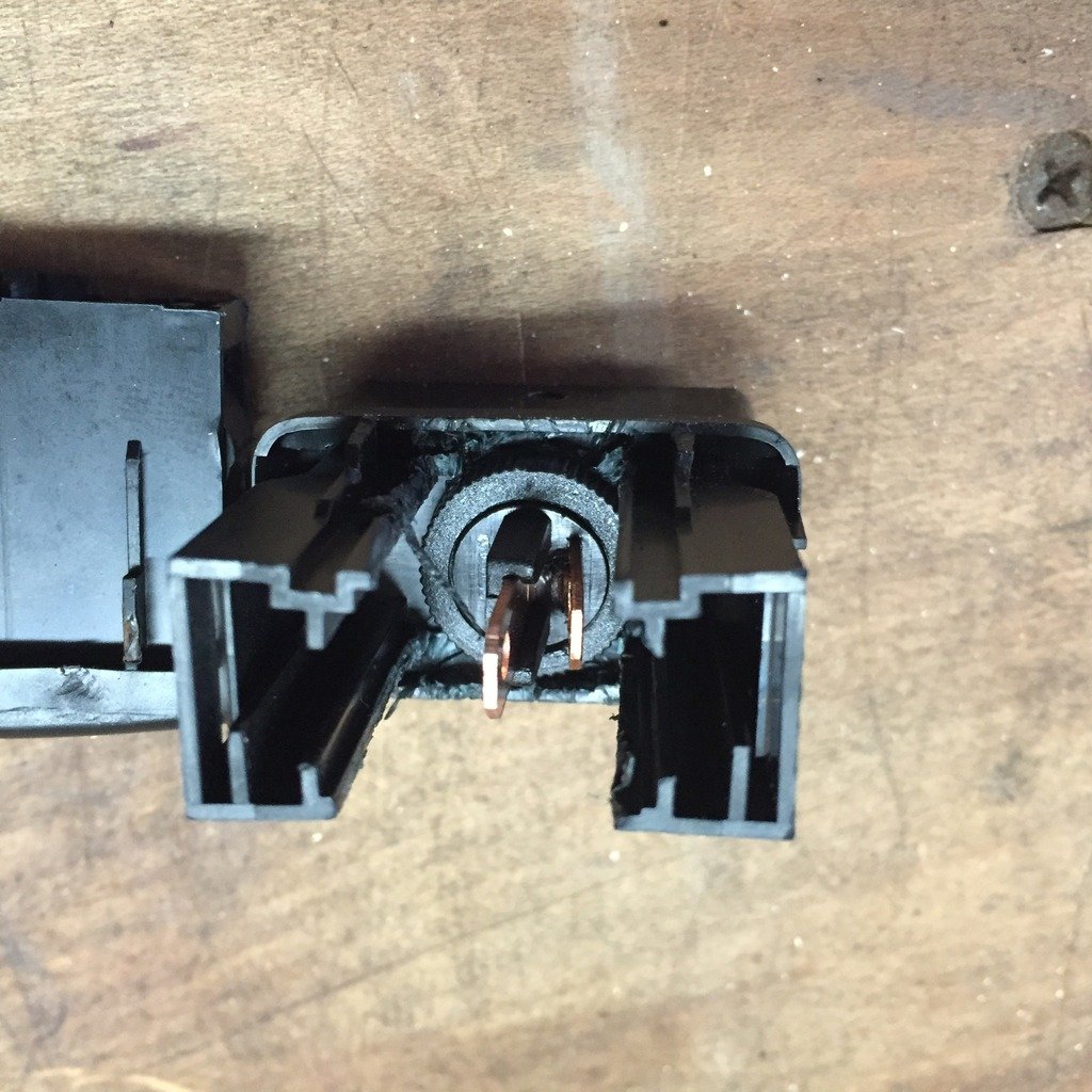

    I went a different route with the switch mounting. I used the blank itself to mount the switch.
    First, I drilled a 1/2" hole in the blank.
    C93B2DE1-D588-4B9E-A0A8-355CA9C07566_zps_5152d22f479624151f1b0c40ffe706189a6ee29e.jpg

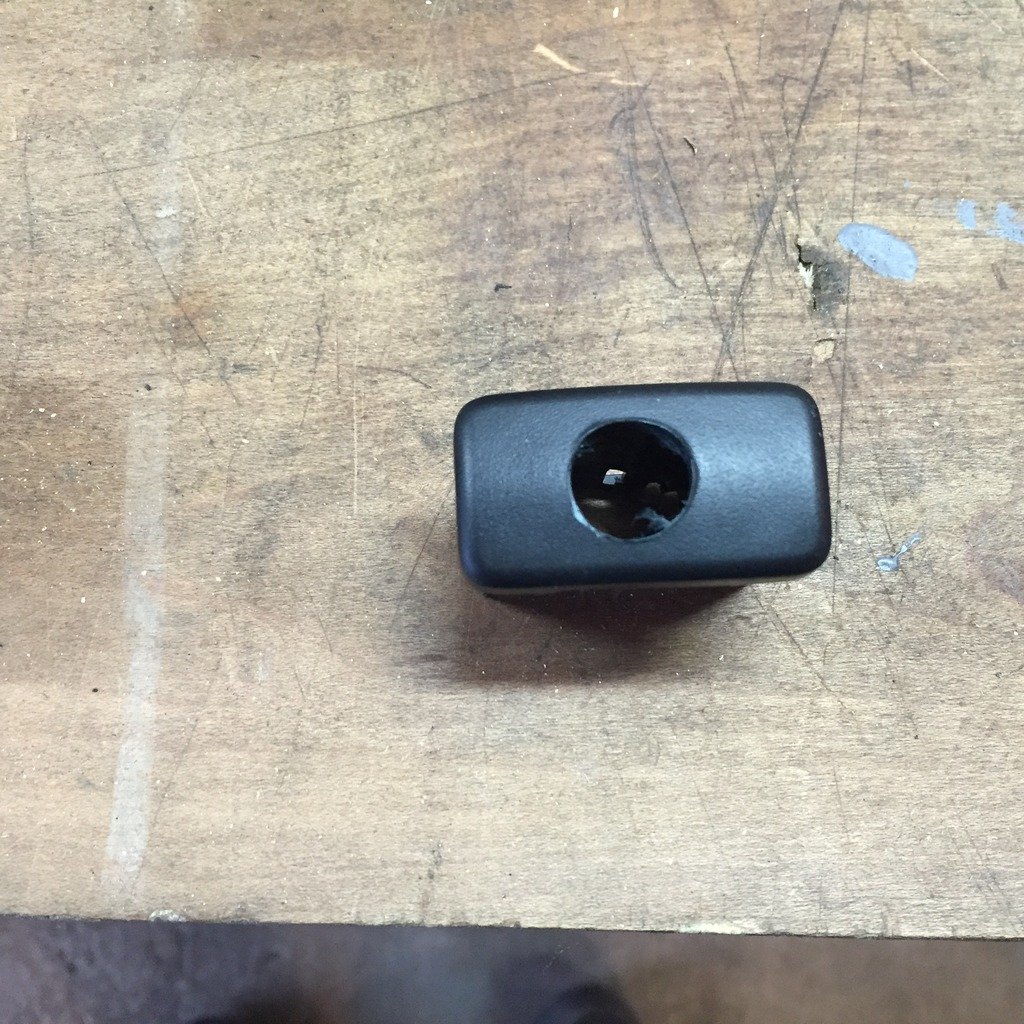

    Then, I put the switch through the hole. I realized that the retaining nut wouldn't fit down inside the blank and thread onto the switch. So, as you can see, I trimmed the sides of the blank out so the nut would fit.
    5B6C84E3-CBC6-4712-A601-9F26333D775C_zps_5f8def1b499f087ad179842bed959ee9649302ba.jpg

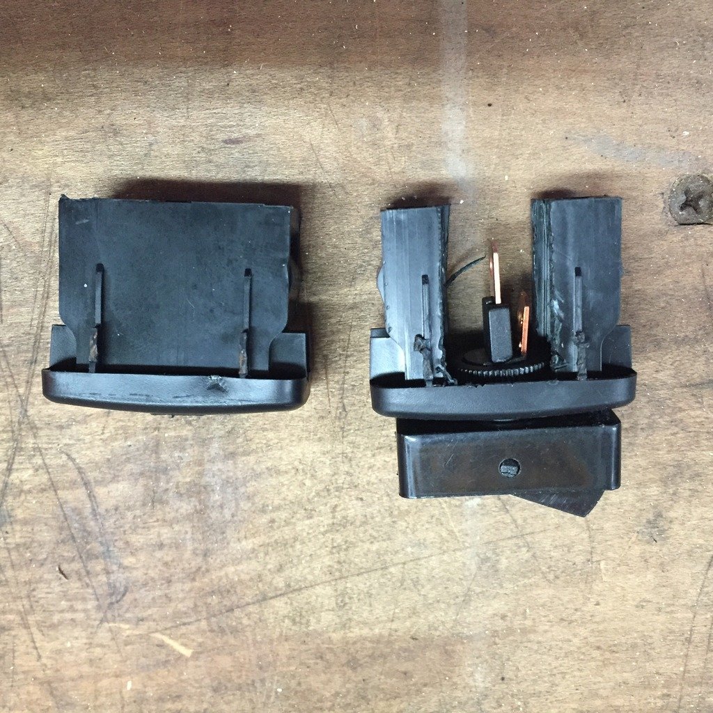

    Rocker installed into the blank. Beside an un-cut blank
    31BF6620-48AD-40BF-BBCD-2CFEE4AD4251_zps_cc9a84b086a5a24d496e4874b9e58edfcee617ba.jpg

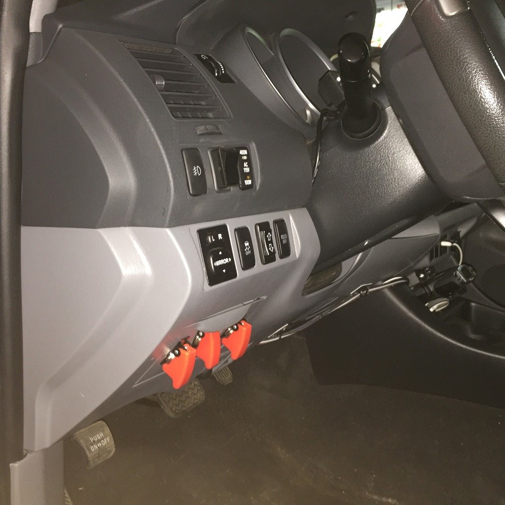

    I put a covered toggle in the blank for the ABS kill tonight. I think the other switch looked boxy and strange. I like this better. Plus, it'll keep the ABS from getting switched off inadvertently.
    I also replaced the red covers in the fuse door with black. Looks a little les Fast and the Furious now IMO.

    for anyone who has done this mod, when you cut the wire did the ABS light come on just with the wire cut? or would it not come on until the wires were connected to a grounded switch?
  12. Jan 13, 2016 at 8:37 AM
    #272
    Drainbung

    well when i cut the wire and checked for the ABS light, it wasnt on and it doesnt come on as a flip the switch
  15. Jan 13, 2016 at 10:45 AM
    #275
    imageomega
    imageomega Well-Known Member
    Oct 18, 2015
    #166998
    327
    Jarrod
    Did anything else occur?
    Sounds like you may have cut the wrong wire. Pictures would help us.
