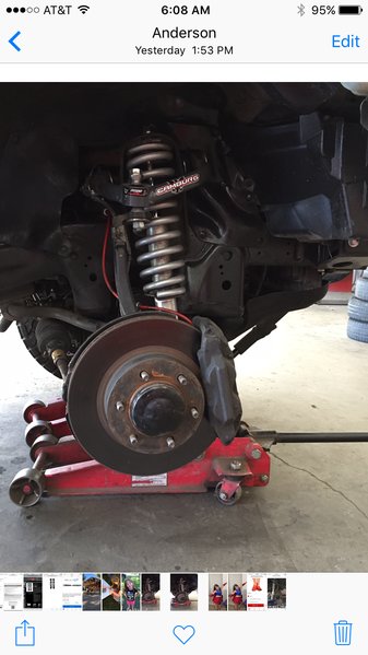

    I just did the tundra brake upgrade which included Toyota OEM rotors, pads and the 231mm 13WL Toyota OEM Calipers. I used wheeler stainless steel braided brake lines and it all fit just fine on my Method double standard 16x8 wheels w/4.5" of BS. No spacers needed. And the stopping power is great!

    I just unscrewed the bolt out of the caliper took it out of the space on the end of the stock brake line and put it through the hole on the end of the wheelers brake line screwed it right back in with a copper washer on both sides of the the brake line that went around the bolt. The hardest part was connecting the other side of the line cause of that retaining clip that holds it on. That thing was b_t_ch to get off since I have 247,000 miles on my Tacoma. Luckily everything else went smoothly since I had an air impact gun. The brake lines were pretty much plug n play. I had to cut the dust shields on each end so the bigger caliper would fit and bend them back so they wouldn't hit the bigger rotor.
