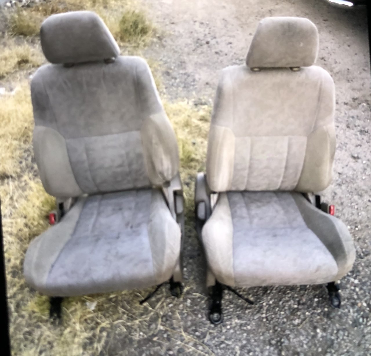

    74718739-48F0-4E18-A89F-A230BCCEE367.jpg I am in for a set. I filled out the form. Just pulled a set of 4runner seats out of an 1999 SR5 4 x 4 yesterday that was in an accident seats are immaculate

    Can it be as simple as swapping out seat tracks/Rails Unbolting the seats and switching the whole mechanism around.

    It’s possible but not as simple as you describe. You need to grind/drill out the end stops to remove the whole rail. This is challenging to do because of the locations of the stops. There’s also a bearing carriage that rides inside the rail and it comes apart when you take it out.
    The seat side of the rail is integrated into the seat and cannot be swapped.

    OK thank you very much for clarifying I appreciate that. Let me know when you have some adapters as I am in for one set. Thank you for making and offering these.
