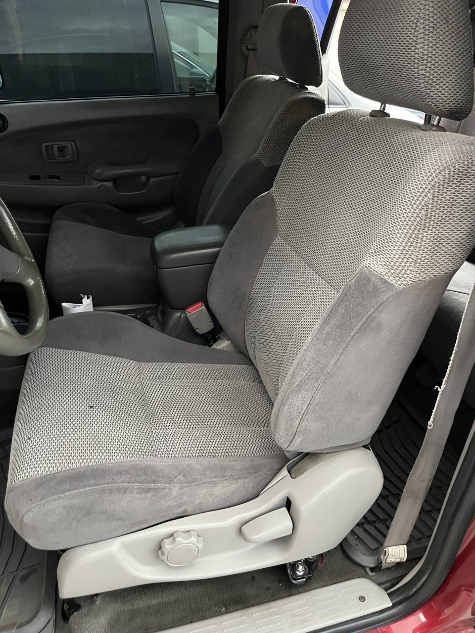

    Alright y'all... need to ask, and I apologize if this has already been covered. Does anyone else feel like their 4runner seats sit... a little tilted or crooked once installed? I feel like the back right mount sits a bit lower than the rest, just enough for me to feel like I'm tilted and the more I think about it, the more I notice it. Anyone else get this or successfully fixed it?

    Just for sake of clarity, can you specify corners of the seat as inside/outside, and front/back?

    Yep, when I’m sitting in the drivers seat, it is the rear, right mount. The one that bolts sideways into the transmission tunnel.

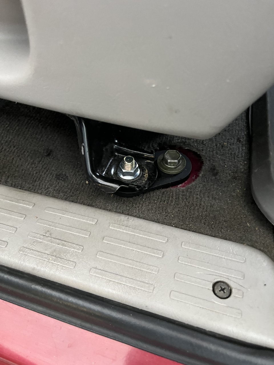

    It’s definitely possible. The outside rear mount will be 1/4” taller because of the bracket and the outside front might be slightly taller from bending it down. I haven’t noticed it on mine, but it could be the same.

    Yes, it will relocate the outside rear mount. The outside front mount needs to be bent downwards once you get the other 3 bolted in.

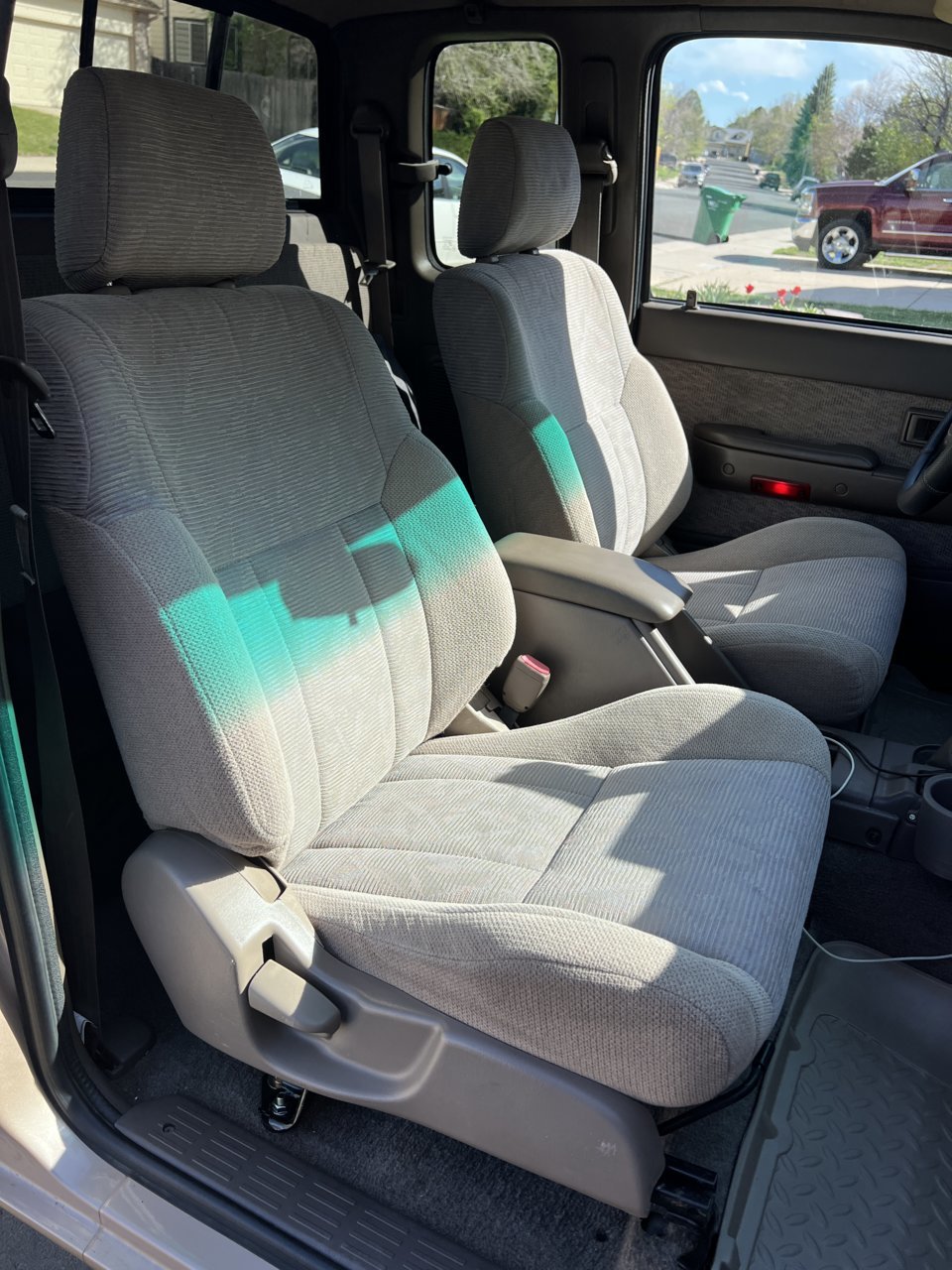

    Thanks! I am not sure which year, I found them on Facebook marketplace. The listing only said 3rd gen 4Runner, 96 - 02, but no idea what year these were specifically pulled from. I’m happy with them! They sit up a bit higher but definitely more comfortable than the stock seats.
