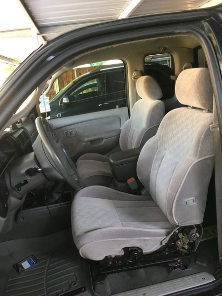

    I just got hold of some nice 4runner seats and came across this great idea for mounting while searching TW. I love how you dont need to drill holes in the body for this solution!
    Question: if you put 1/4" steel under just one foot, doesn't this make the seat sit uneven though? Do you add washers under the other feet or is this just not an issue?! Am I alone that I was out there with a level while trying to mount my seats?! I am trying to get rid of that being crooked in my cab feeling here after all!
    Oh yeah, and I would buy a set if you are making some anytime soon... These beauties are calling out to my spine as we speak (donor: 2002 4runner sport, they call this gray actually but does not match the Tacoma gray same year)!

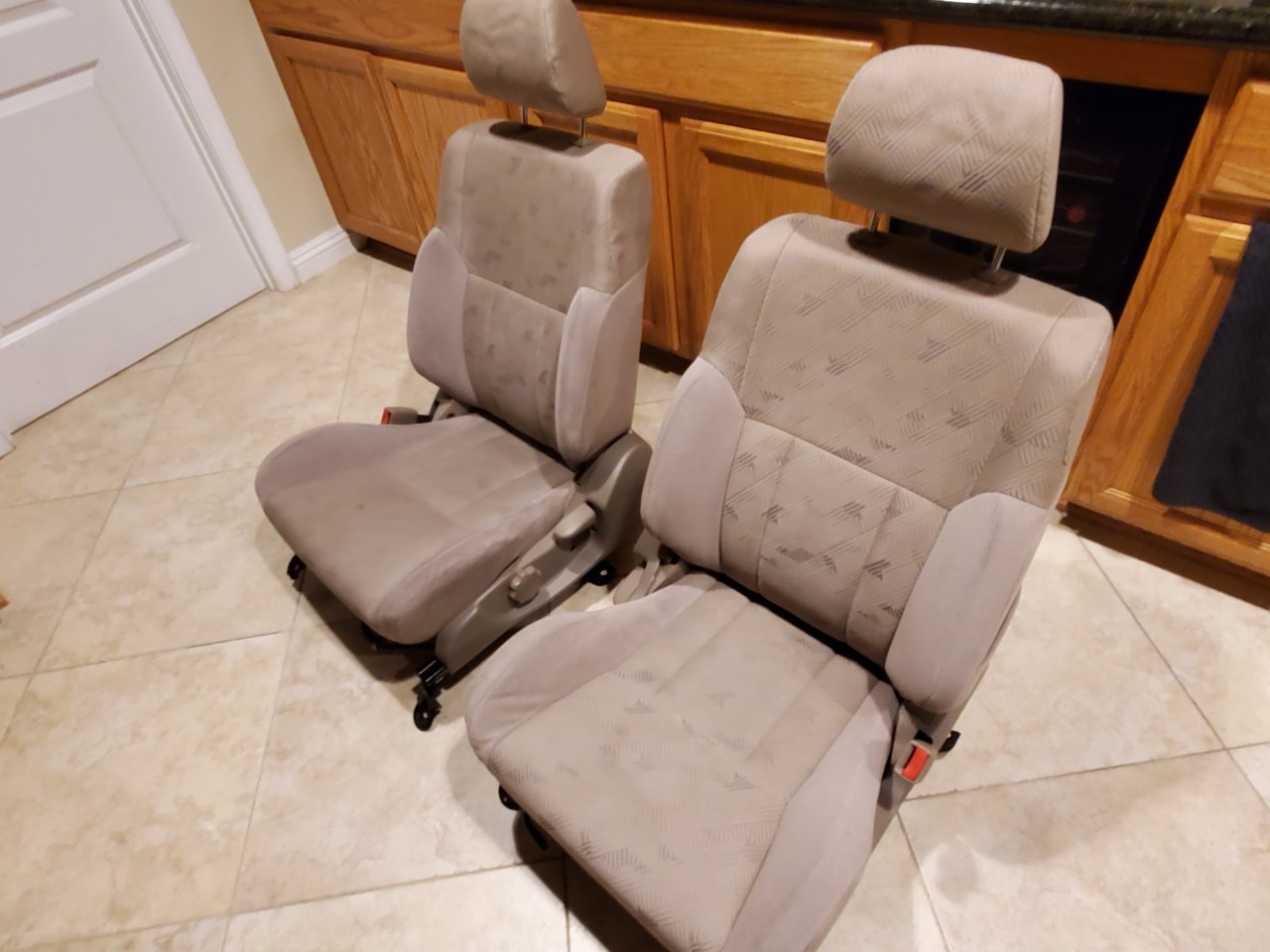

    Another fun fact I recalled, I have seen the 4Runner seats actually in Tacoma's from the factory. I believe they were optional "sport seats" that you could only get on a 4x4 or Pre-runner. I have only seen two trucks like this ever, but these would bolt in all around and have the proper Tacoma fabrics (which again were very different from the 4Runner these years).. and you all thought it was hard to find 4Runner seats!?!

    Agreed! Take a look at this 2002 4Runner "gray" interior to see what I mean..
    Come on down and wave your cash around if you want these, they feeel sooooo goooooooooood!!!

    I don’t have any measurements to back this up, but I know the stock Tacoma seats mount on a rubber bushing on that particular foot. This adapter is almost exactly the same height as that bushing.
    this of course assumes that the floor pans are the same on 4runners and Tacoma’s. I don’t really think they are.

    Interesting, I wonder if that foot or the floor pan changed in 01.
    When I started to bolt my 4runner seats in, I attached the transmission tunnel bolt first so I could see how far off the outside rear one was. It wasn’t being forced into the floor pan, so the added 1/4” was negligible.
    again, this could be completely different on your truck.
