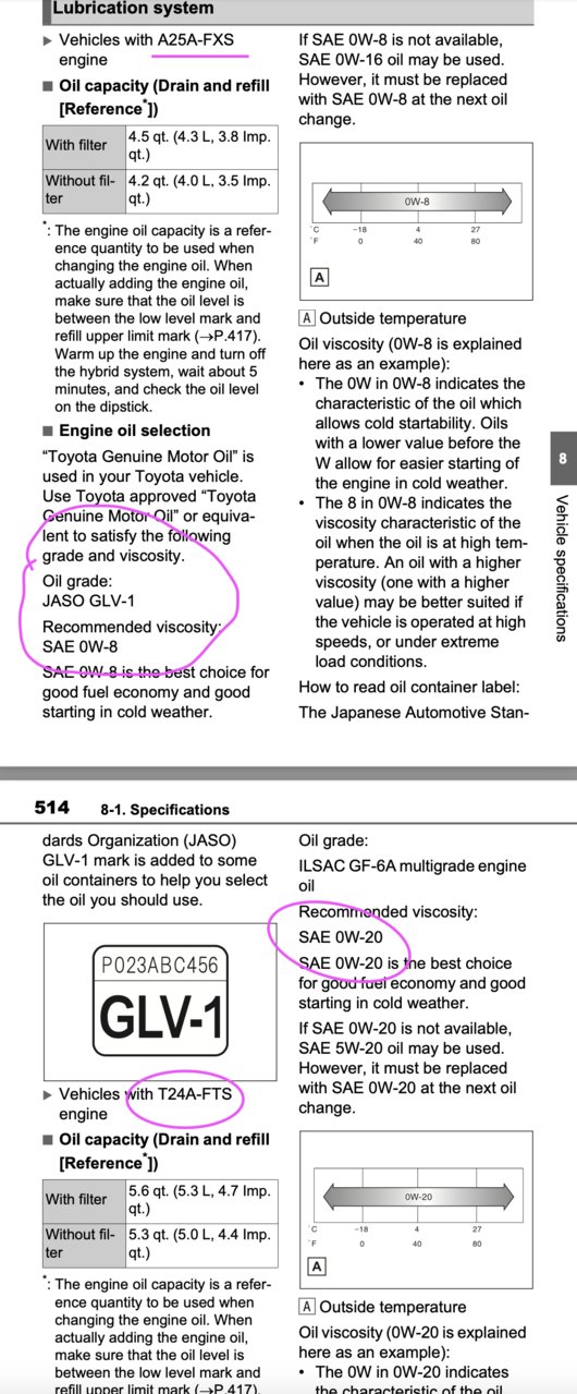

    The turbo hybrid engine in the Crown calls for 0W-20 grade, which I suspect will be what's 4th gen Tacoma going to need and that's unchanged from their 3rd gen recommended oil.
    It's interesting how the non-turbo Crown, with the same A25A-FXS, found in all other Toyota/Lexus line up, such as RAV4, Highlander Hybrid, requires JASO GLV-1 0W-8 oil. I couldn't even find ANY such oil for sale online, not even Toyota dealers have them.

    Not sure how I made that mistake, I've corrected my post.
    Other Toyotas outside of North America are using 0W-8 as well, but it hasn't been implemented on much for us yet. USA dealers should be able to get it (08880-12905), but yeah, it's not common yet.

    0W-8? Can we just go to 0W-0 and be done with it?
