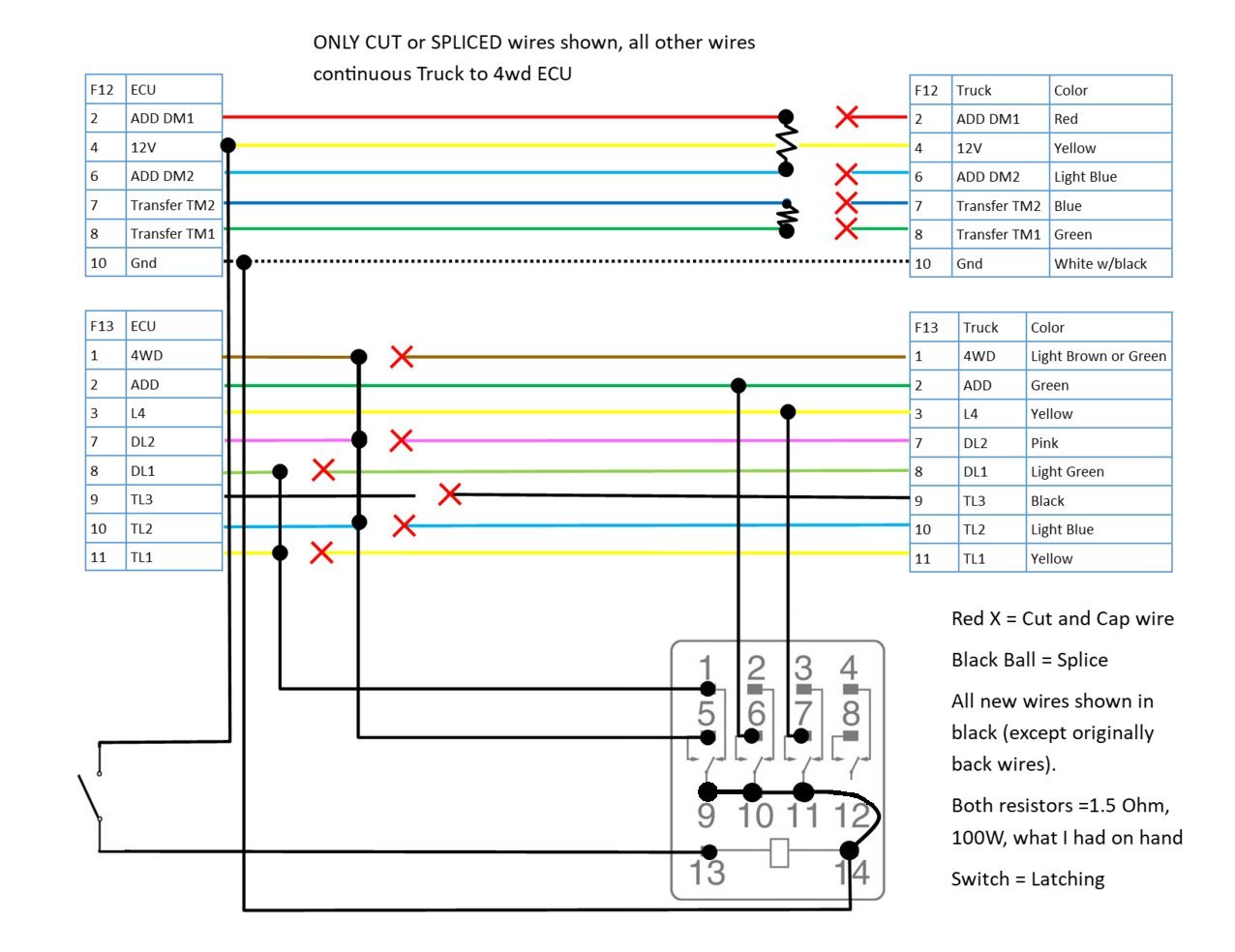

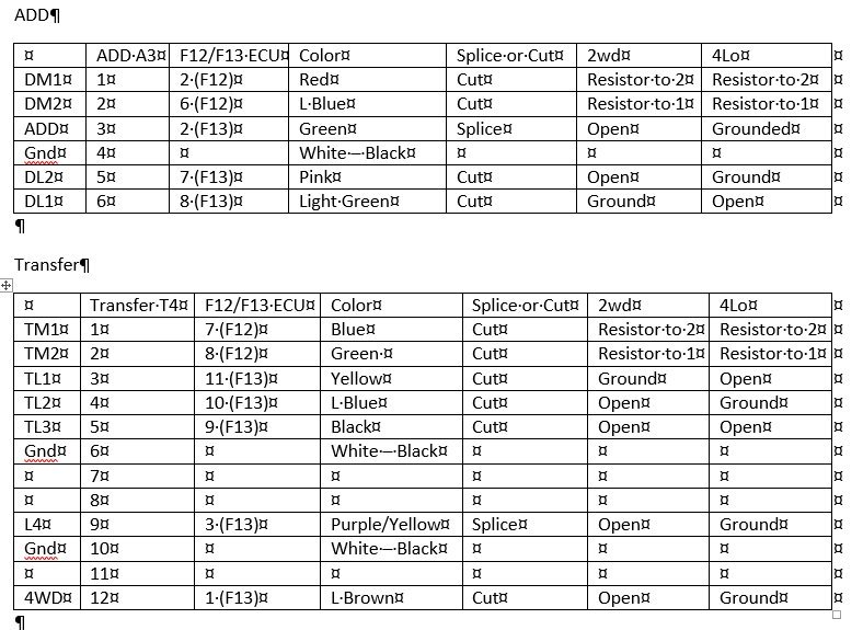

    WARNING:
    I have not tested this in my own truck... All data here is my best guess, as tested on 1 truck (not mine) without me being there in person.
    So you have installed an FJ transfer case in your 3rd gen (originally 4wd truck). Now you have a bunch of warning lights, (and if you have an OR/Pro you lost use of MTS/ATrac/Crawl/Rear Locker)
    Introducing the 4WD ECU Spoofer for FJ... Item not for sale, build your own, come on you already did a giant transfer case mod, you can do this too.
    This is the most electrically simple method for spoofing the ECU AND maintain the 4lo operating modes (for the OR/Pro trucks only) that I have found. A more simplified version could probably work if you didnt want to maintain 4lo modes, but this hasnt been tested.
    However as I made it electrically simple, it also has a HUGE drawback for USAGE.
    You can use your manual FJ transfer case at any time, of course.
    To engage or disengage this spoofer (for 4lo modes), the truck ignition has to be OFF!
    For example, you leave the spoofer switched Off normally. (The resistors and wiring in the spoofer indicate to the 4wd ECU that the ADD and Transfer case actuators are installed and are in 2Hi). You can use your FJ transfer case manual levers as desired.
    To utilize the truck's 4lo goodies. Shut off truck, activate spoofer switch, switch truck to 4lo on rotary dash switch. Start truck. Truck will think it is in 4lo, Rear lock/Atrac/MTS/Crawl will be available. You can use your FJ transfer case as desired.
    This mod has been tested by @Bajataco358 using a harness I built. This mod has also been completed by @bravinci . In both cases, (that I am aware of) the mod was done using the 2lo module as a basis. (https://www.tacomaworld.com/threads...-2wd-low-range-for-the-3rd-gen-tacoma.614743/)
    To reiterate, this is ONLY useful if you swapped your transfer case and locked out your ADD.
    This mod (in this simple form), requires (2) power resistors (1.5-5 ohms), 4pole-double throw relay with 12v coil and a latching switch.
    To build this as plug and play installation, I THINK these connectors should work. But if you swapped the transfer case, why would you care about plug and play...
    https://www.tacomaworld.com/threads...d-gen-development.537810/page-8#post-18502251
    https://www.tacomaworld.com/threads...d-gen-development.537810/page-8#post-18502754
    Proof of concept (reused old anytime lock test harness), Note COLORS DO NOT MATCH
    I will try to answer any questions. But remember:
    I did not test this myself
    The value is primarily for people who did the transfer case swap in a OR/Pro truck
    This is NOT an elegant mod to Use, its a hideous brute force solution that can be made MUCH better by someone who can do microcontrollers (not me).

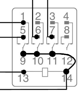

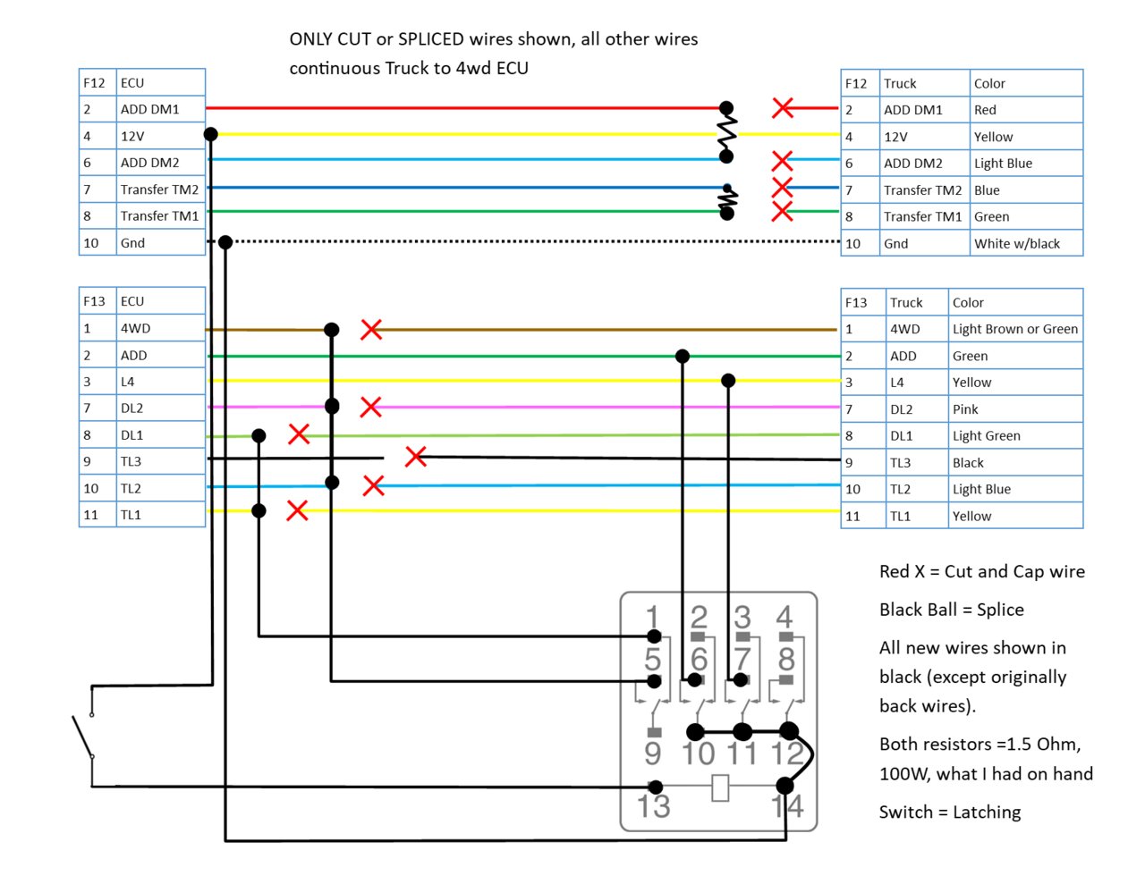

    [EDIT 12-22-2020, I noticed an error in the relay wiring shown in this thread. Relay pins 9, 10, 11 should be grounded.... Pin 12 does not need ground. Will correct in the next few days]

  2. Dec 22, 2020 at 11:37 AM
    bravinci
    bravinci Well-Known Member
    Oct 30, 2017
    #234558
    129
    Brent
    British Columbia
    First Gen 4 door Tacoma
    Nicely done! Do you know what the differences would be in a TRD sport? If I lock my ADD I think everything should work as normal, I would just need to jump the 4wd ECU?
  3. Dec 22, 2020 at 11:41 AM
    BigWhiteTRD
    BigWhiteTRD [OP] Official thread killer (only crickets remain)
    May 24, 2017
    #219848
    1,673
    Ted
    Treasure/Space Coast Florida
    2017 AC TRD OR Auto 4wd, 2012 AC SR5 4.0 MT 4wd
    I am familiar in the wiring of the sport vs OR, and its identical... so I know you could wire the same as this thread.
    But the real question really comes down to functionality.
    The above wiring design allowed the truck to still use the stock rear locker, MTS/ATRAC in 4lo and abs etc in 2hi.... so it needed a 2hi and 4lo spoof, controlled by a switch (for simplicity).
    for the sport, off the top of my head i doubt there is as much advantage in spoofing the 4wd ecu to think it is in 4lo...
    So MAYBE you dont need the relay and just hard-wire the 2hi spoof position.... not 100% sure.
    Does that make sense? What do you think?

  11. Dec 23, 2020 at 7:20 AM
    bravinci
    Oct 30, 2017
    #234558
    129
    Brent
    British Columbia
    Yes, I agree. I think I'll try option 3 then, since I really want the TRAC ON and VSC OFF.
    So I will just need to follow the original diagram posted above for that correct?
  12. Dec 23, 2020 at 7:28 AM
    BigWhiteTRD
    May 24, 2017
    #219848
    1,673
    Ted
    Yep
    [Edit, original post corrected 1-21-21]
    (although i do have a typo i noticed in that schematic, that i need to fix properly at some later time... Ground should hook to pin 9 of the relay also, instead of pin 12 which isnt used at all)
    Think you are going to try a plug-and-play type installation, or just hack into your harness?
