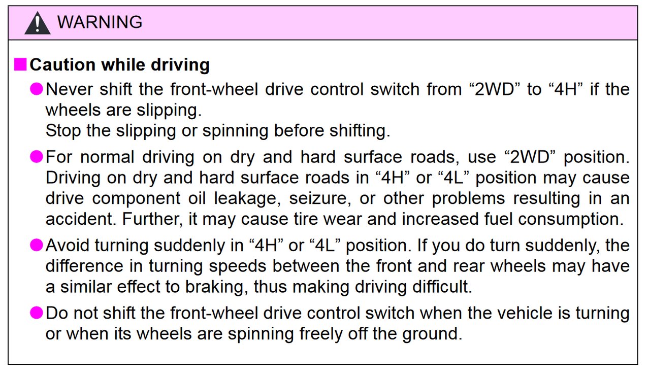

    From pg 247 of the Manual:
    The on thing that I am not clear on and I can't find in the manual is, when the 4WD indicator goes out, does that mean also the the front hubs are disengaged? Previous 4x4's I've owned you always had to drive X ft in the opposite direction to disengage the hubs.
