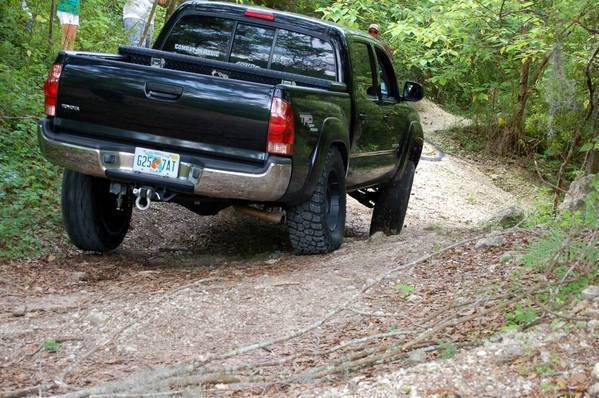

    It's not saying 4wd is useless on uneven terrain. It's saying it has shortcomings with open differentials on uneven ground. To my understanding this picture best represents the limits that the article is trying to express
    two wheels opposite side are firmly planted while the others spin like there's no tomorrow. In this situation a full time(open center diff) vehicle would be in an even worse situation than that.
    Refer to my avatar. I am in no way saying the Tacoma is the wrong truck. I'm not sure where you got that from.:confused:
