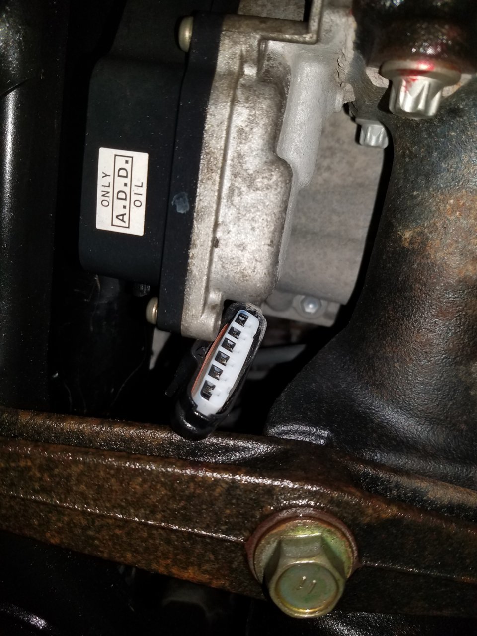

    I climbed under the truck and found a rectangular plug with 5 or 6 spaces in it hanging, is this for the 4wd? It is in middle of truck between rack and pinion and the axel

    Yep, plug that in and your 4wd should work
    It goes on top of that black box. that's your 4wd actuator in the pic
