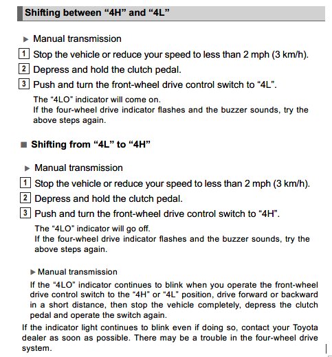

    I just follow the owner's manual:
    shakerhood and tonered like this.
