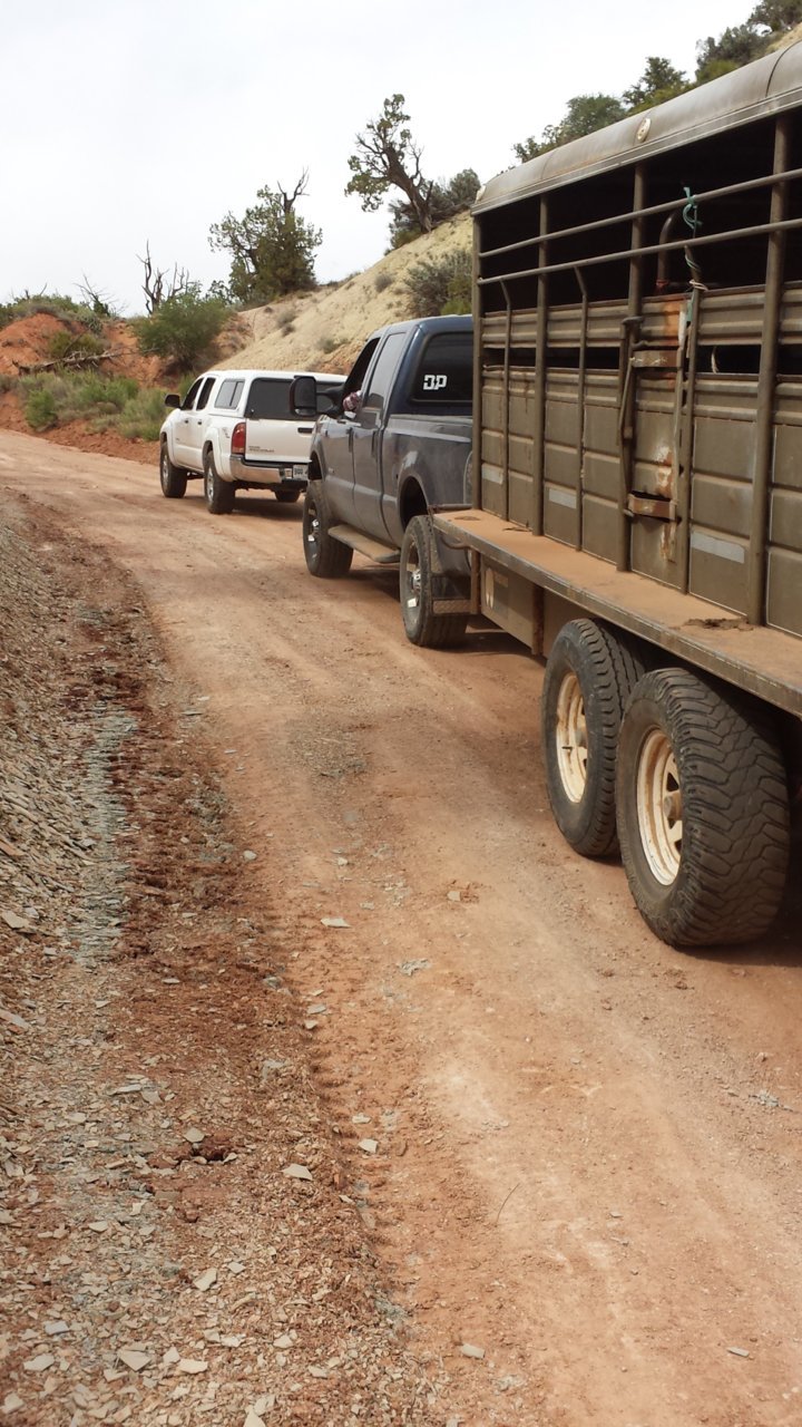

    If you let a 4X4 go unused for an extended period of time the internal parts don't get lubricated and you stand a chance of it not engaging when needed. I had it happen to me ONCE years ago with a Jeep Cherokee that my wife primarily drove. Didn't use 4X4 for about 6 months and it wouldn't engage as we were leaving a Rodeo in the rain. Parking in a pasture with hundreds of trucks leaving in the rain makes a muddy mess. I managed to get out, but would have spun wheels a lot less in 4X4.
    I've seen it happen to others too. I found a couple of Utah cowboys stranded when their F250 4X4 wouldn't engage and they couldn't pull their stock trailer up a gravel hill in the middle of the desert. If I'd not come along they would have had to leave the truck and ride out on horseback and drive the cattle the old fashioned way. I pulled both the truck and trailer to the top of the hill with my Tacoma. The incline is steeper than it appears in the photo.
    I don't get in 10 miles each and every month, but never let more than 2 months go by. And I don't always get in 10 miles. But ANY time I find myself on a dirt/gravel road I engage 4X4 even if it is only for 1/2 mile or so. Some months I may only get in 2-3 miles, some months 200-300 miles. I've not had any problems since.
    And that applies to electronics too. If not used condensation builds up and they fail. Even my winch instructions say to pull out the cable and reel it back in under load once a month for the same reason. You bought it, use it or lose it.
    And as someone who has actually had to have a transfer case rebuilt, twice. It ain't cheap. I STRONGLY advise against operating in 4X4 on pavement. You can get away with it for a while. But it is damaging the transfer case, U-Joints, and drive shafts. You might not break anything today, but you are causing excessive wear that will cause parts breakage later, probably when you need it to work the most. And while gentle curves do LESS, damage than sharp corners sooner or later you'll forget you're in 4X4 on pavement and pull into a parking lot and do a LOT of damage. It simply isn't that hard to find a stretch of gravel, dirt, or grass surface to drive a few miles on occasionally.
