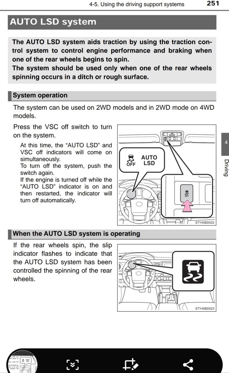

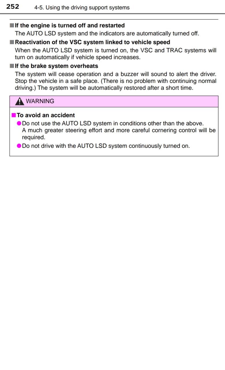

    From the manual, page 251 and 252. On the first page, second section, it states can be used on 2WD models and in 2WD mode on 4WD models. Auto LSD is only available in 2WD regardless of model.
    Junkhead and shakerhood like this.

    Auto-LSD is not called TRAC in 4wd. They are two separate traction control modes. There’s a fair amount of misinformation on the web that labels the various traction control modes as Auto-LSD, but in the owners manual Auto-LSD is one of several modes.

    Honestly that’s the stupidest feature I’ve ever seen on a truck with 4wd. WTF do you need a pseudo rear lsd that only operates in 2wd? I can rationalize conditions where you wouldn’t want it to engage in 4wd but isn’t that what the switch is for?

    I don't think you understand. It also operates in 4hi. So far, this truck has not got stuck and all features work as advertised. Where you need a 2wd low mod is for those that have manuals and want to back up a trailer. Helps immensely to keep from slipping the clutch.

    Same reason you would want LSD in a RWD car - for when you need it. The purpose of LSD isn't to get you unstuck, it's to direct power to a wheel that has traction. This can be used to help you in a situation where you're stuck, but more generically, it's for when one wheel has traction and the other doesn't, so it could be while driving on a wet road hitting a puddle and one tire hydroplaning, or turning around a corner, or hitting a patch of snow.
    Obviously if you're in a situation where traction is going to be continuously challenged you'd want to put it into 4WD, but that isn't practical for normal driving.

    I mis understood, I thought it was only operable in 2wd.

    Also note that Auto-LSD is better than TRAC for getting unstuck. Unlike TRAC, it will not cut the throttle to avoid wheel spin. It also seems like it is more aggressive at minimizing uneven wheel spin than TRAC. In the traction control modes explained thread, I posted some results of some experiments with Auto-LSD. I can't find the post today.
    I don't know why Auto-LSD is not available in 4wd. It's possibly because the ABS vacuum booster is not capable of operating on 4 wheels with the more aggressive braking. That's just a wild guess. The OR and Pro have off-road traction control in 4lo (A-TRAC/MTS), but they have a different brake booster presumably to offer more aggressive and longer lasting braking.
    See the traction modes explained thread for more info.

    Auto-LSD is 2wd only. I think you might be thinking of TRAC. See the traction modes explained thread linked above.
