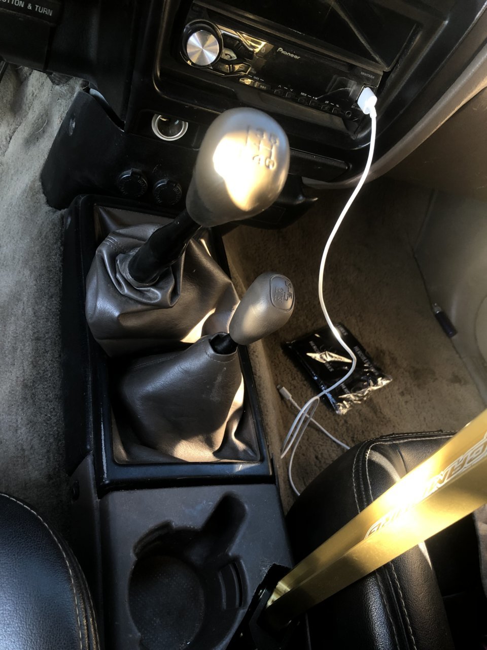

    I have a 2003 5sp 4wd factory supercharged taco. The 4wd doesn’t engage and no lights or icons show on dash.
    I have the J style shifter WITHOUT 4wd button but I’m reading those are mechanical and don’t have actuators, but I DO have an actuator. I got new actuator in mail thinking it would fix 4wd then realized I’m missing hoses leading to current actuator. I’m curious if these are “vent” hoses or are these hoses necessary for the actuator to function. I’m completely new to mechanics so forgive my ignorance. I’ll attach photos of diagram where hose is missing and circled the part where hose is supposed to go, which I have not a goddamn clue what part that is

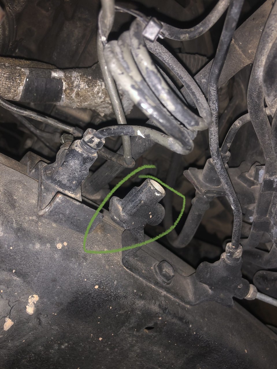

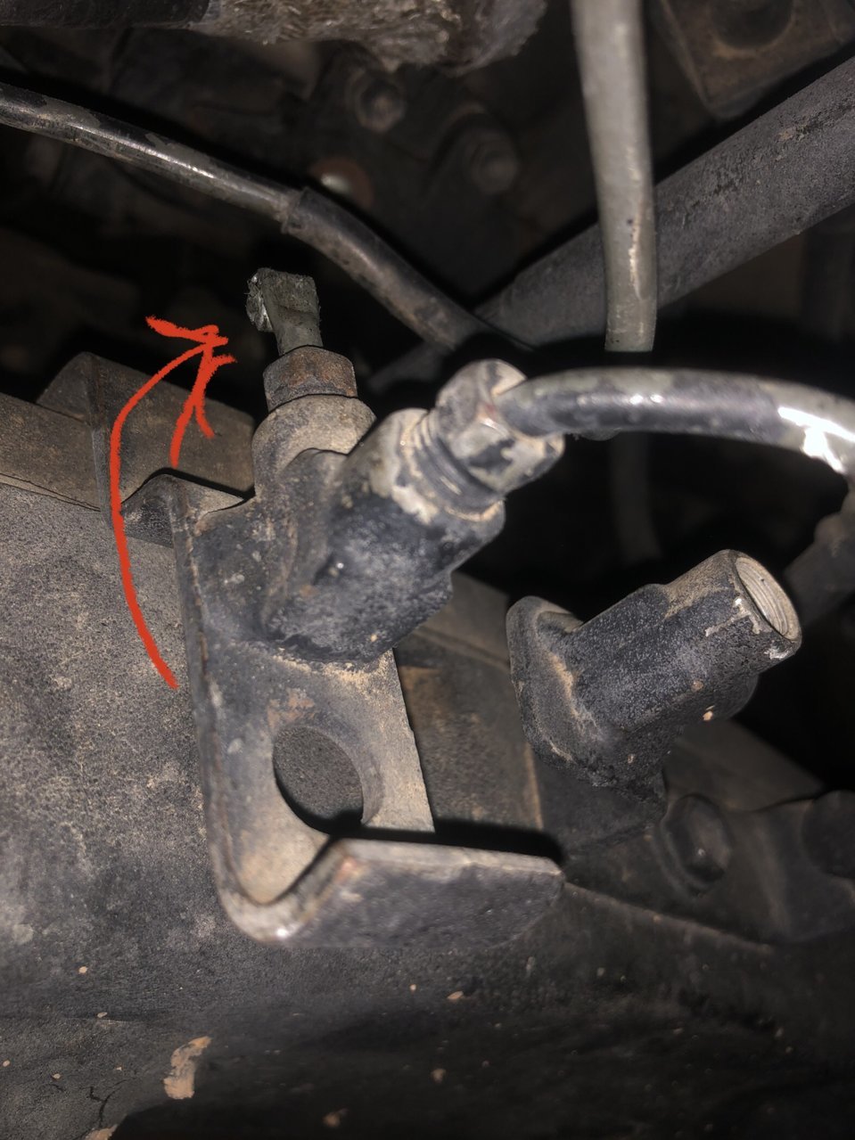

    If I’m not mistake this is the part I’m looking at. This conjoined hard segment of a thick tube and thin tube. Neither have hoses. This is the first hard segment leading away from the actuator. I have no clue where the thin vacuum line is supposed to go from here. Or even if these are vent lines and don’t matter anyways. Both the thick and the thin lines are gone from here

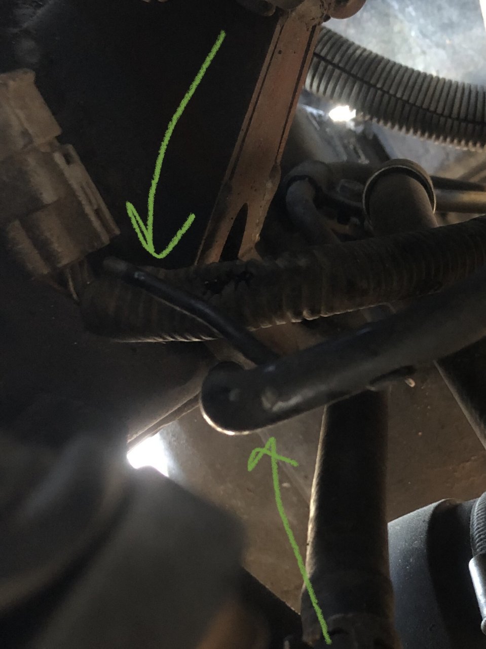

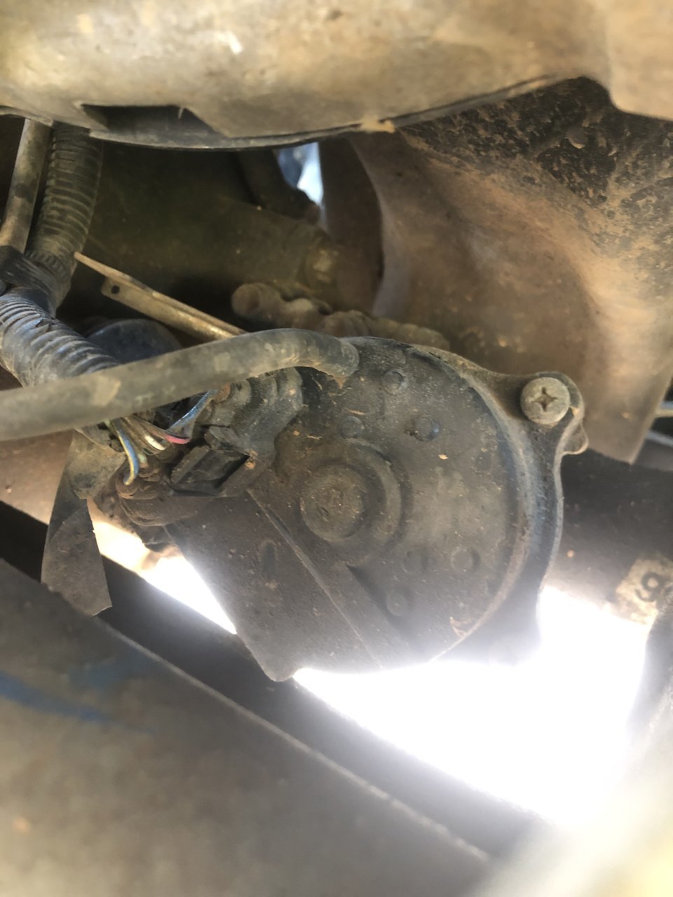

    While on the hunt for the vacuum hose location I found this area where it looks like I’m missing a system from. Also right next to it looks like they cut a hard tube and pinched it/rolled it up to cap it.
    My buddy is thinking the previous owner removed the vacuum system because they wanted it to be super pre runner -_- the eLocker works tho so Atleast 1 vacuum pump is still on here

    That hose on the actuator is just a vent hose, the one in the lower picture that is crimped off is a brake line.
    The later first gen front axles are electronic, weather or not they have the electronic transfer case.

    It's not a vacuum line but it needs to stay connected to keep dirt and moisture out of the actuator.
    The actuator looks similar to the one on 2nd gen trucks but I can't say weather or not it is the same internally or what it takes to remove it.
    2nd gens can be removed without removing anything else but I have no idea if first gens can be or not.

    So you are looking at part of the factory brake tubing. The 90 that is circled is the factory 90 that came from the master cylinder and went to the rear brakes. The 90 to the left is for the front brakes.(I think) The brake line that has the coils in it should go to the front port of the master cylinder. That system has been heavily modified.. Do the brakes feel ok?

    If you get a chance, Take a photo of the brake master cylinder, but angle the camera so that you are looking down from the top of it.

    Yeah the brakes are currently good!! I recently had a camburg hand break which locks up the rear brakes only so i wonder if the installation of that system led to the fuckery of this stock system being cut up and removed !!

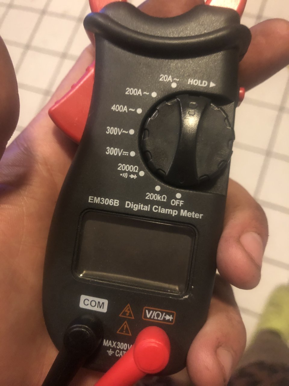

    what setting on this meter should I use while checking the flow of electricity in the harness?? I am oblivious to electric/mechanical engineering currently, BUT IM WORKING ON IT TO GET VERSED

    That would explain it.

    This brake system has definitely been modified, more than once. It looks like a lot of that stuff can just be taken off. It isn’t doing anything anymore.

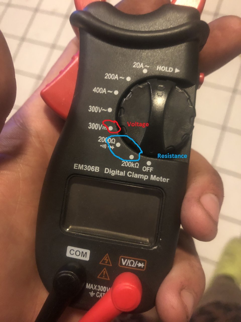

    Red circle for checking voltage/Blue circle for checking resistance/continuity.

    Your dead on point with the actuator. The most likely issue is water in the front actuator. The second gens were known for it, especially if the vent hose was broken.

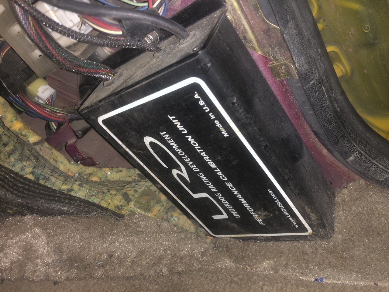

    Inside the actuator plug all the resistances look appropriate! I’ve been looking for the ADD relay behind the glove box box but not finding it. I found the transmission relay behind the kick panel on the passenger side though. I read on one of these forums if you have a truck w/o the 2-4 button, there is no ADD relay and only the transmission relay. hmm I’m not positive if my truck actually has the ADD relay or not , maybe it just has the transmission relay. ‍♀️
    on a positive note though I found an upgrade I didn’t even know I had!! This UDR calibration box

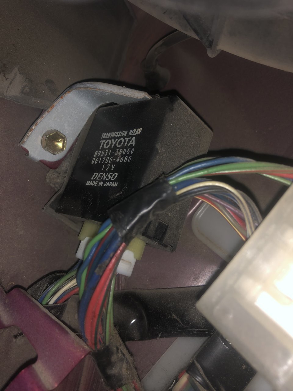

    Here’s the transmission relay box behind the kick panel on passenger side hmm I wonder if this is the only relay associated with ADD or if I do truly have an ADD relay behind the glove box somewhere 0.0
