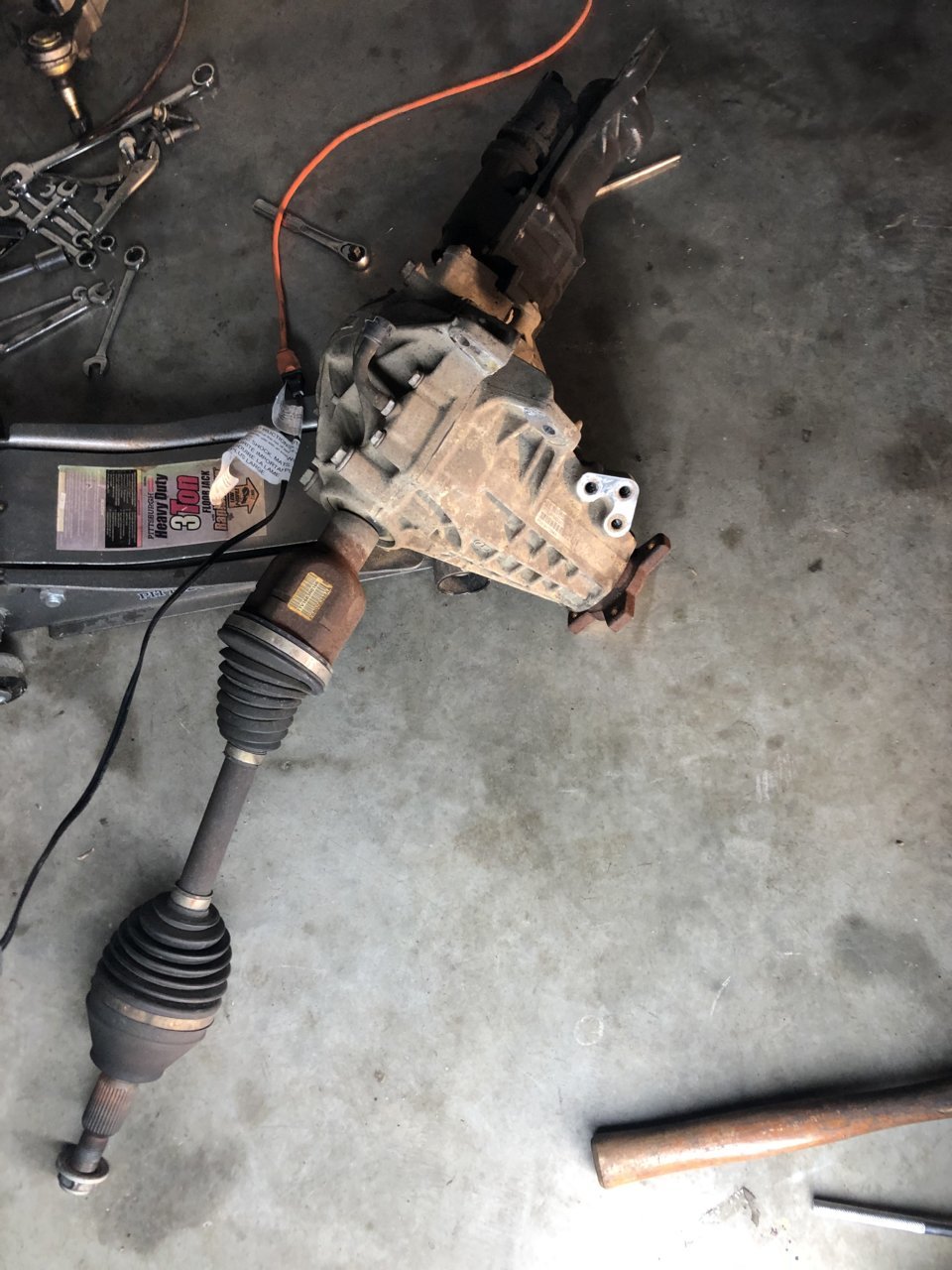

    I have already tried swapping out the 4wd actuator on the front diff. It would work intermittently the first time I drove it, but now it won't engage at all. The actuator makes a sound like it is attempting to engage, but the light continues to blink. I am not sure where to look next other than maybe the transfer case actuator. It would be nice to have four wheel drive, if it ever decides to ever snow in Montana.
    Thanks for your help
