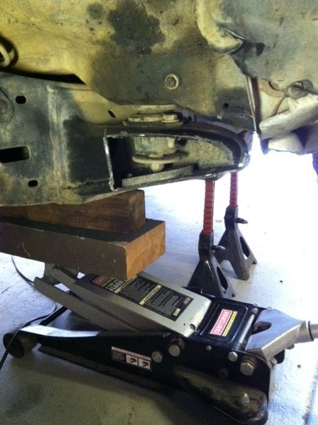

    Outline Cut Area.jpg Outline area to be cut and get ready
    CMC 11.jpg Let Her Rip!
    CMC 14.jpg Wahoo!
    CMC 3.jpg Is it the 4th of July?
    CMC 13.jpg And then.......
    CMC 1.jpg Off it comes
    CMC 2.jpg Fit CMC Plate on and tack into place
    CMC 4.jpg Let the welding begin
    CMC 7.jpg Grind it down nice and smooth
    CMC 8.jpg Sand, Prime, & Paint
