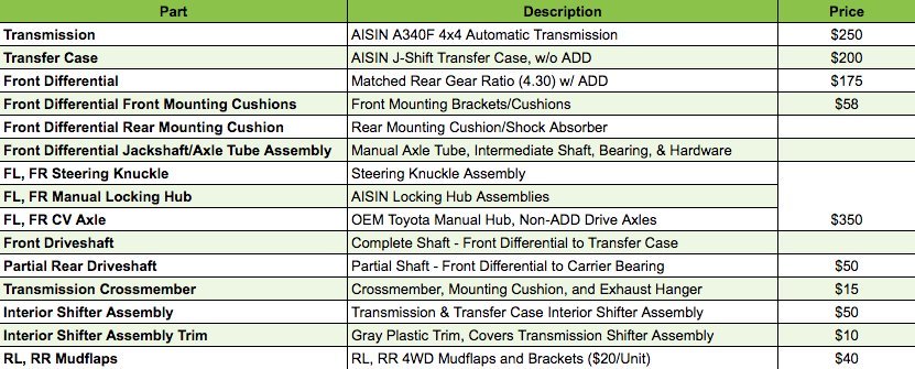

    Here's a complete list for parts assuming you're using Manual Hubs and swapping an ADD differential with a manual jackshaft. The bellhousings between the 4 cyl and 6 cyl are different so you'll have to swap - and the transfer cases are also different. Was your donor truck identical to your truck? (ie: v6, extended cab) because driveshaft lengths will differ.

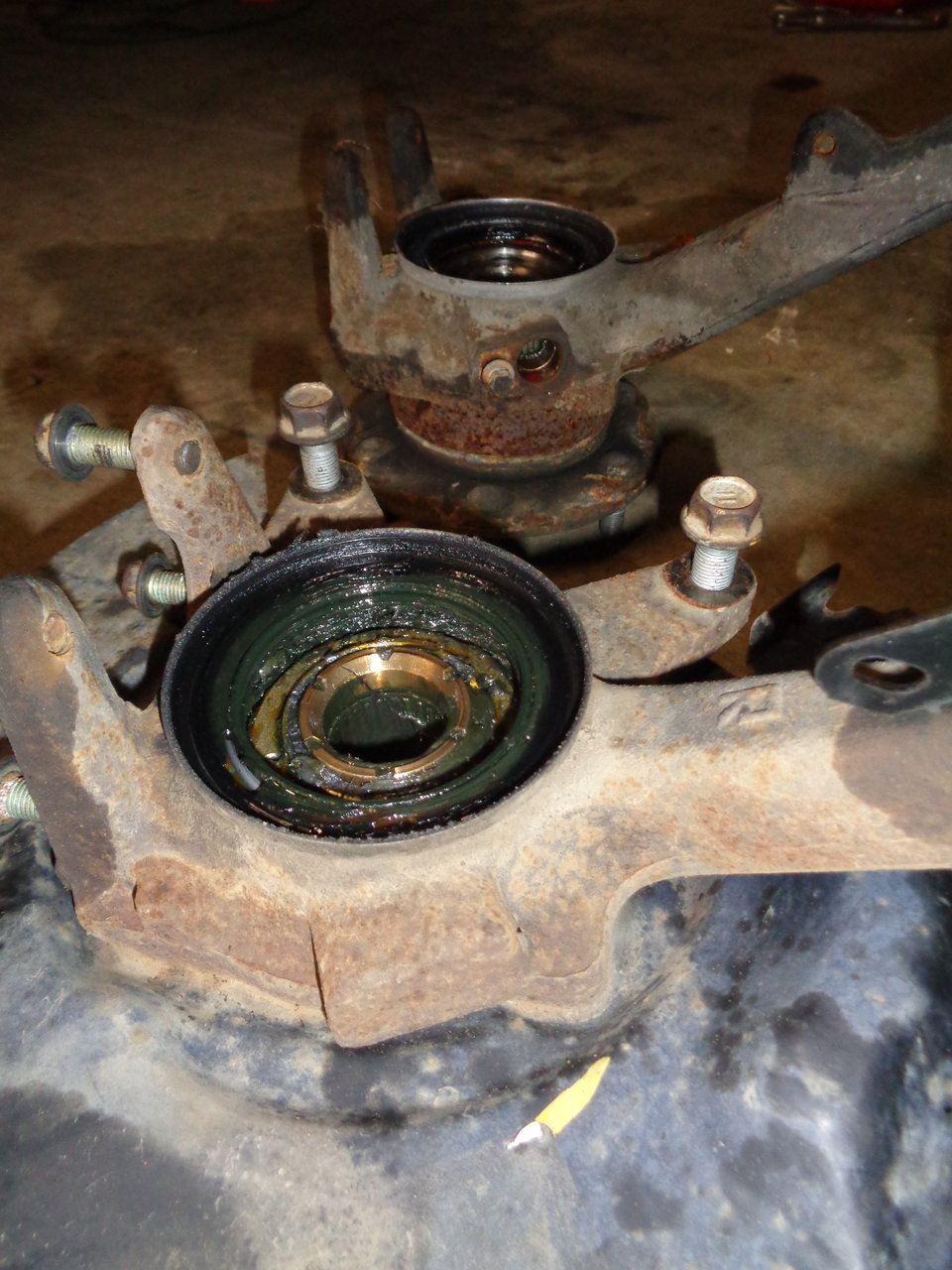

    The manual hubs steer knuckle has no provision for the ABS sensor. Get new wheel bearings ans have the manual hubs installed into your original steer knuckles. The ABS has noting to do with the ADD. The steer knuckle in front is manual locking hub without ABS. notice the spot where the ABS sensor should be located, there is not provision for it.The steer knuckle in the rear is a automatic hub with ABS. Notice the hole with the ABS tone ring.DSC00391.jpg

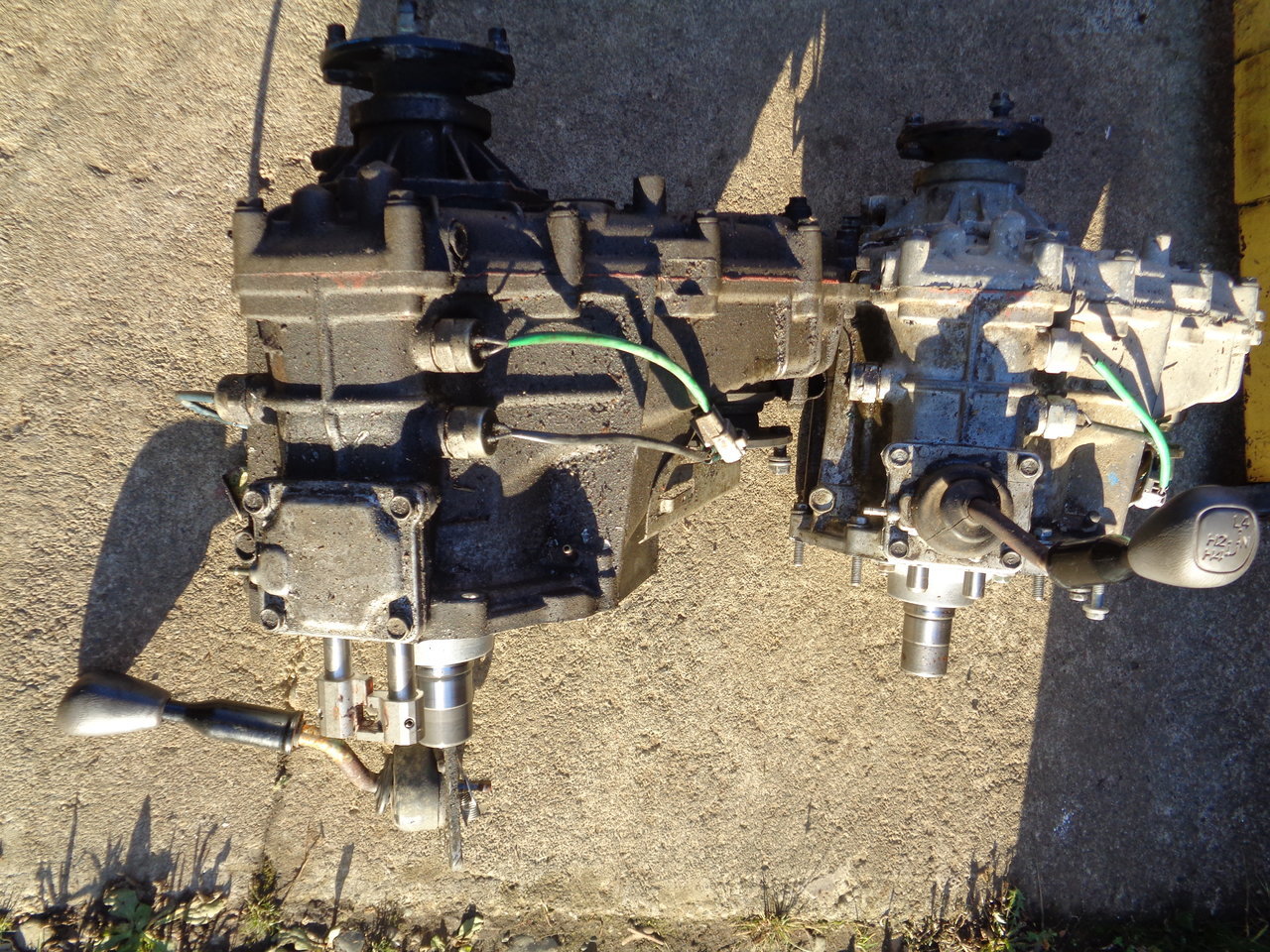

    4cylinder on left v6 on right. since you have a 4 cylinder you do want a forward shift. The A340f is the same in both motors. I used a A340f from a 4cyl for my v6 when I first converted it worked fine. I then rebuilt the donor truck with a v6 to the 4 cyl.
