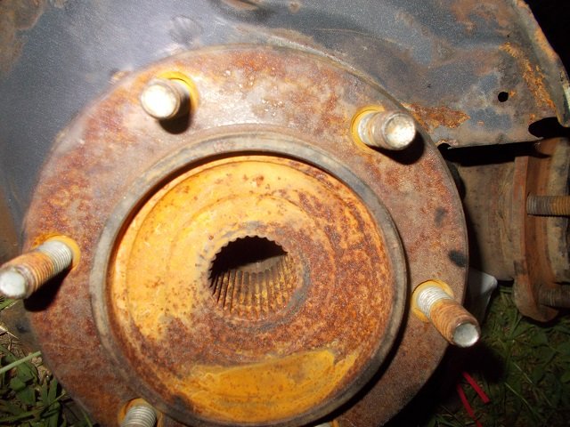

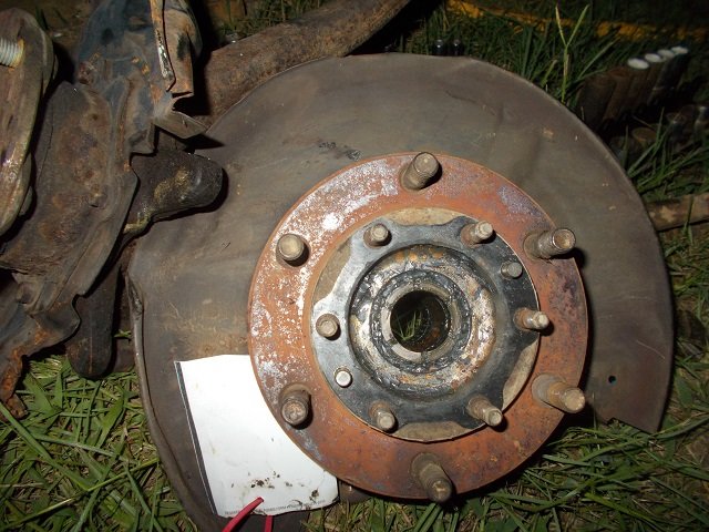

    The rusty one is what was sent to me while the other is mine with a broke off bolt that can't get out yet.DSCN0145.jpg DSCN0143.jpg

    404 manual knuckle not found. Contact paypal and send them both pics.

    That’s an ADD hub. You can’t use it unless you want to press it out and replace it with a manual hub bearing.
