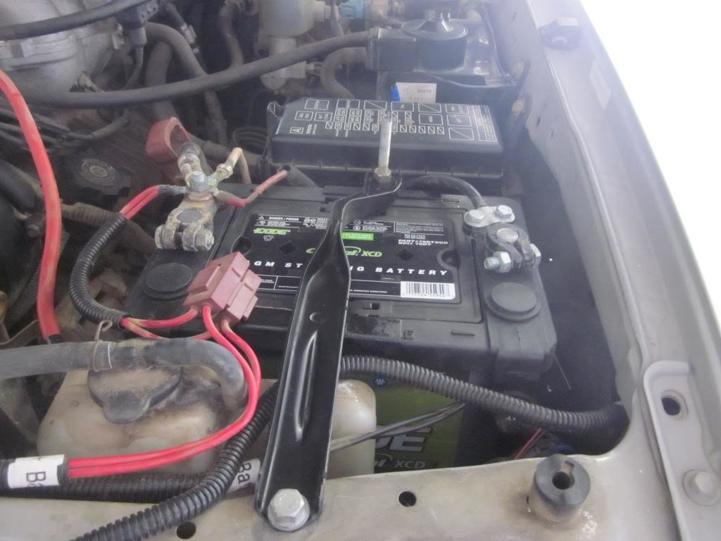

    You need to adam because I now have unneeded ifs hubs. Also where the heck did you get that exide battery? Work?

    Yes sir, ole Carquest came through for me :cool:

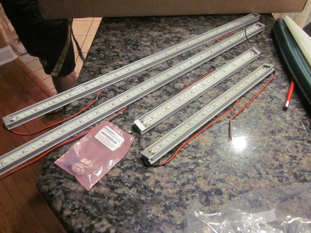

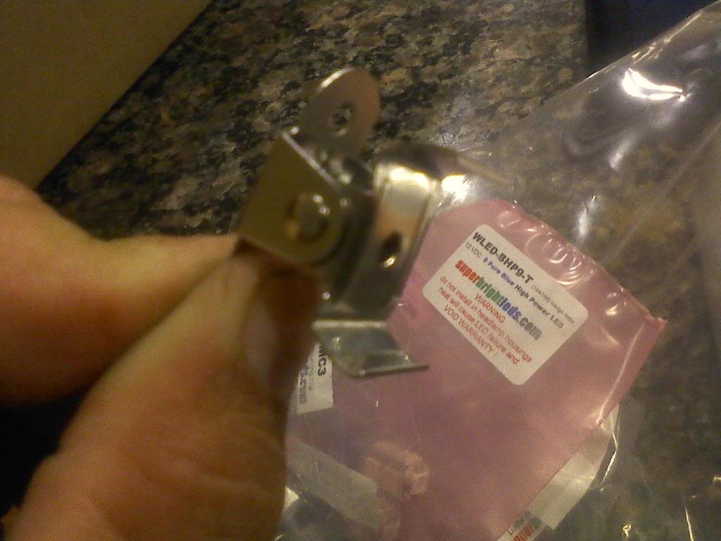

    Here are the waterproof LED's that I got
    This is how I hope to mount them to the frame
    And new headlights :cool:

    I've seen those leds somewhere before :D Where ya gonna mount them? Also whenever you get your intake done I want to see it and possibly copy it.

    I'm going to put the two 24in on the inside of the frame(if possible), angled towards each other/down. The 12in is going to the back of the bumper, angled towards the rear axle and the other 12in is hopefully going in the camper :cool:
    I'm going to try to rig it up Sunday. If you get bored swing on by. I'm also going to be putting in my HID bulbs and the Exide in. I need to start figuring out light locations and also where I'm going to put my switches

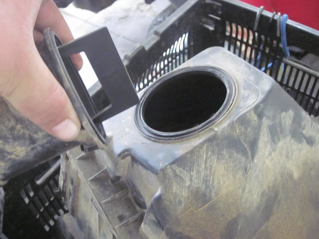

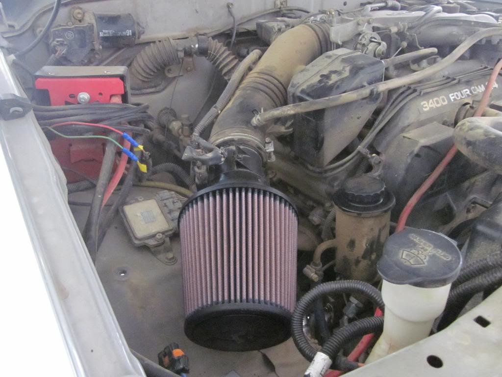

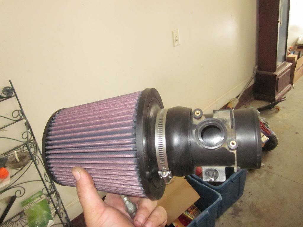

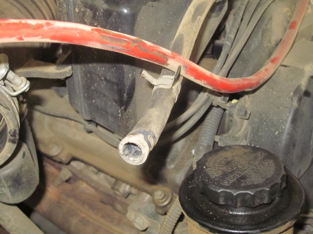

    I got around to doing some work today. I took the old battery and air box out to replace the HID bulbs, turns out it was a f*@kin ballast bad... So I will wait another few days to get them straightened out. I put the new battery in and hooked everything back up, then I got started on the intake.
    1st - Take everything loose and disconnect the MAF sensor and the small vacuum tube on the right side of the air box.
    2nd - Once the box is out you can pull the MAF sensor section off of the air box
    3rd - I had to trim a little bit off of the MAF sensor tube in order to fit the filter on properly, nothing major, maybe 5-10 minutes worth or grind and test. After that it went right together
    4 - The small vacuum tube must be relocated, so I took a good, sharp knife and cut out a small hole (knife and not drill because with the knife the hole had a taper not just a hole) where I put a small air fitting with pipe thread. I put just a little bit of black silicone around the fitting to seal it completely.
    After that it's just a matter of re-assembling.
    I'm very happy with the amount of space that it freed up. I was able to tell a difference at higher RPM's with it, and you can here that thing sucking air :cool:

    You need some engine degreaser something fierce. Looks good though. The camper has a light in there so there wiring and a switch in there. The rock lights would be fun, single power wire to each and ground to nearest location the wire to one good toggle switch.
