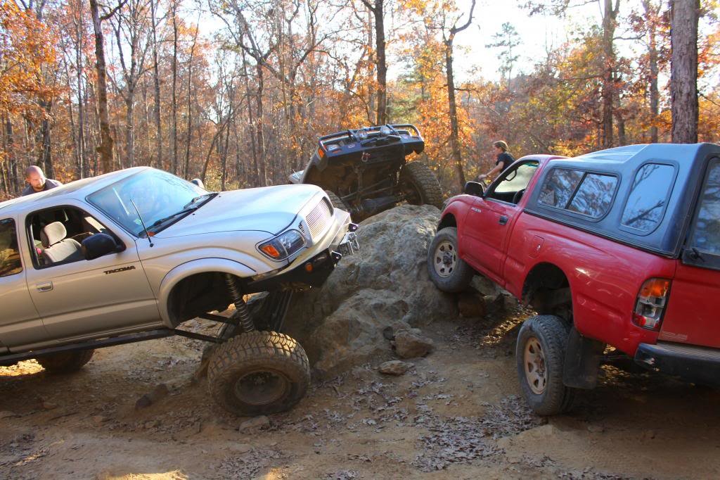

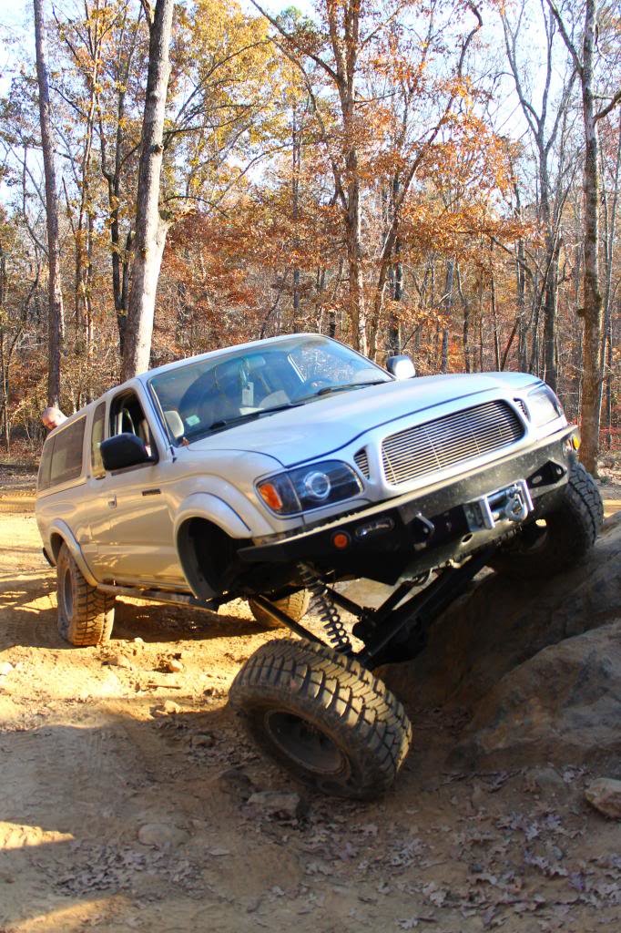

    Not bad for a ProComp suspension and stock/open axles :rolleyes:
    I guess "It's a Jeep thing"

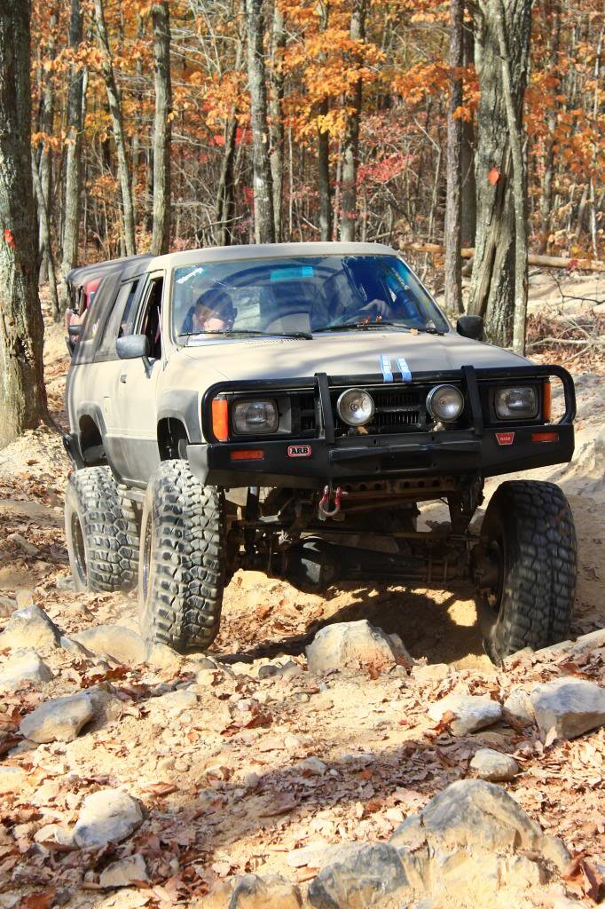

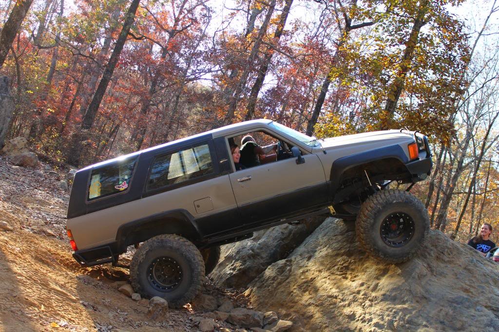

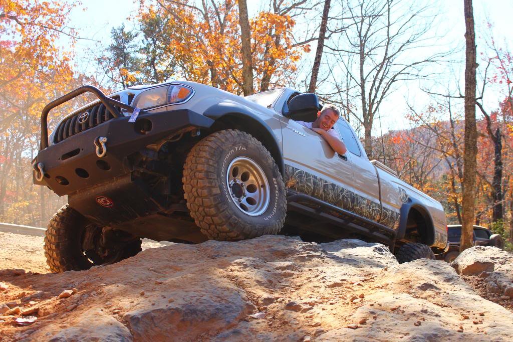

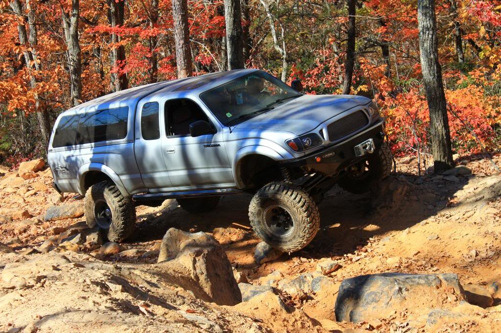

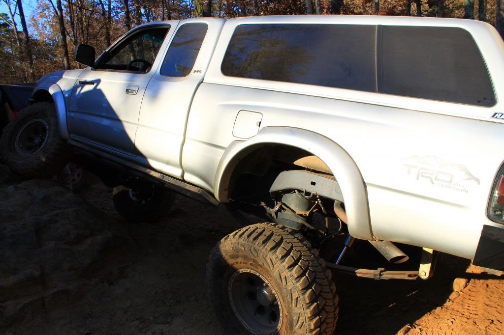

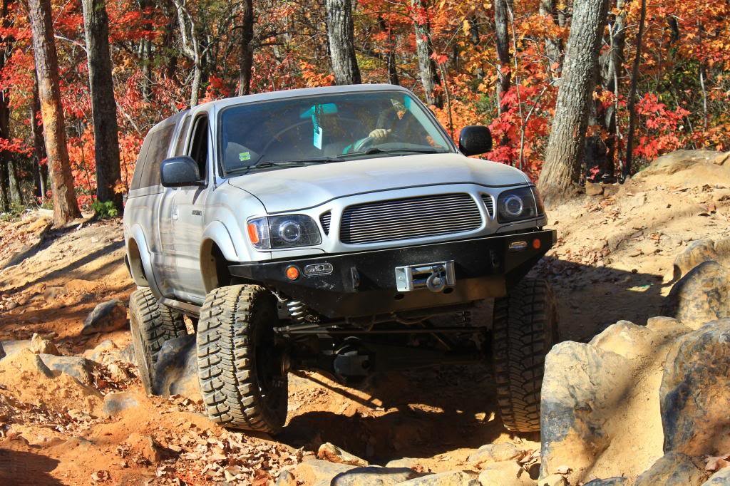

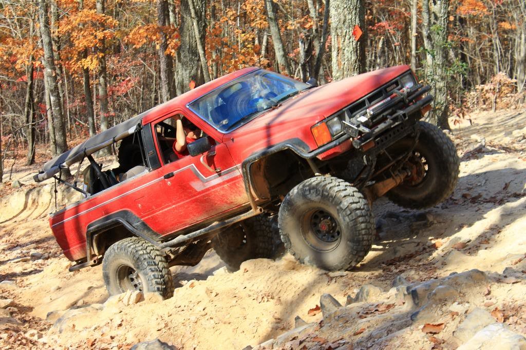

    I had an amazing weekend with some great people and very cool rigs. We had everything from 85 4runners, FJ80, my pile of hell, jerretxx's 06 DCLB, 87 pickup, Havoline Mikes Tacoma and a few Jeeps :rolleyes:
