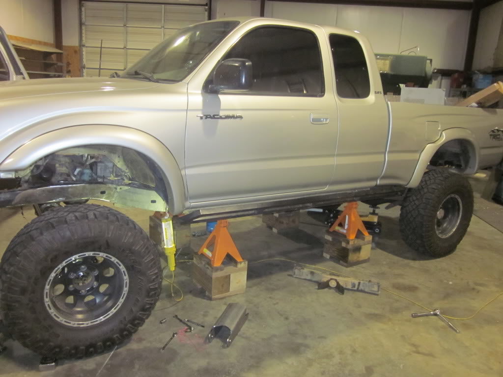

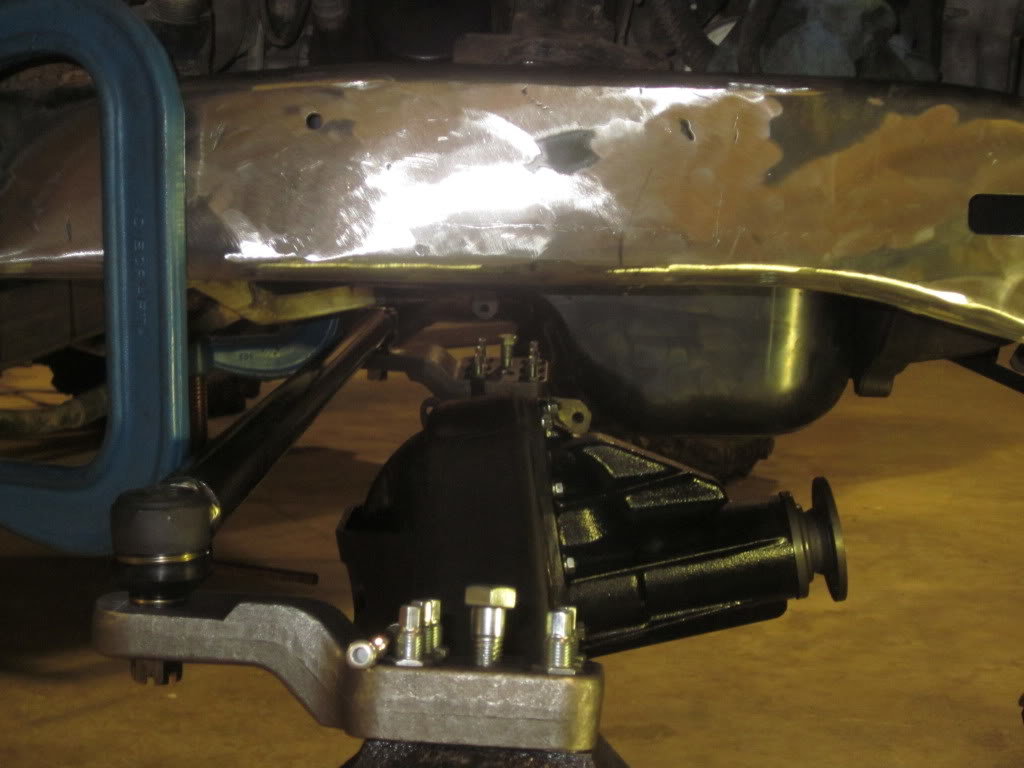

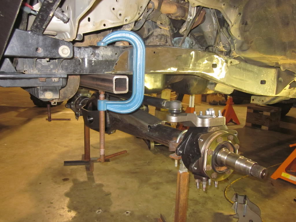

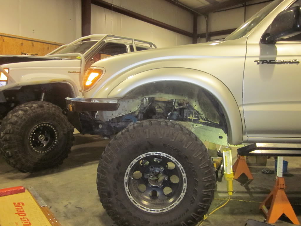

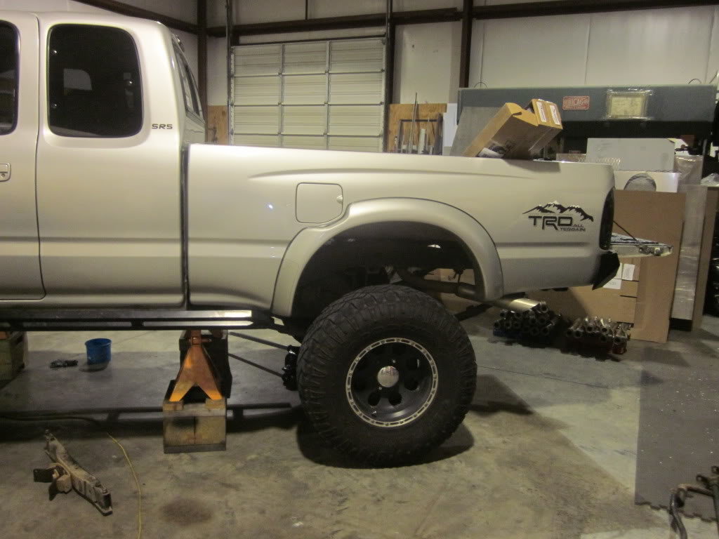

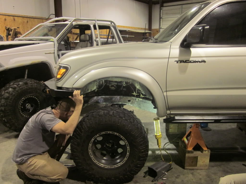

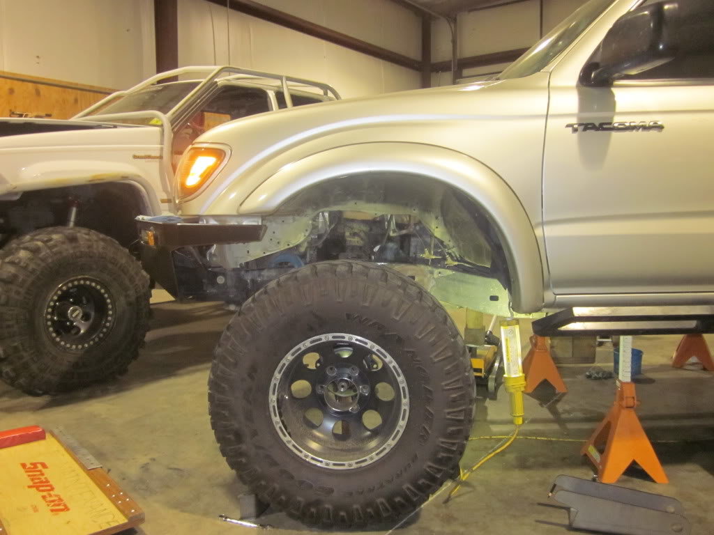

    Well here's where we stand... it's very tight in there and keeping it as low as I wanted isn't looking too good. Instead it's going to be 5-6 inches over stock, about 2-3 inches over where it was, which i can live with.
    I had to choose between stretching it 3-4 inchs, keeping it low and having to trim fenders VS. or keeping the the axle stretched 1 inch, having it a little bit higher, and not having to cut the fenders. It really isn't as bad as the pics look. Plus I'll have some adjustment with the coilovers, so we'll see how she turns out.
    Stretched 4 inches
    Stretched 2.5 inches
    Stretched 1 inch, what we're going with

    Looking good! I agree on the 1 inch stretch.
    quick question though, what size tube did you use for the sliders?

    I think it was 1.5 inch square... I will double check tomorrow.

    thanks, that's what it looks like, maybe 1.75.
