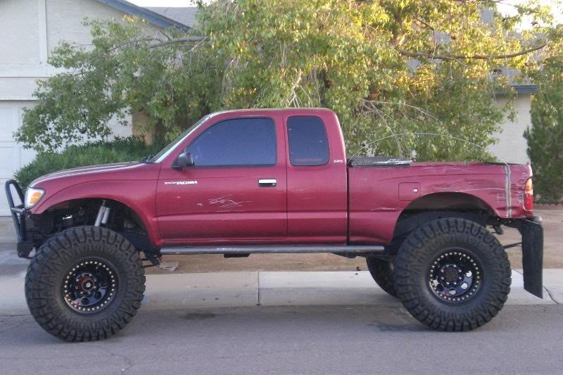

    Here's a good example of why you'd want to move the axle forward
    Sitting on 40"s with minimal modification to the firewall area.
