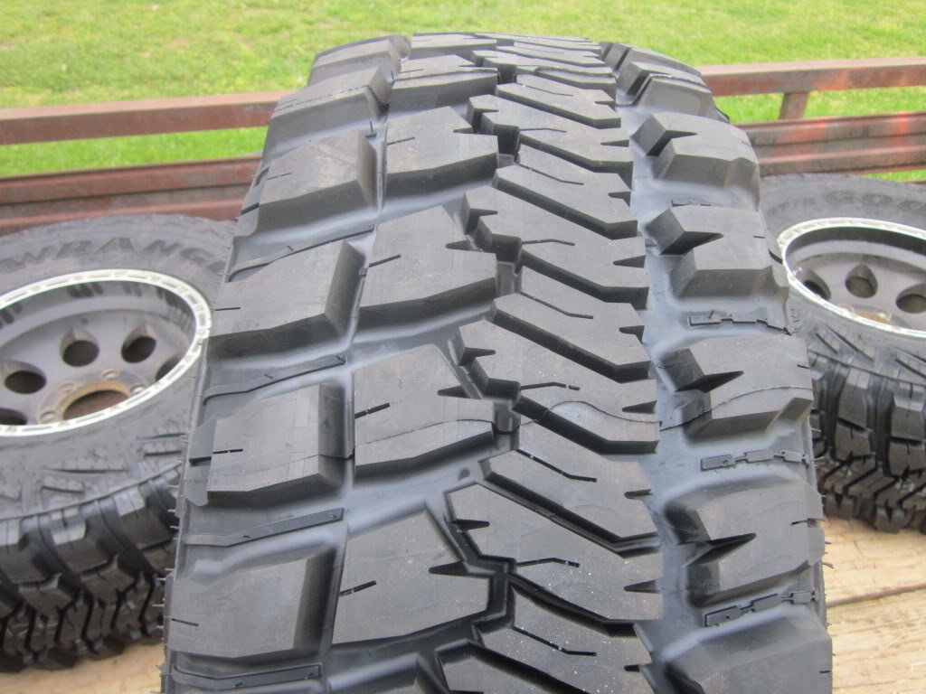

    We supply several of the local Goodyear Service Centers in our area and one of the sales ladies was able to hook me up on a set. I'm anxious to see how they do.

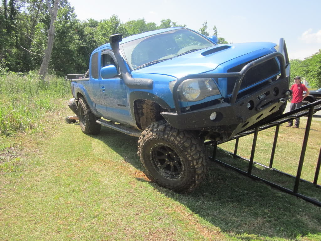

    Got some fresh rubbers today :cool:

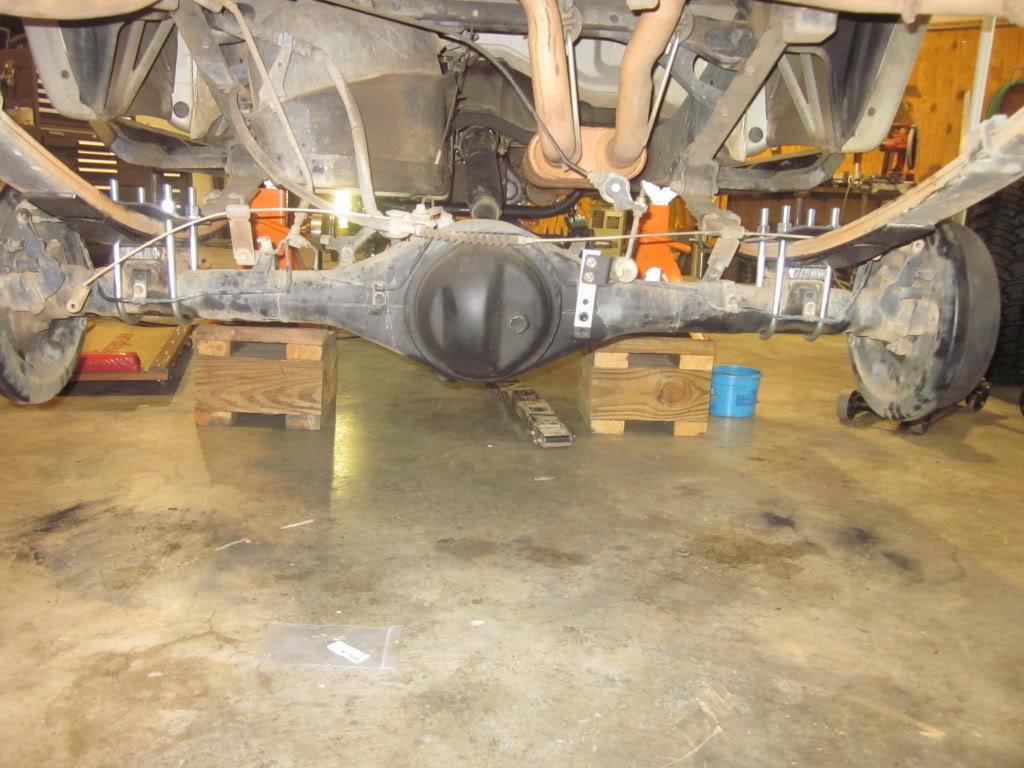

    I'm getting anxious to see how she turns out. I'm trying to figure out what I'm going to end up doing in the rear... I am going to try to rebuild/add to my stock pack and probably run a 1.5 or 2 inch shackle.

    that a sexy tire!

    the question is how will they do... :cool:

    I'm super jelly....

    Yeah, after seeing how they did on other rigs and the abuse they would take I was pretty well set.

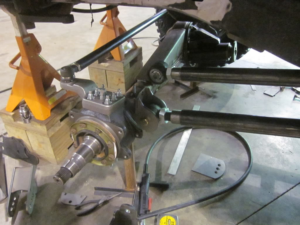

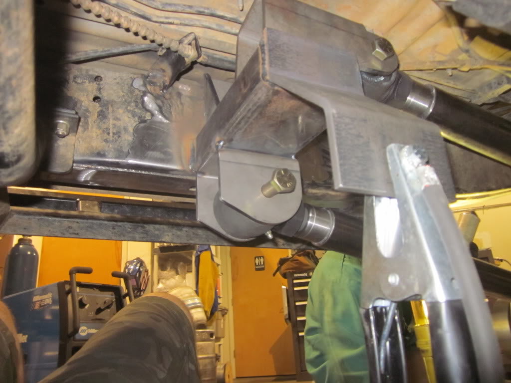

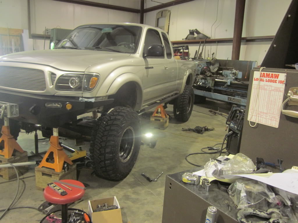

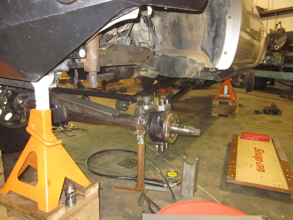

    She's coming along slowly but surely. Fitting the mini axle has been a challenge but I think he's about got'r figured out :rolleyes:
    I'm lovin' the kevlars!

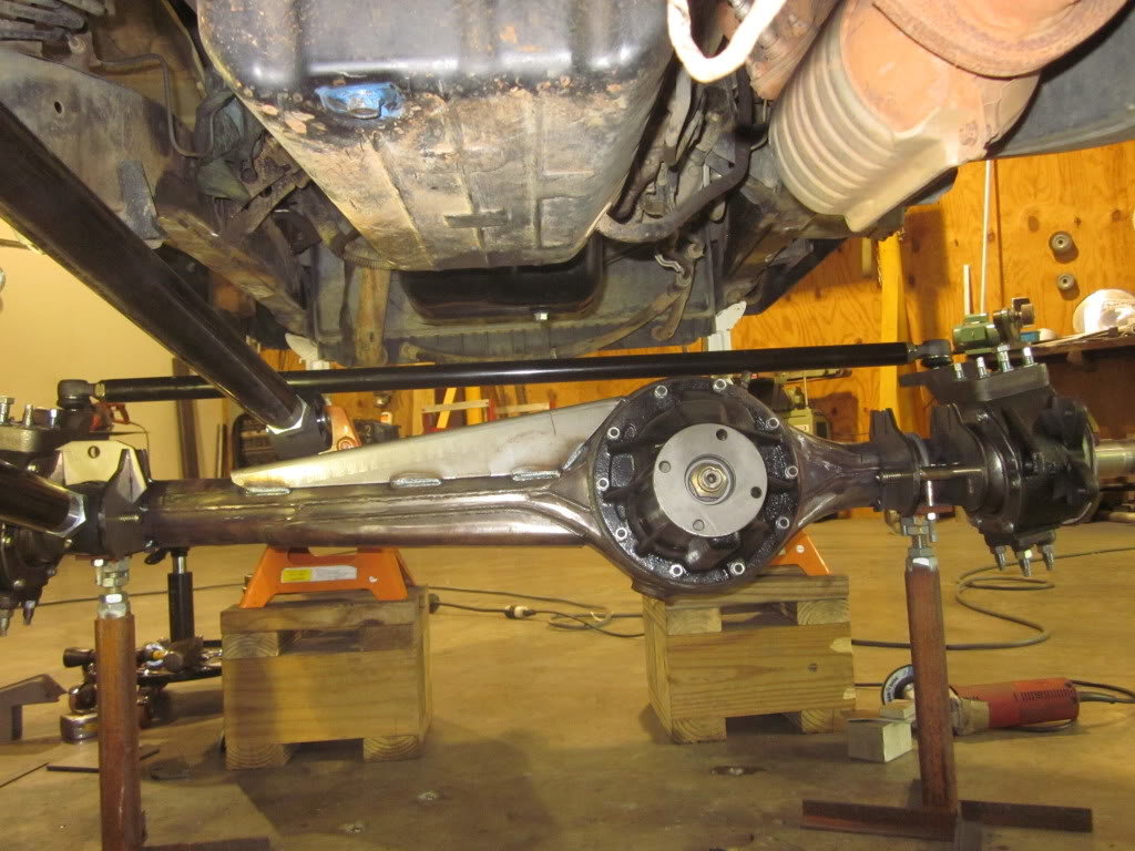

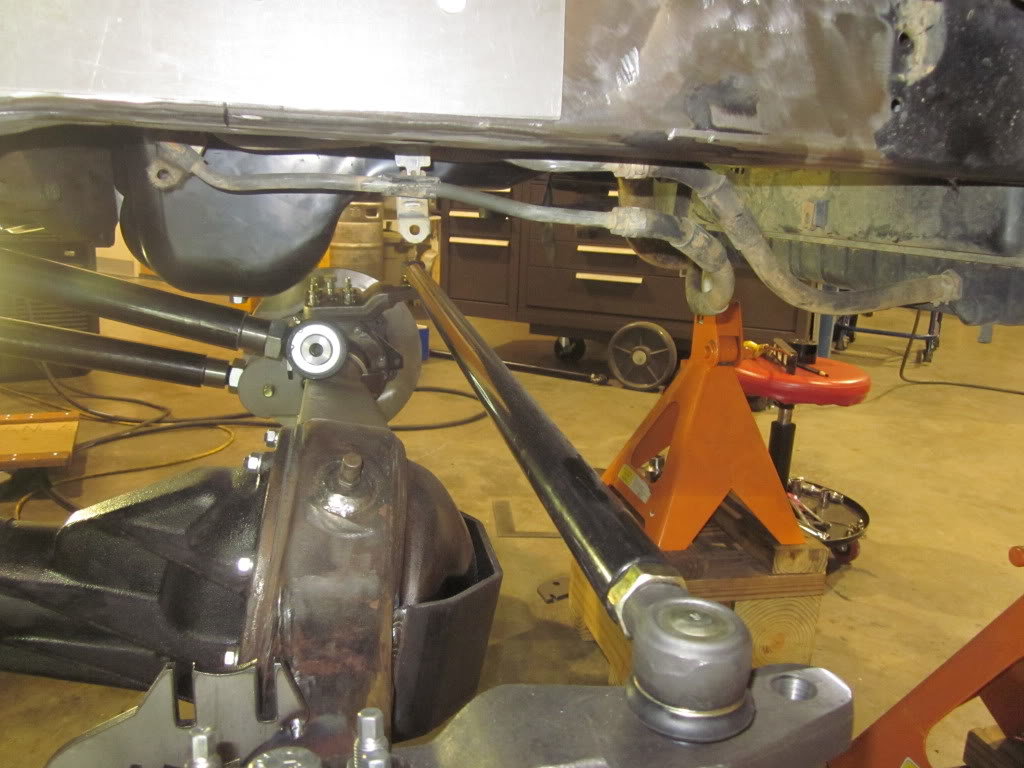

    I just don't care for D44's, plus I wanted to keep everything toyota. One of the big reason's I went with the mini is because of availability of parts in my area. I would have loved to had built a FJ80 axle, and it may happen in the future, but they are tough to come by at a decent price. The toyota mini axle has had a few challenges in getting it to fit, but it think that it will be plenty strong for what I am wanting to do, especially after I do chromoly shafts... I already have a backup set of axles.

    Shouldn't really need spacers with the tundra brakes I believe. They add width to them. Also I'm sure Adam is only moving the axle forward 1" due to the fact that 3link systems don't move back and forth, they are a stationary forward and backward movement. With leaf springs my axle moves 6-8" each direction.. only reason I moved it forward so far and have a 10" slip driveshaft.

    I will be running 2 in spacers to make up the difference

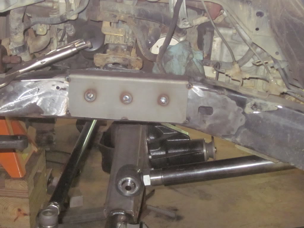

    I'm ended up not doing the IFS hubs. I'm just doing the stock ASCO hubs with 79 FJ40 rotors and V6 calipers. I did chromoly inner hub gears. I'm wanting to do chromoly outer hub gears and dirty 30's here shortly... for the time being I went ahead and got a extra set of axles.

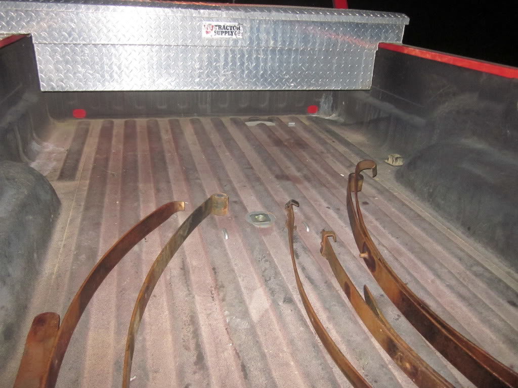

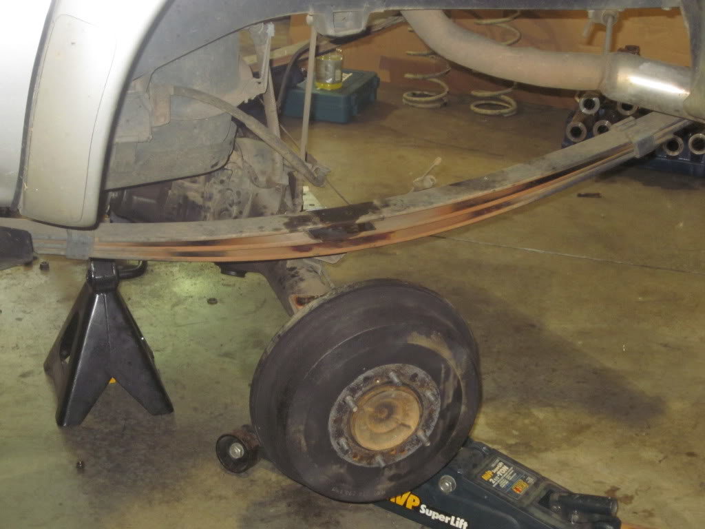

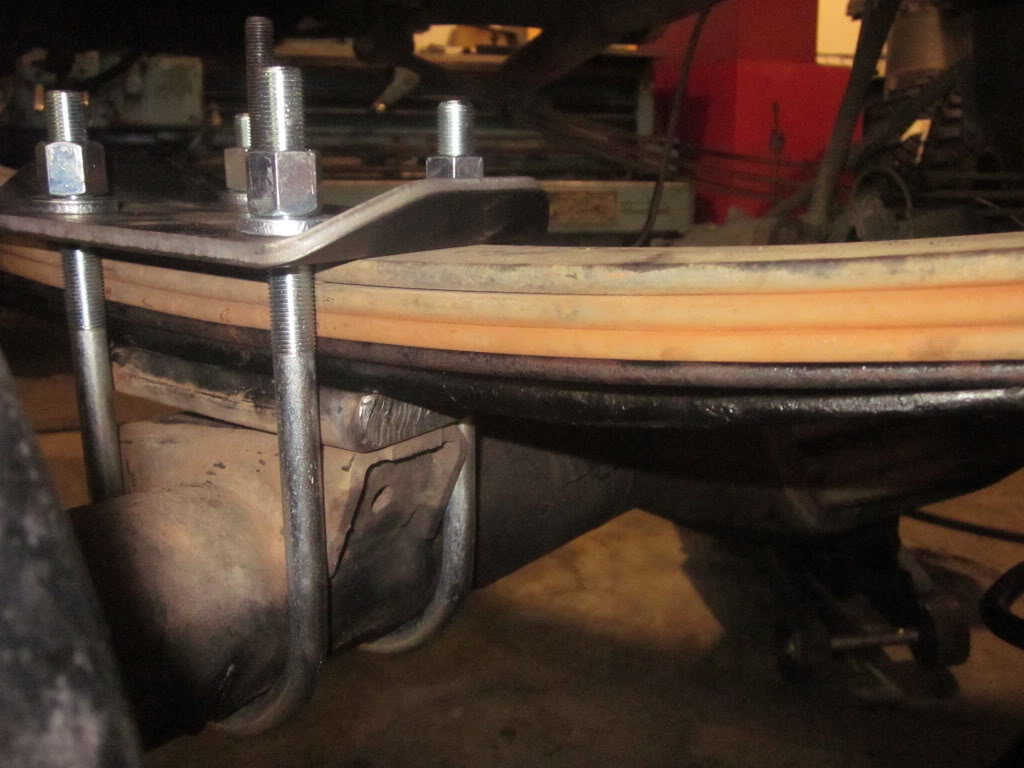

    I was also able to get my 84-85 Toyota 3in lift spring pack taken apart (thanks jerretxx) I'm going to try to adapt a few of the leafs to my stock leaf pack to give it a lil spunk, along with some greasable shackles.

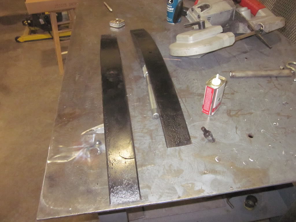

    Was a productive day... I showed up at M.O.B.S. Fab today at 9 and it turns out Damien had a few issues to resolve so he said he would be a while. Had a special guest show up and shoot the bull for a while. Went and got a bite to eat and then he had to head out. Damien showed up around 1pm so by then I had the new leafs that I was going to swap in sanded and rustolium-ized :cool:
    Shortly after that our guest showed back up along with jerretxx to see how the pile of hell was coming... We had some fun and were able to get a few things done. Hopefully she will be done around the first half of next week, but we shall see :rolleyes:
