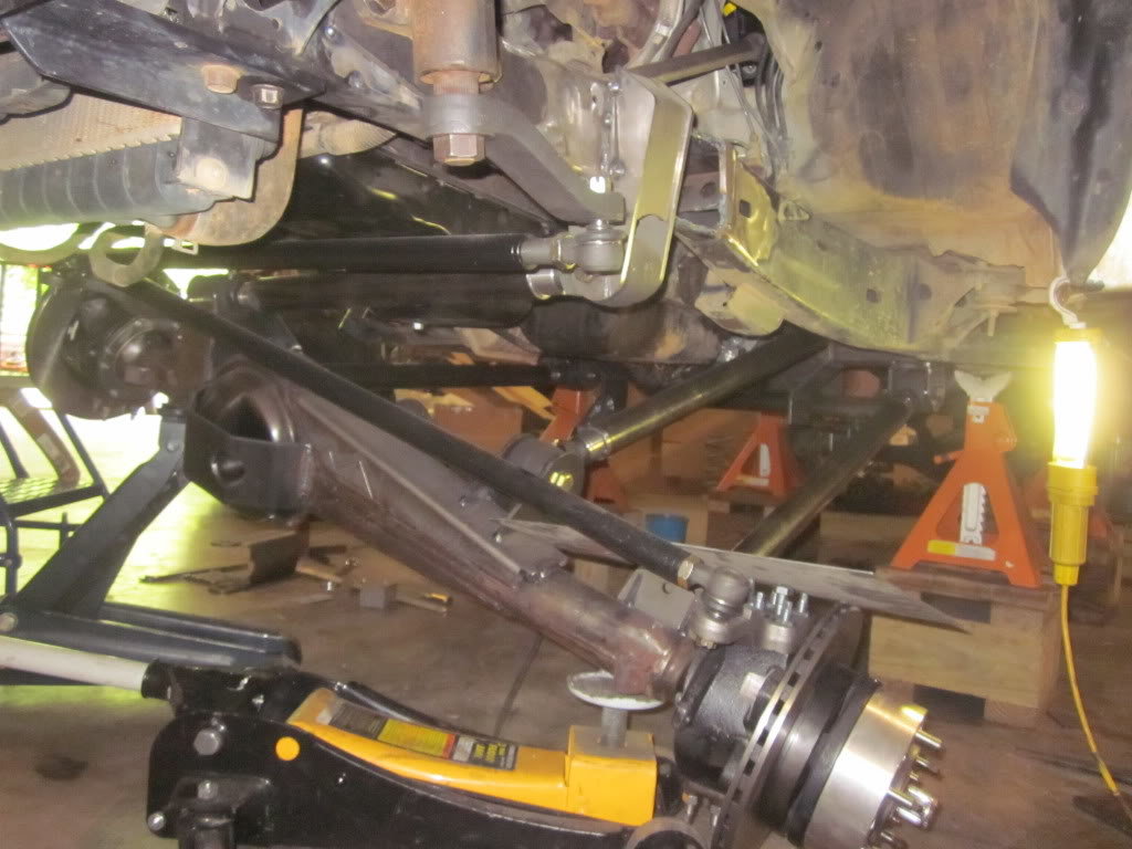

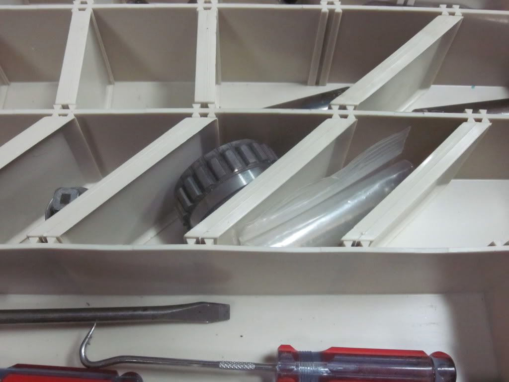

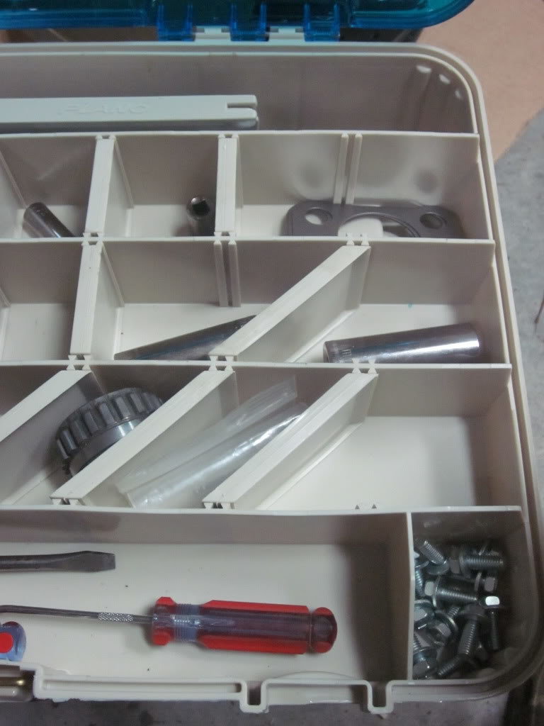

    I spent the evening cleaning the aftermath of the axle re-build. I put everything/as much as possible back on new with the axle so all the old bolts/nuts, knuckle shims, etc... I'm putting into a recovery kit, along with 6 point sockets from 6mm-23mm, breakers bar, extensions, adapters for everything from 1/4-1/2, screw drivers, spare hub gears, and a few other odds and ends. Along with all that I have a spare set of axles to get me by until I can do Dirty 30's

    I'm going by M.O.B.S. tomorrow to see how it's coming and to go ahead and finish assembling the axle. All I have left to do is pack the wheel bearings, tap in the outer seal and install the brakes. I will put the lockouts on when she's ready to go, which shouldn't be too much longer!

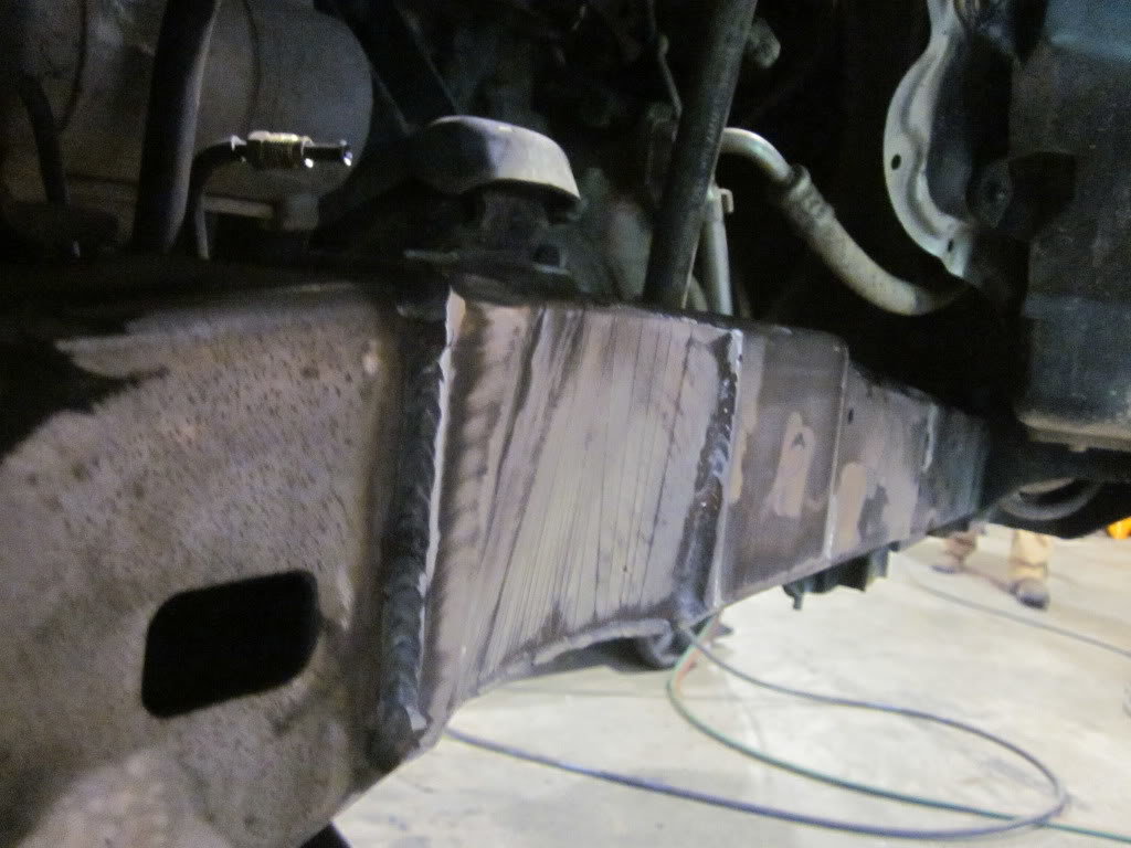

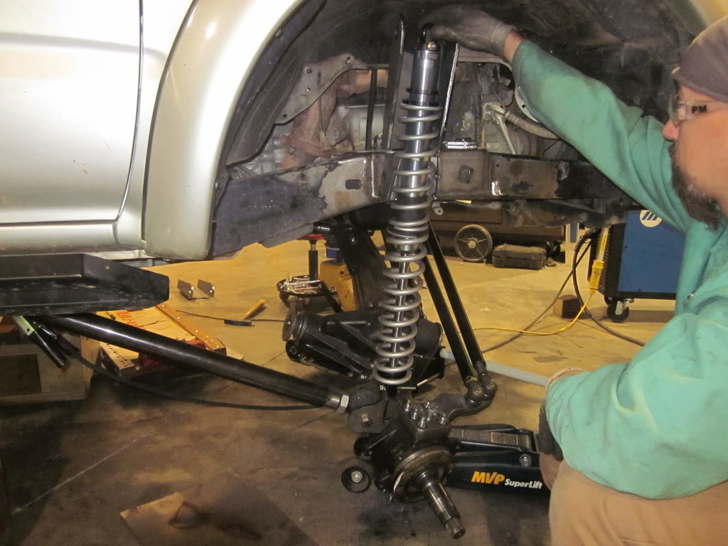

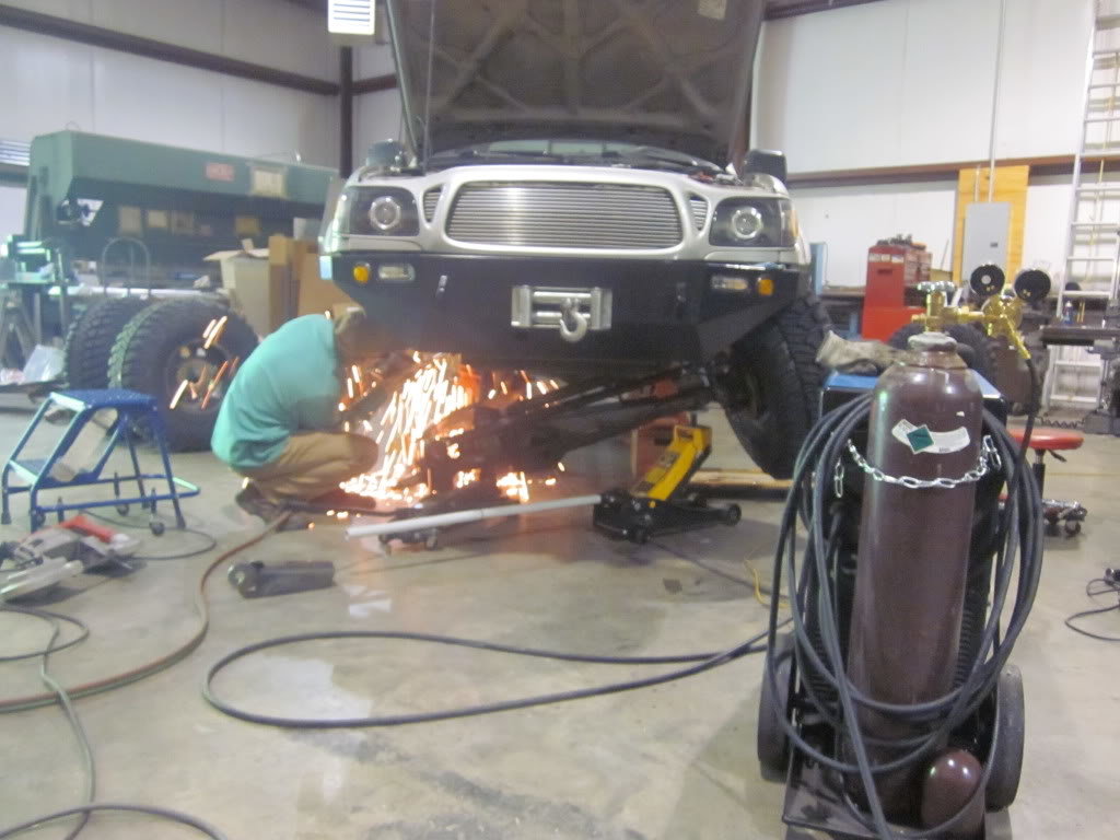

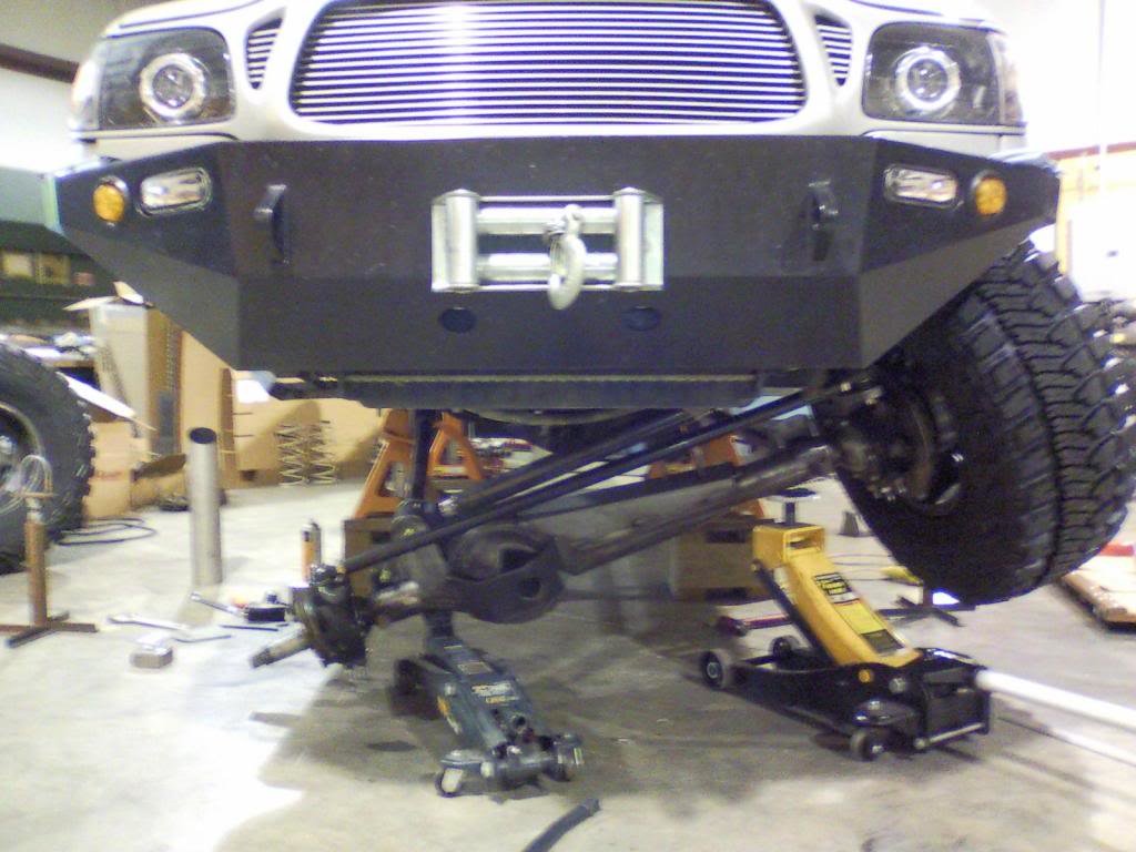

    Got done with class and came down to check out the progress. It looks amazing! Everything looks to be money. I got the wheel bearings packed and the rotor/hub put on and torqued to specs. Damien ran into on issue, he was worried about the shocks rubbing the frame because of how narrow the toyota axle is. So instead of just calling it good enough, he notched the frame, bent a piece of 3/16th steel to fit just right and then welded her back together. Test fit showed it to be perfect, leaving about 1/4in at full droop.
    I really can't say enough about Damien and his work. This hasn't been the easiest project, but it's come out looking amazing. He's gone above and beyond when it's come to the design on the build. He's treated it like it was his own... He knows that I'm not going to be too hard on it, but he's made everything like it's for his crawler that he intends to put balls to the wall on every obstacle
