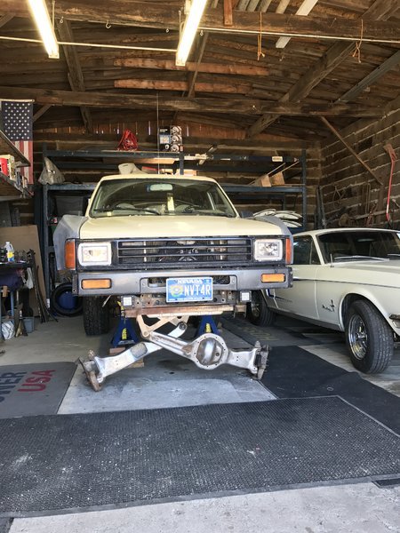

    After about 1.5 years of not having a front driveline I finally had one made, it uses 1310 U joints instead of the smaller ones that came stock with the front drivelines and has a pretty heavy duty slip joint. I had to re-drill the flange on the transfer case but that was a pretty easy process. After I installed it I had to take it out and make sure it was a correct length and had enough articulation in the joints. All in all I'm pretty stoked to have 4x4 again!

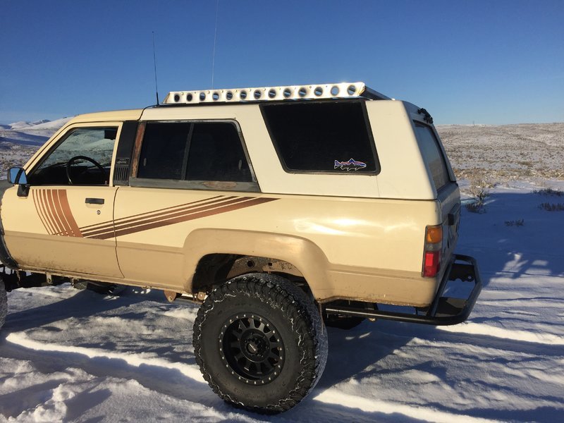

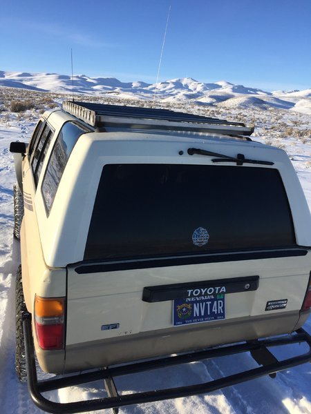

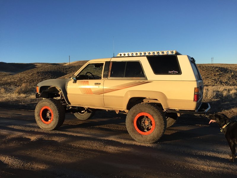

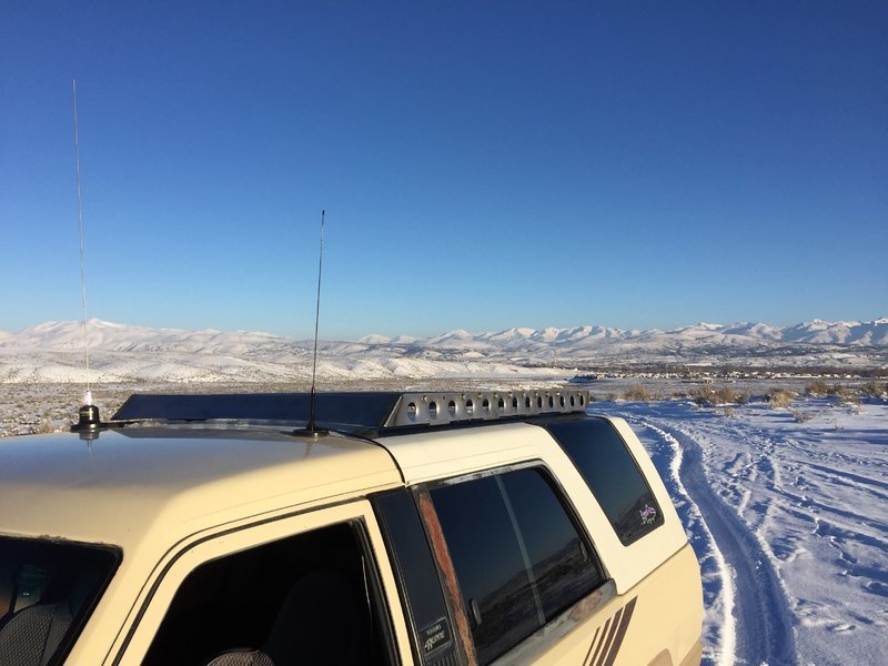

    I actually did something to my 4Runner. I've been wanting a roof rack for this thing for quite a while now but I hate the high profile of the Yakima/Thule racks so I made my own. Pretty stocked with how it has turned out so far.

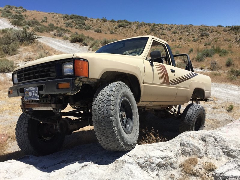

    Got back from King of the Hammers and mounted up an old take off set of 35" Toyos from my Tundra onto the Robby Gordon beadlocks. Front fiberglass makes the 35's look pretty small but hopefully when I bring the ride height down while reworking the suspension it'll sit better on the 35's

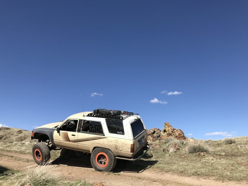

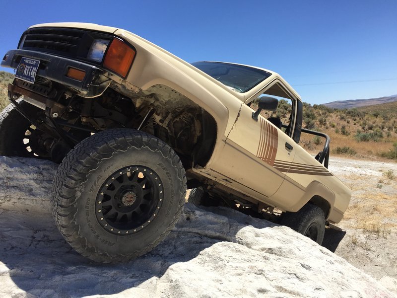

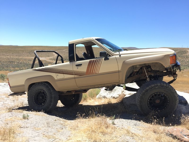

    Here are a few pictures from a quick trip with some local guys last weekend.

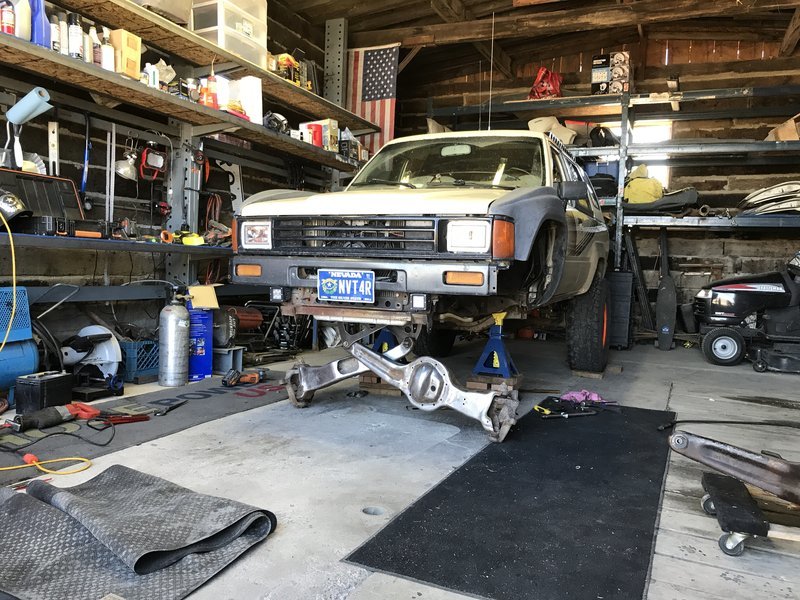

    Tear down and mock up has began. I'll be rebuilding the 302 that's in it, running dual cases with an FJ Cruiser transfer case behind the stock Toyota case to achieve the drivers side drop. Ford 9" in the rear with spring under Deavers. Front is a Ford Dana 44 twin traction beam and based off of the solidworks drawing should be at 18" of travel with 10" coilovers. Front crossmember with be plate and boxed with tube running through it to stiffen it up. I'll be tubbing the back end to clear for suspension and running modified fiberglass bedsides. Front fender/core support will be cut off and be tubed to tie into the shock mounts and cage.

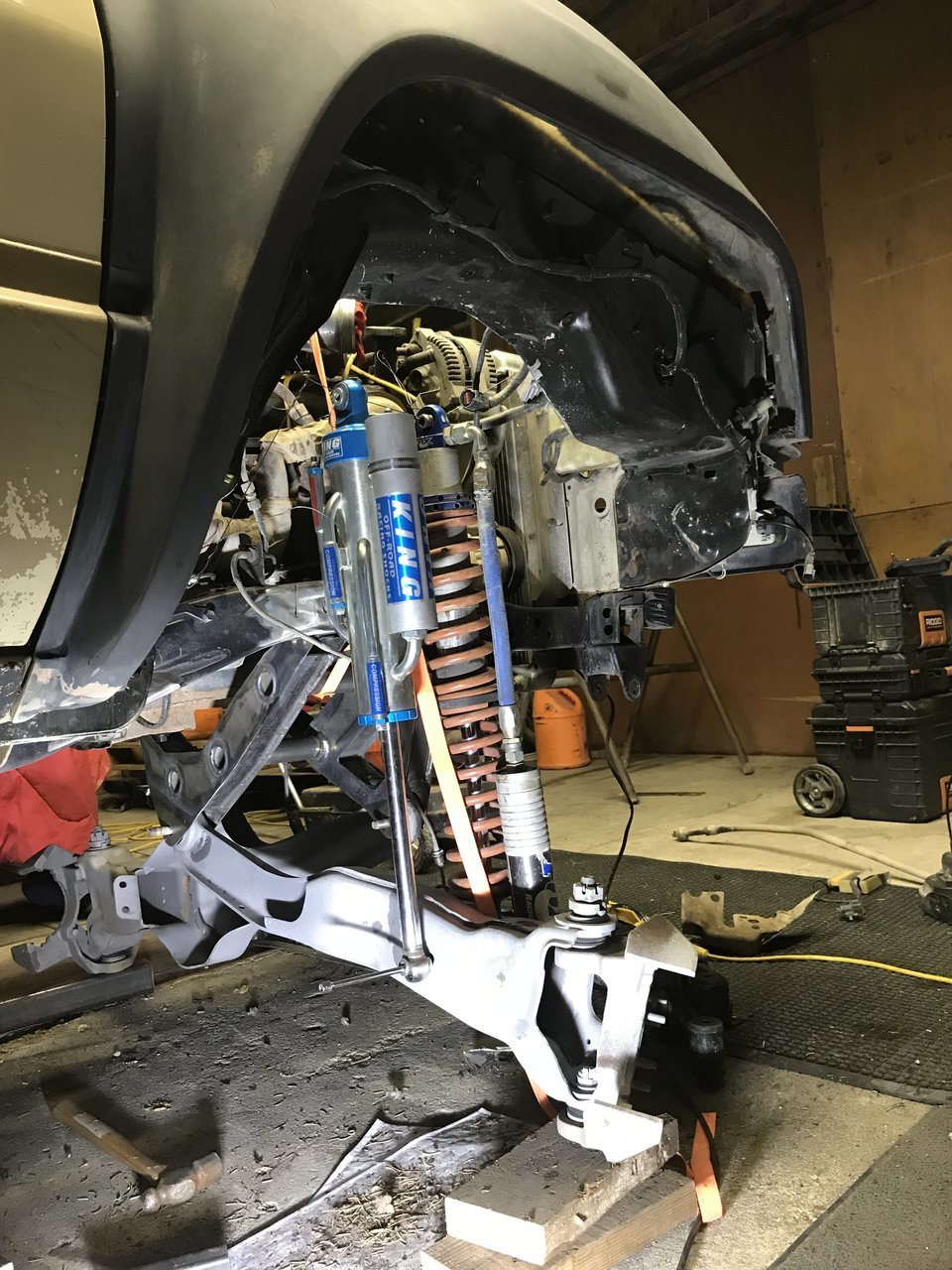

    Cut the inner fenders out to fit some little shocks in there. After New Years I should be hitting it pretty hard, hope to make some good progress.6D0594F4-CE7C-4C6B-9450-8CFFC914D186.jpg
