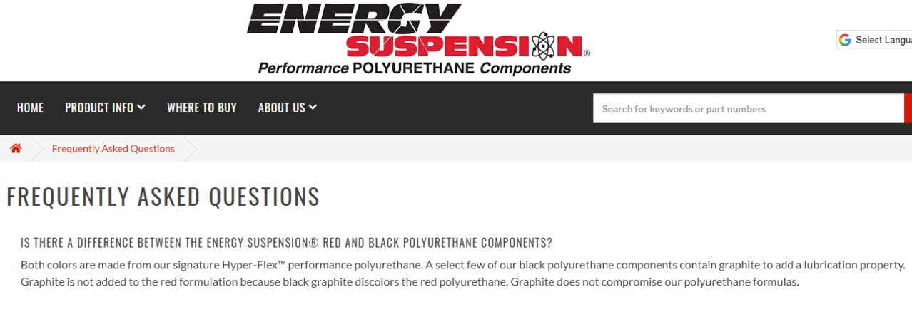

    I just got off the phone with a guy from Energy Suspension and he said this part, 8.5123 is not one of the select few that contain graphite in the black version.
    He said body mounts and control arm bushings are the ones that may contain graphite in some applications. :bananadance:

    Good to know - I always looked at the G in the part #'s which I was under the impression stood for "graphite".. More importantly though, did he confirm these red ones are one of the select few that give you 10 horsepower?! :rofl:

    I actually told him I was considering giving up the 10 horsepower for ones that don't squeak.
    He said, "don't do that. The both squeak the same...…" :facepalm:
    I guess there's a reason engineers are not sales or marketing people. o_O

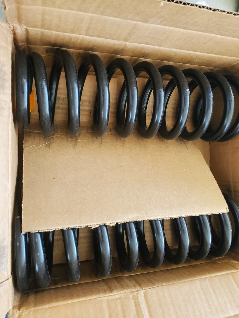

    Curious what tools yall are using for spring compressor? I borrowed a couple and they were both too big so I ended up using floor jacks.
    Edit: A little sketched out using the jack method for my LBJ

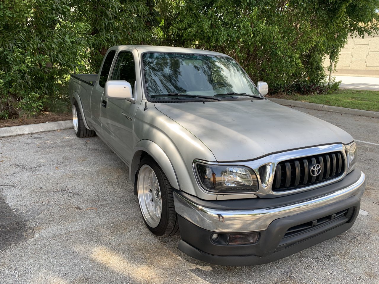

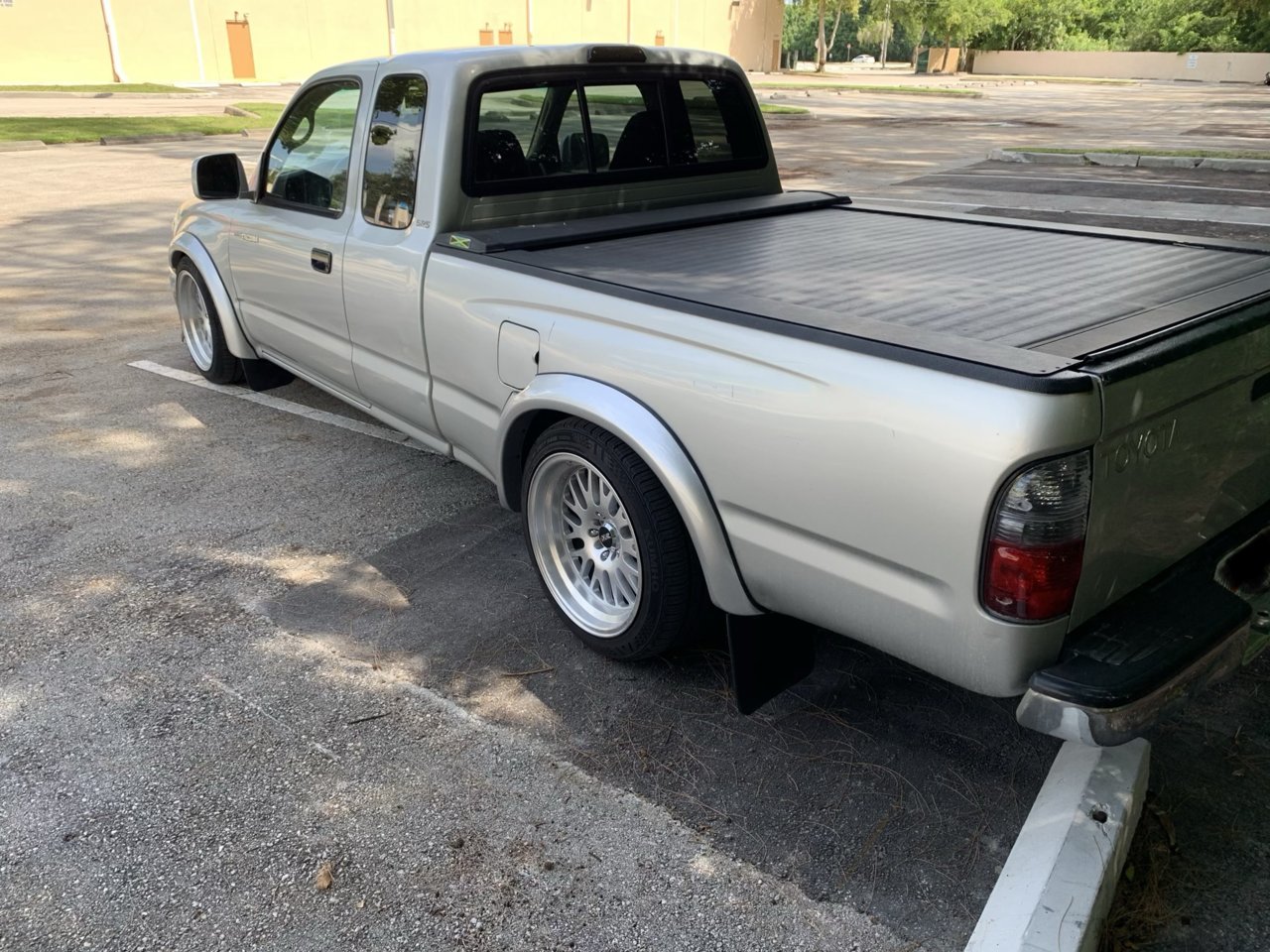

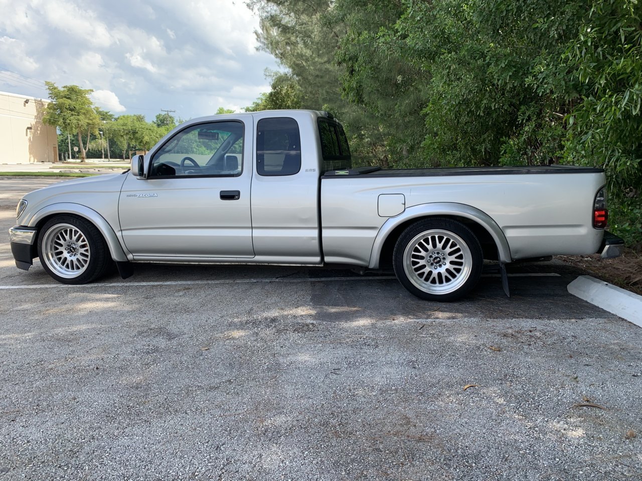

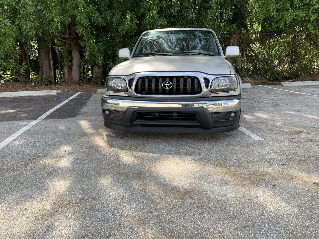

    upload_2020-7-14_18-5-47.jpg upload_2020-7-14_18-6-10.jpgupload_2020-7-14_18-7-56.jpg upload_2020-7-14_18-8-38.jpg
    Here is my Taco rides pretty good very smooth just need to firm up the rear, I have the 4x4 leafs to install.
    Front:
    Qa1 coil overs
    Ball joint flip (going to change with spindle mod)
    DJM upper control arms
    All new ball joints
    Energy suspension sway bar bushings
    Rear:
    4” steel blocks
    Kyb shocks
