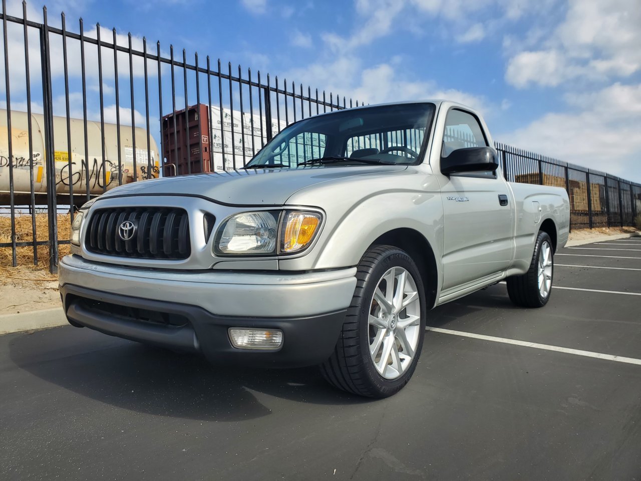

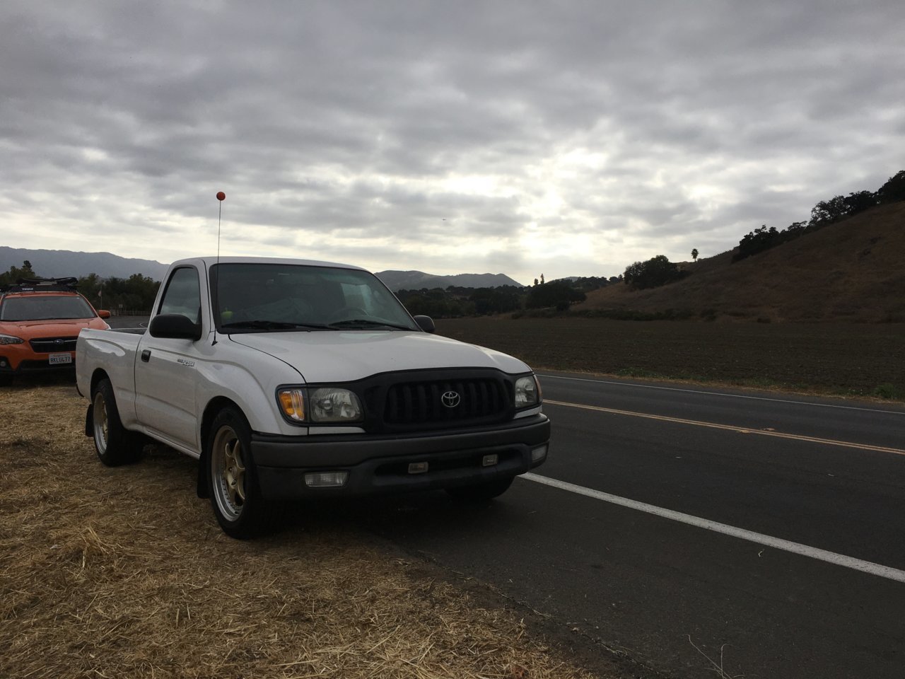

    Very nice truck man! Hows the ride ? Smooth or bouncy? Was gonna do the belltech set up all around myself but ended up going with the kyb monomax instead all around 3/3

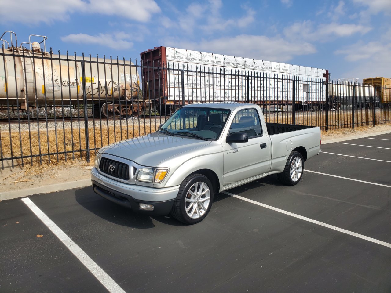

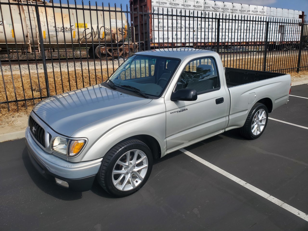

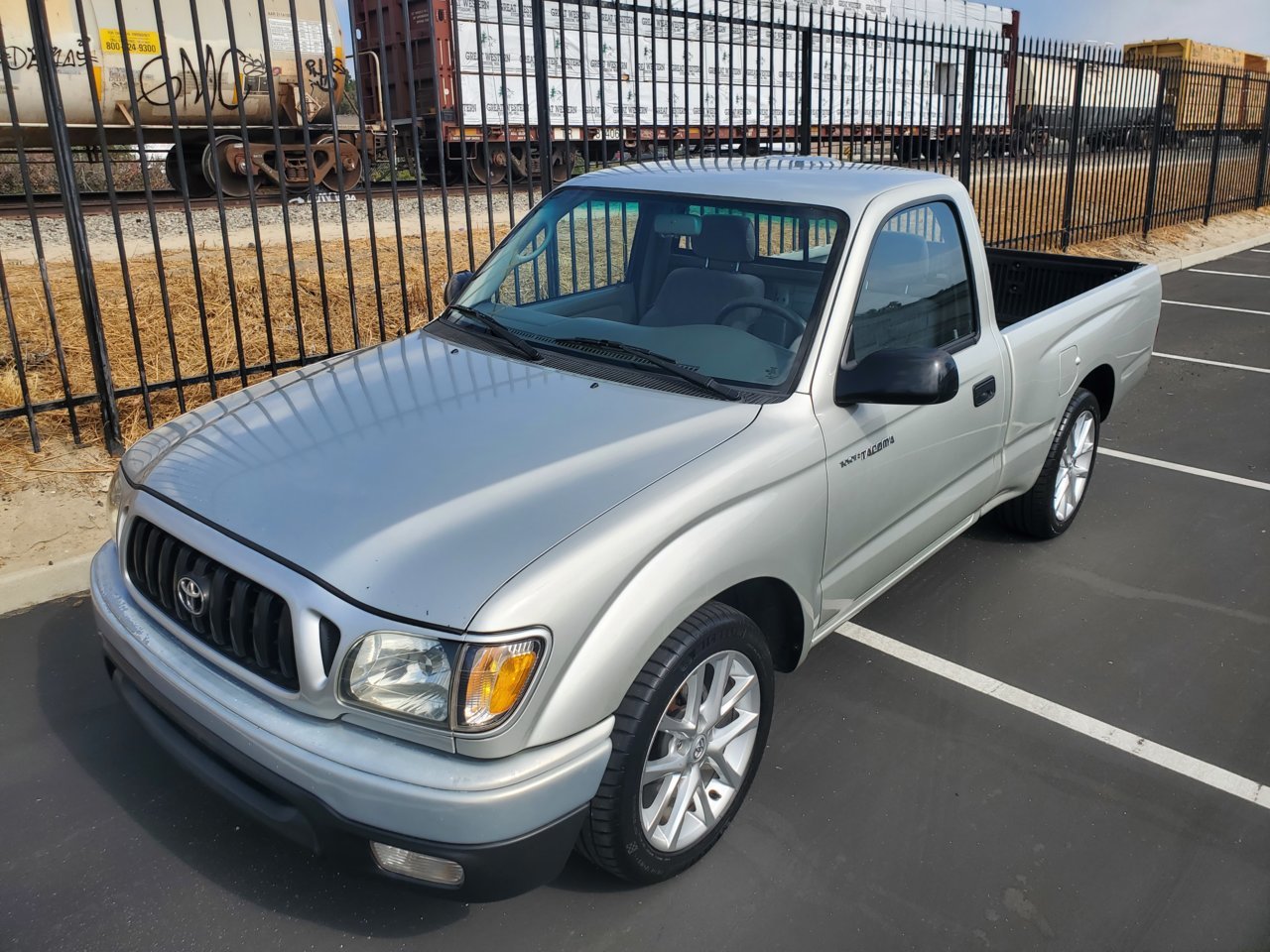

    Maybe not the setup most "newbs" would go for when lowering, but I am super happy with my results achieved without using any of the common aftermarket parts available.
    2 / 3 (almost) Drop:
    Deaver custom made 2.65" front drop coils 368 lbs (2" measured drop).
    Rear oem leafs de-arched also by Deaver for 2 3/4" lower in the rear.
    Got a nicer stance and better handling while keeping the ride very tame on the street and highways. I left a bit of rake in the rear too so I could still load up the truck bed when needed.

    Looking really nice and functional! :thumbsup:

    thats clean!!! :thumbsup:

    i know the pain. I just got lucky my girl found it on marketplace while on vacation in the Bay area. It was not a cheap vacation :rofl: . Timing must be right

    Thanks a bunch! I am so impressed with the ride quality now, it is actually smoother and less floaty/bumpy on the highway at speed and doesnt hit low speed bumps as hard either.
    Oh yeah - it also handles the curves with ferocious grip now, and there is notably less body roll in the turns and dive under hard braking. I had so much fun this weekend on my initial test run to my local canyon and favorite freeway ramps.
    Basically this truck rides and handles better all around now without any compromise or issues, I am super glad with the method I used to lower my Tacoma!!

    nice lol. I dont have that issue since its only lowered 3 inches in the back. But my 4 inch steel blocks just came in and hoping i dont have that issue after.
    really clean truck by the way! Was hoping to catch it at dockweiler a few weeks ago lol.

    Daily duties and canyon comfort is always a plus for me as well especially in a pick up which is way more of a challenge to accomplish rather than just slapping coils on a car lol.
    I took the taco out on a spirited drive thru the malibu canyons and the 154 by cachuma lake recently and it felt like the truck wanted me to go faster haha. A bit bumpy and stiff but i still have some work to do :D
    No where near as clean as yours is but she’s definitely a keeper
