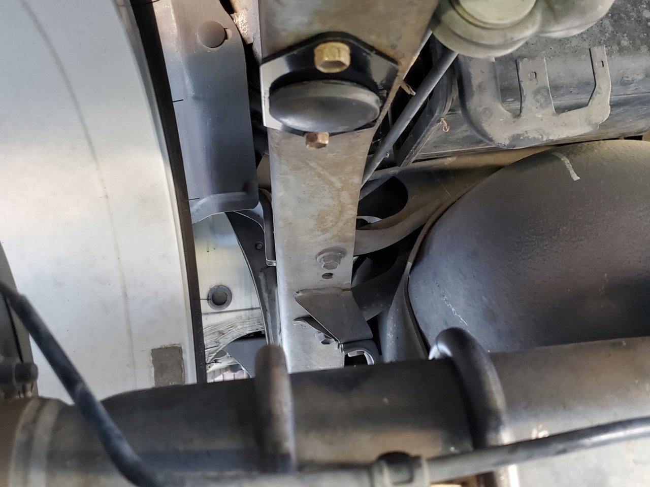

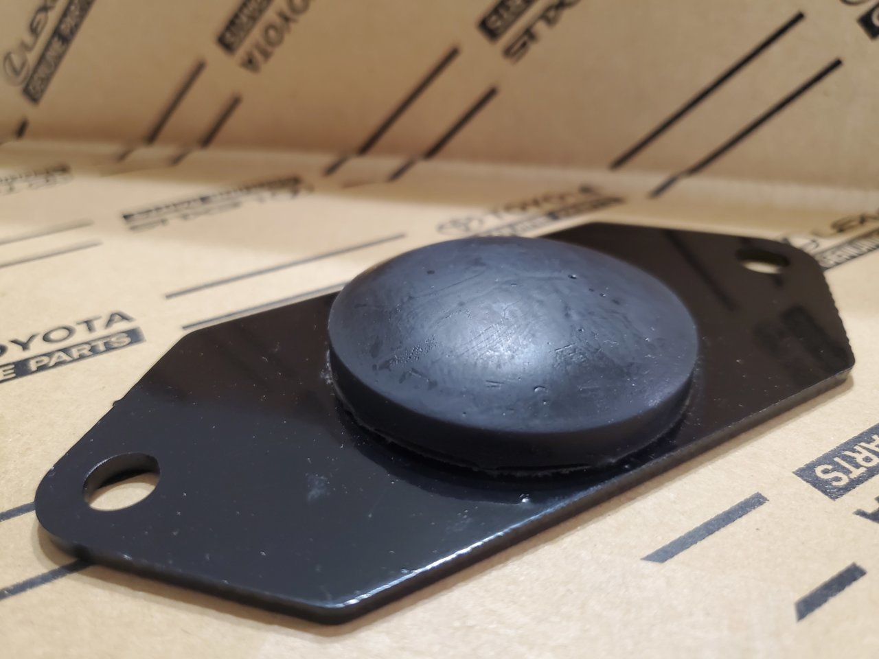

    Not sure if there is much give in those u-bolts. Try adding bump stops or even zip tie some flip flops under your frame rail or something to absorb the impact.
    I made these using Energy low pro bumps and tracing the oem pattern at a buddies shop:
    I have a ton of clearance with my 3" drop, no bottoming out ever.
    After trying bump stops, you can look into adding a c-notch to your frame also if the issue is bottoming out still.

    yup i have that lo pro bumpstop in but it still taps metal...i have yet to check the u bolts if they are making contact with the frame. also have a c-notch plate ready to be welded in, i just need to find a good welder to do it

    if yours does bottom out, that bumpstop plate might tap the top of that u-bolt (looks like)...i think thats whats happening with mine...i see some contact marks on the u-bolts

    If you are hitting the u-bolt on your frame then either your bump stop is not quite large enough and/or it is not centered properly. I noticed the oem bump stops are slightly offset and not in the center of the mount, this may be part of the issue.
