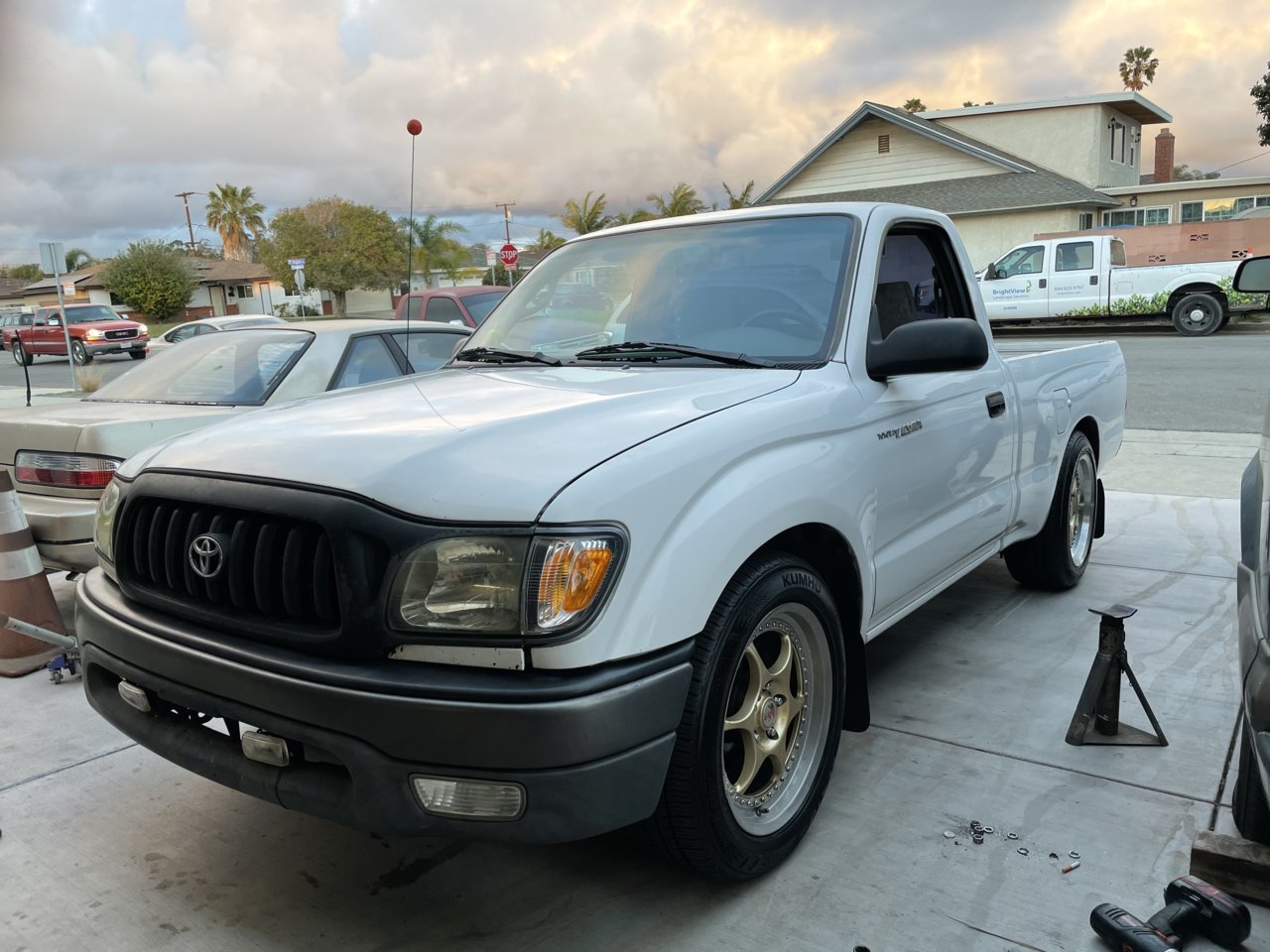

    Intake, wheels, 3/3 drop all around, tires and sound system
    The taco got a a bit lower over the weekend :D replaced the aluminum 3 inch blocks for 4 inch steel blocks. Even tho chassis tech sent me the wrong blocks we managed to get it done regardless after some fab. Anybody have that link to the rear bump stops? :)
    TOY 96, mjbtaco, 2Runner and 2 others like this.

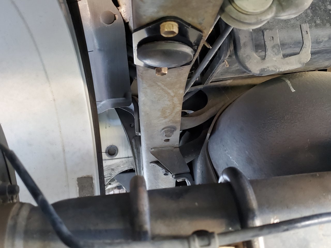

    @isaac665 looking good!
    How do you like the ride of the Chassistech kit vs stock? Are you hitting your frame in the rear now over large bumps? Any issues getting aligned?

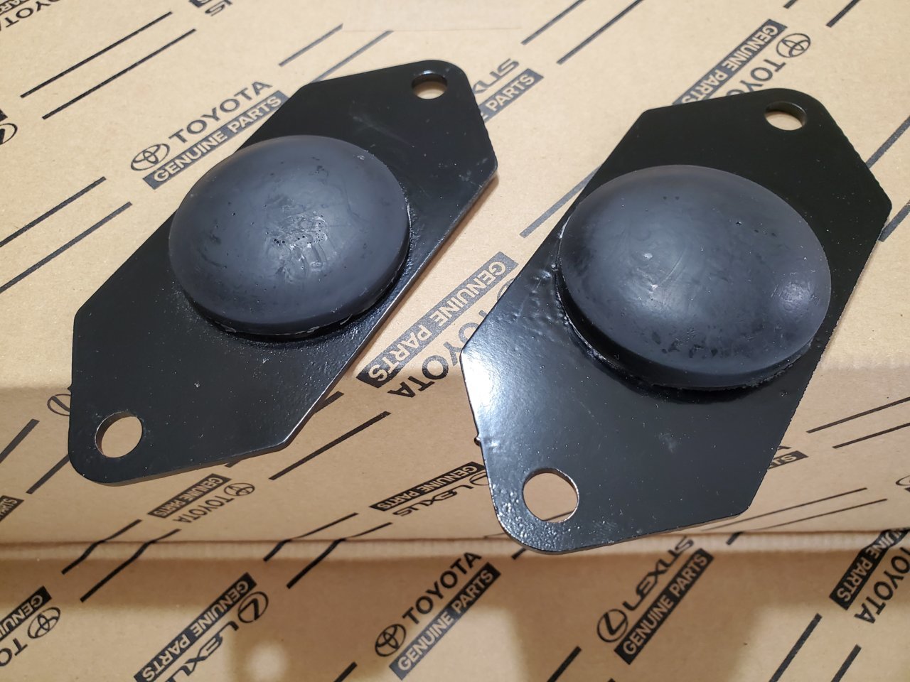

    There is no link since these are not available to my knowledge. I ordered these Energy ultra low universal bump stops.
    Then built some, basically traced the mounting plate from the oem part, and cut out with a water-jet at my buddies shop. Then just welded the Energy low profile universal bump to the center and coated with paint.
    I have also heard of folks cutting down their stock ones, and even zip tying flip flops to the frame rail! Whatever keeps you from hitting the metal basically.
    krustytaco and isaac665 like this.

    @2Runner appreciate it :cheers:
    Definitely bottoming out in the rear now. The axle is sitting on the bump stops. But im sure after they get trimmed I should have no issues at all. Still a smooth ride. And i havent taken her back to get an alignment yet but i’ll let you know if there are any issues.
    Ok yeah I thought you had custom made those little brackets. They look legit... i am just gonna end up trimming the stock bump stops. That flip flop trick isnt a bad idea either tho. Zip ties fix all :D
    but for now she sits perfectly fine. Well in my eyes hahah :thumbsup:

    For reference, I removed my rear bump stops for a while before making the custom versions. I am only 3 inch drop but didnt have any bottoming out at all.
