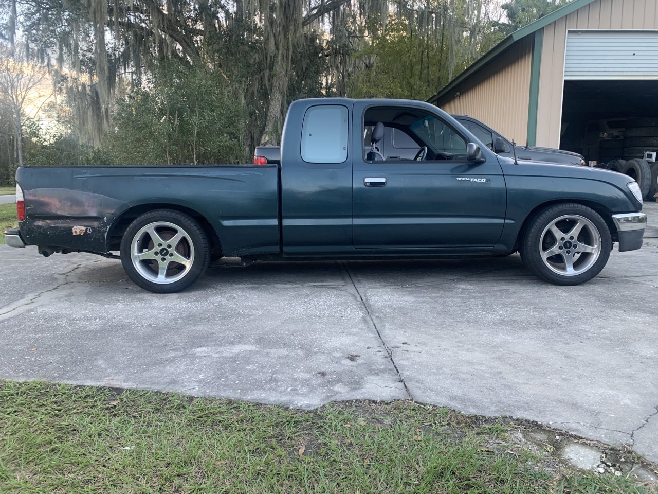

    I finally installed the belltech 3” blocks. I also trimmed the oem bumpstops in the front bc I was bottoming out on certain bumps. So truck is now a 3/3 drop. Truck rides a lot better too. I’m probably going to swap out the rockauto shocks for some kyb gas adjusts or if y’all recommend anything else I’m all ears. here’s how she sits now

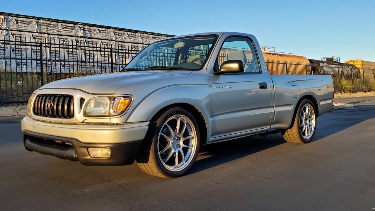

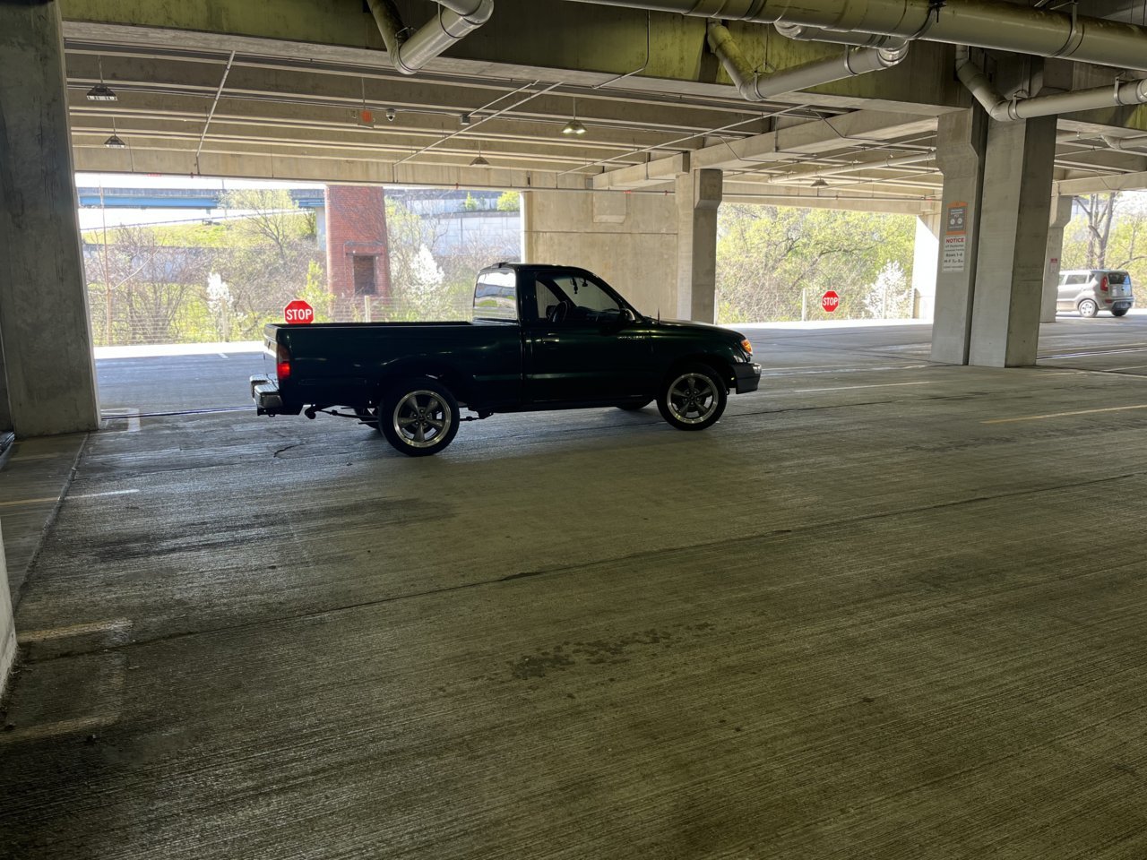

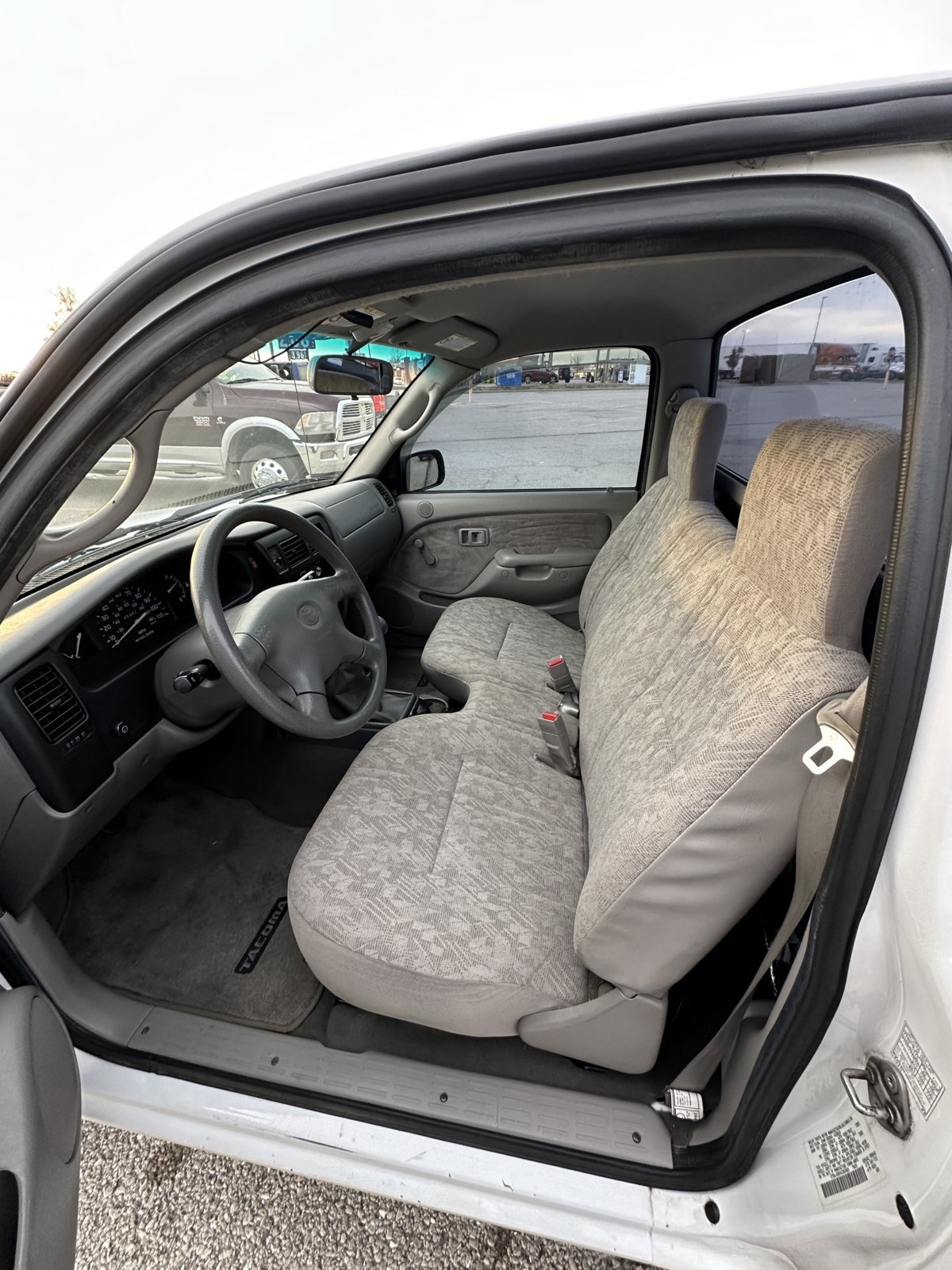

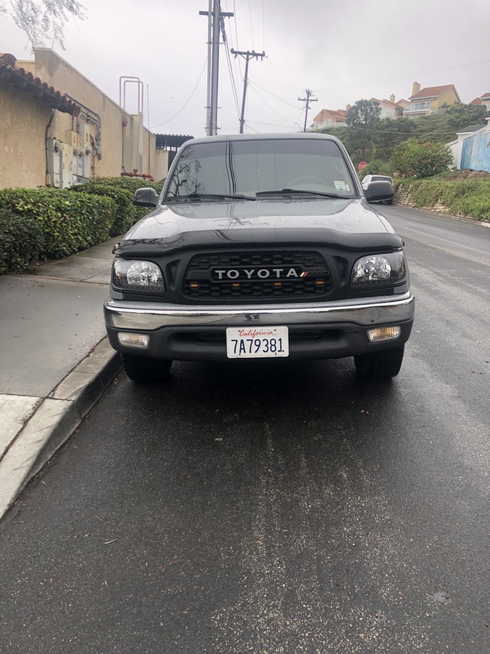

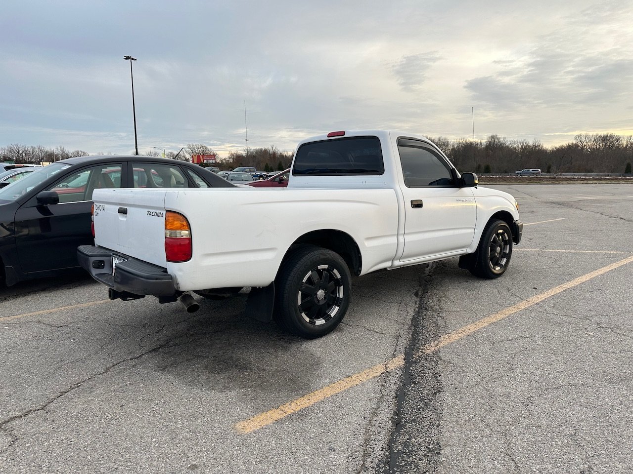

    It’s pretty much stock painted it 4 years ago but not so sure how it would look dropped with how it currently looks3F9BA6A9-4B9C-4D72-9A3D-E05DDE8EBF42.jpg B80C8FBF-1618-4AB6-B6DE-7CAD040F0449.jpg D54F3493-A7E8-48AD-8692-3ECE62DF2CE3.jpg

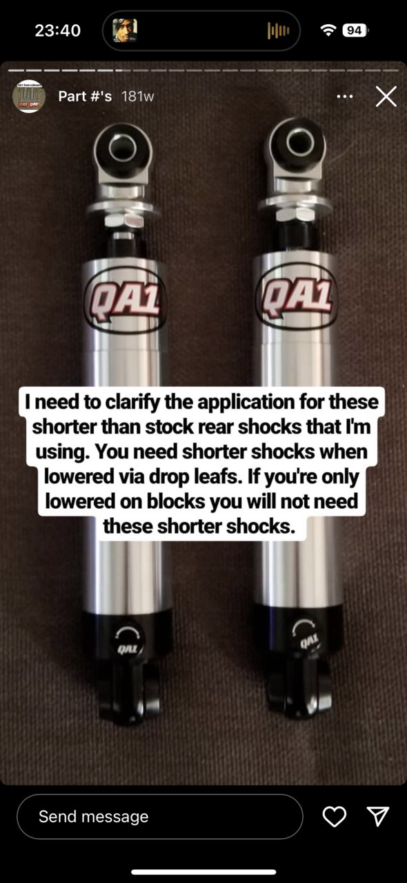

    I haven’t done it yet but you will need lower shocks these qa1’s have done other people good so I’m going with them

    . Do you have the specs on these? Extended length, compressed length?
  14. Mar 23, 2023 at 6:50 AM
    #354
    mjbtaco
    mjbtaco low and slow
    Mar 21, 2008
    #5423
    4,688
    Michael
    Montclair , so cal
    Turbo'd 95.5 extra cab and 2013 Silver DCSB TRD Sport
    PERFORMANCE Custom Turbo Setup FRONT SUSPENSION Drop Spindles by Aaron Carswell 01-04 Swaybar Endlinks Energy Suspension Endlink Bushings Cando Upper Control arms QA1 coilovers with 8" spring Custom 4 pot Brembo BBK Modified lower control arms with mjbfab qa1 mounting plates and Poly bushing sleeves REAR SUSPENSION Chasis Tech drop leafs QA1 adjustable shocks weld in drop notch Gas tank cross member bridge 3" angled blocks 2013 Double Cab Short Bed TRD Sport Eibach Pro Truck Shocks front and rear Lifted to the 3rd setting on the front shocks
    Qa1 ts504
    Extended Length (in.):
    16.38
    Collapsed Length (in.):
    11.00
    Flippy02 and Tikibutt[QUOTED] like this.

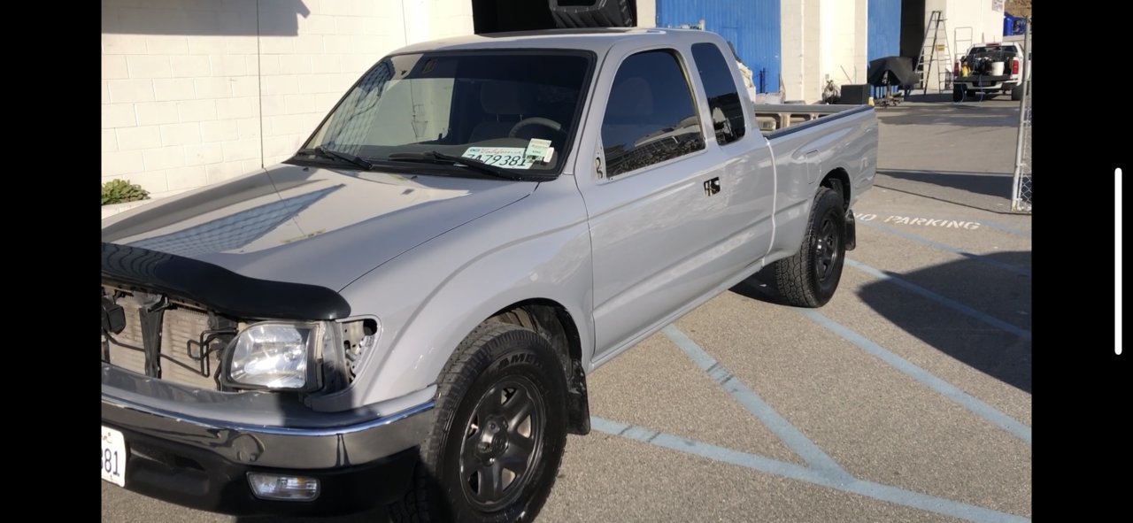

  18. Jan 6, 2024 at 10:56 PM
    #358
    rtk1nk
    rtk1nk Active Member

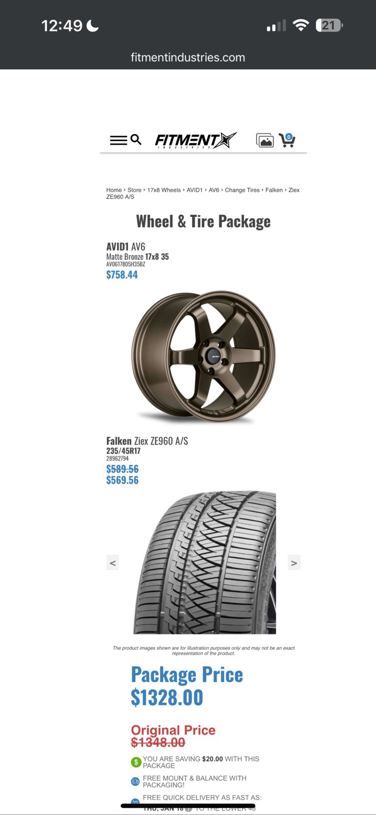

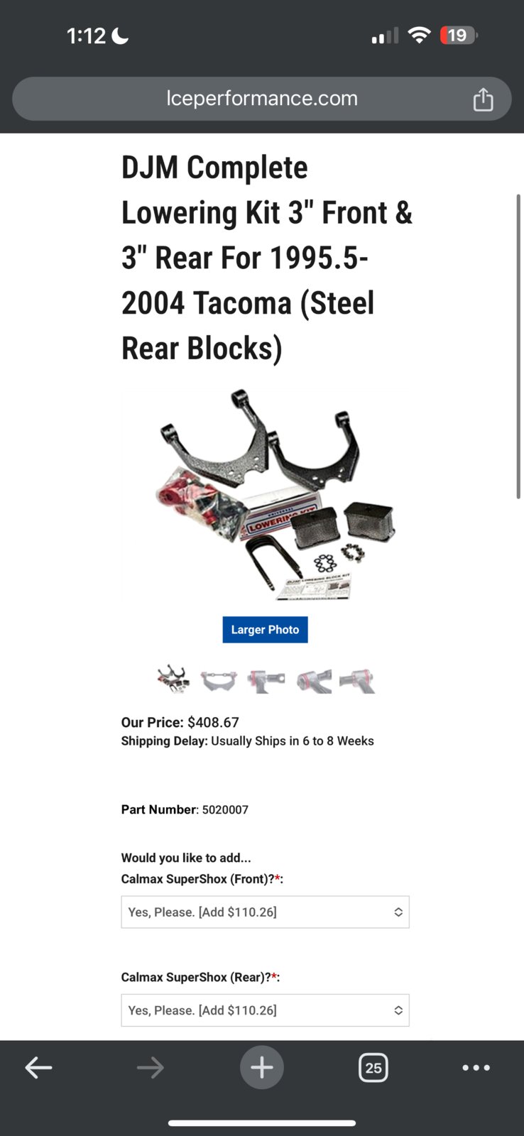

    Jan 19, 2022
    #387813
    25
    2017 Tacoma AC SR 2.7L 4x4 MT
    Toyota s16" Dark Anthracite Alloy Wheel
    My new (to me) & soon to be lowered 5-lug.
    04 2.4l 5-speed MT
    Came w/ some aftermarket wheels.
    I think it has aftermarket headers & exhaust (at least I think - sounds like it does)
    Feels like a short shifter kit was definitely installed.
    Bought from a local Toyota dealership but they didn’t give me much on its history.
    Suspension seems to be stock.
    Currently 16x8 on 235/60r16.

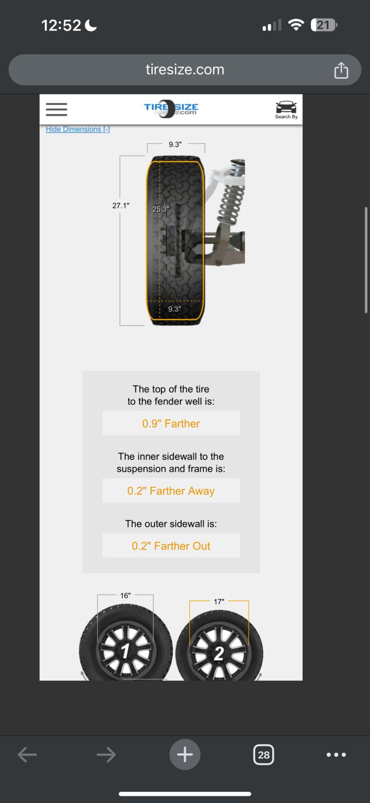

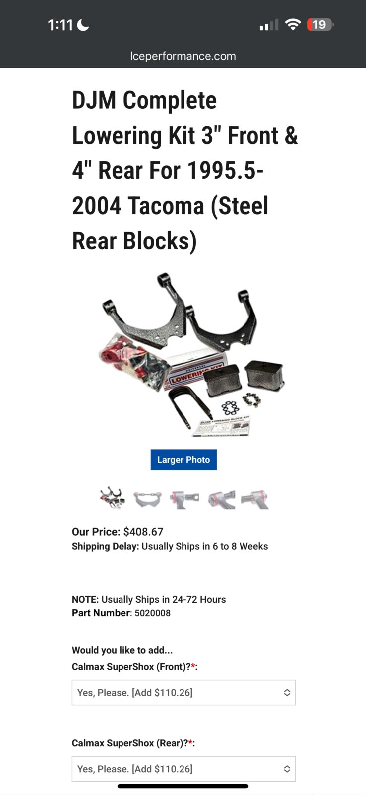

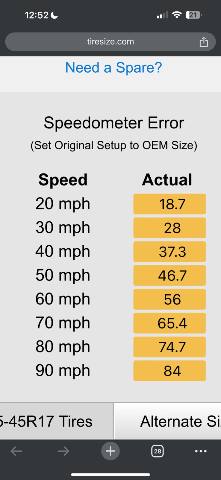

    The plan was do a DJM Complete 3/3 lowering kit (includes steel blocks) and optional front & rear shocks.
    Looking at going with 17x8 rims w/ the following tire options:
    A. 235/55r17 (27.2” wheel diameter/height) - Similar to stock specs
    B. 235/45r17 (25.3” diam./height) - recommended wheel diameter/height
    IMG_1884.jpg IMG_1887.jpg IMG_1885.jpg IMG_1886.jpg IMG_2113.png IMG_2114.png

    There’s a 3/3 & 3/4 kit actually
  20. Jan 7, 2024 at 8:12 AM
    #360
    2Runner
    2Runner Well-Known Member
    Jan 20, 2020
    #316661
    1,037
    Scott
    So Cal
    2002 Regular Cab 2.4L MT 2WD

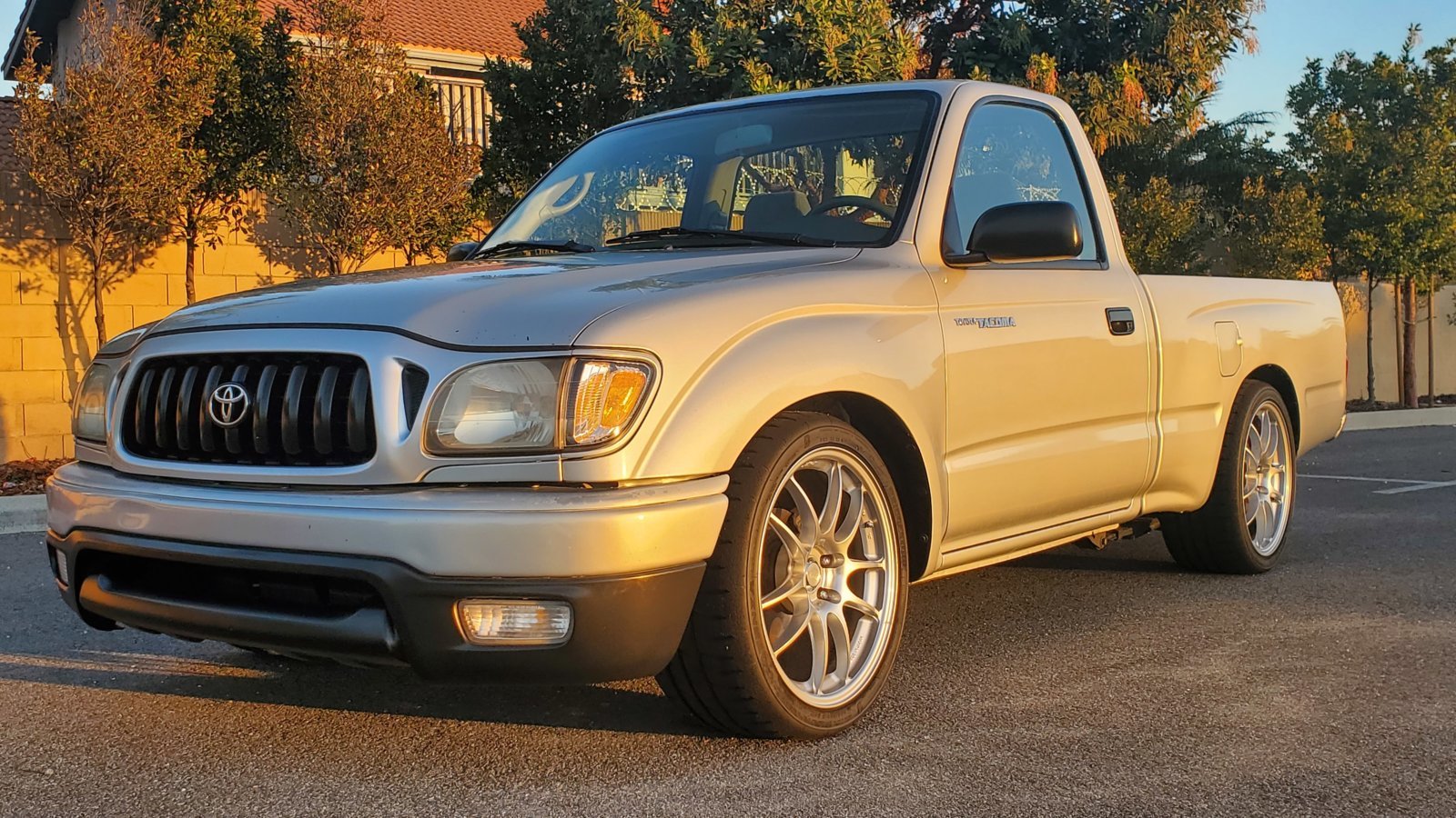

    @rtk1nk nice truck you "picked up" there!
    With a 3" drop you will need the shorter 25" diameter tires to prevent rubbing.
    Also I would suggest to look into drop spindles for a 2" drop without changing the factory suspension geometry, which can produce undesirable handling traits like bump steer. Then you could add a Belltech coil drop for a bit more lowering if you want more drop. Once the front is honed in you can add the block of your choice to the rear, they even come in half inch and quarter inch sizes to fine tune your stance.
    Check out my build thread for all the details (4/5 drop for high performance driving/autocross), and here is Trudy for some inspiration! My build is no where near a bolt on kit, but the results were well worth it.
    Here is a video on the autocross so you can see how she handles now and get and idea of what to expect - FUN!!
