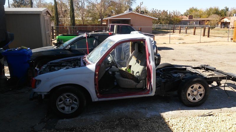

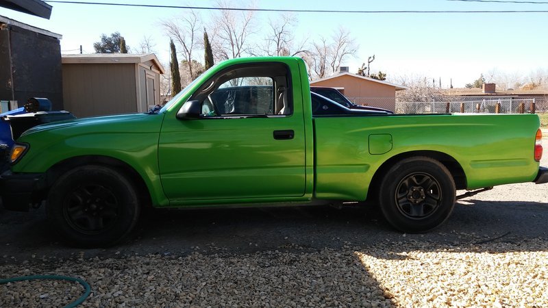

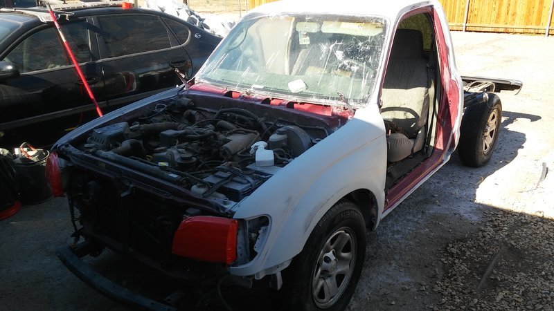

    Redwood
    Redwood Member
    Jul 24, 2016
    #192814
    23
    2004 tacoma
    New moter trans
    Here are some pictures
