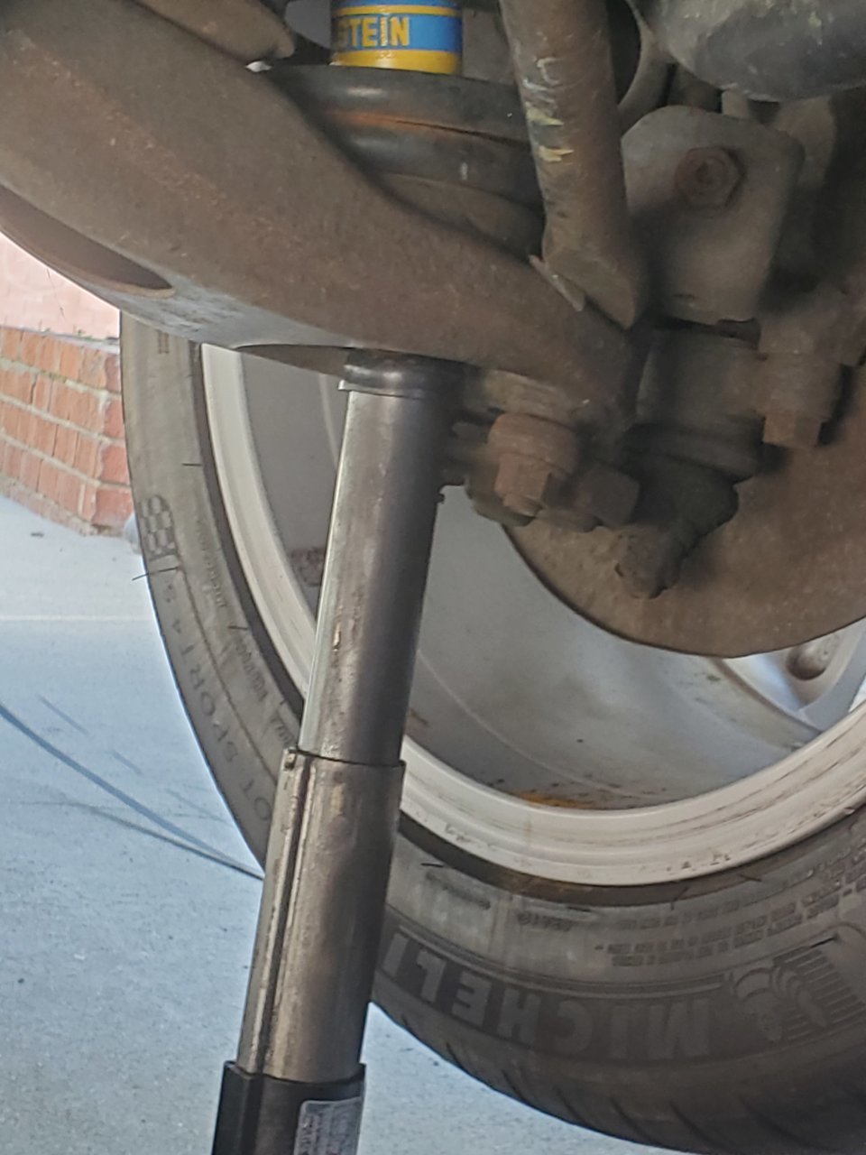

    As a tip I picked up for the install, I used the factory bottle jack to compress the shock into place to allow me to bolt it in on the fronts, and didnt need to remove the front tire with my "smaller" 245/45/17's.

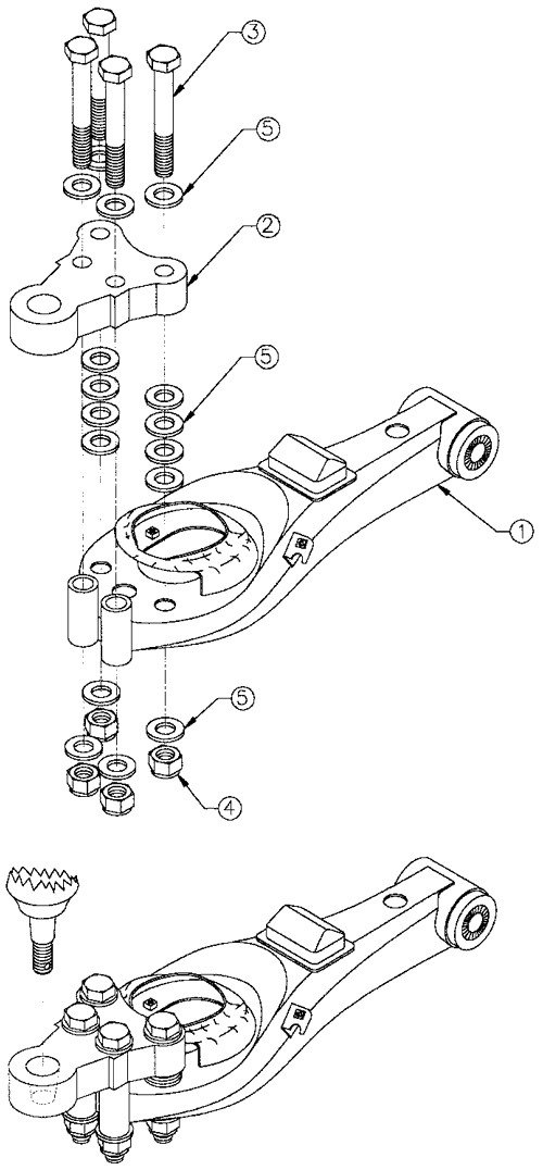

    There are 2" spindle "relocator kits" that are basically a ball joint flip that costs you way more money than coil springs even and gives you no benefit over the flip I am aware of, and I scarcely recall reading about many negative comments before on other forums.
    https://www.x2industries.com/produc...coma-hilux-lowering-spindle-relocator-2-drop/
    Found a diagram of these installed on images to illustrate how you are simply relocating or "flipping" the lower ball joint above the lower control arm to get drop. You can do a flip on your own for way cheaper.
