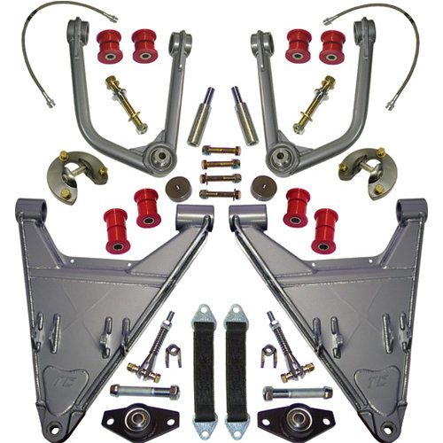

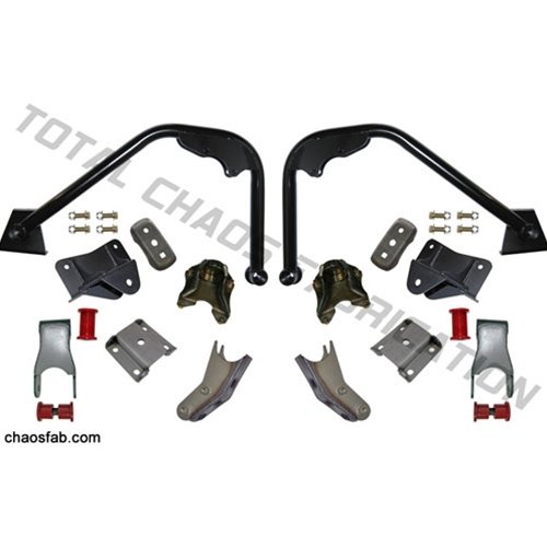

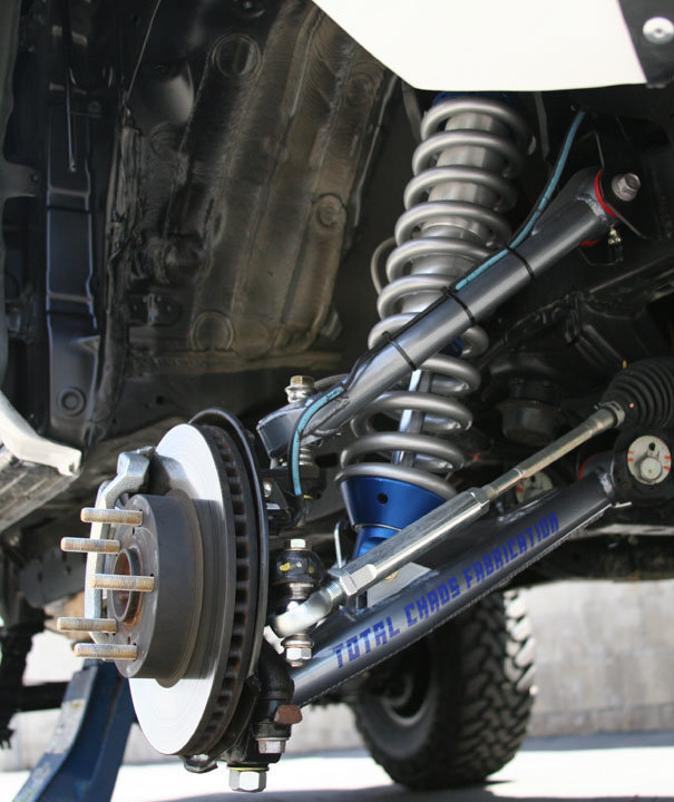

    That's impossible - the UCA and LCA are different for the LT kit than with the MT. Also, the shocks for the LT are MUCH LONGER. The difference between the 6 lug and 5 lug is the extended "eye" or hoop" that attaches to the LCA.
    But make no mistake, the shocks cannot be the same and the components are not the same.
    the photos show the Long Travel 5 Lug TC Kit

    TC and the JD kit both come with several variations of the LT kit. You must specify this when you order. They change the kit based off the shocks you plan to use like king or fix

    I think just mounts for the coils, unless you do the JD extreme LT kit that that’s really different

    The silver and blue is actually FOX, and the red is Sway-A-Way

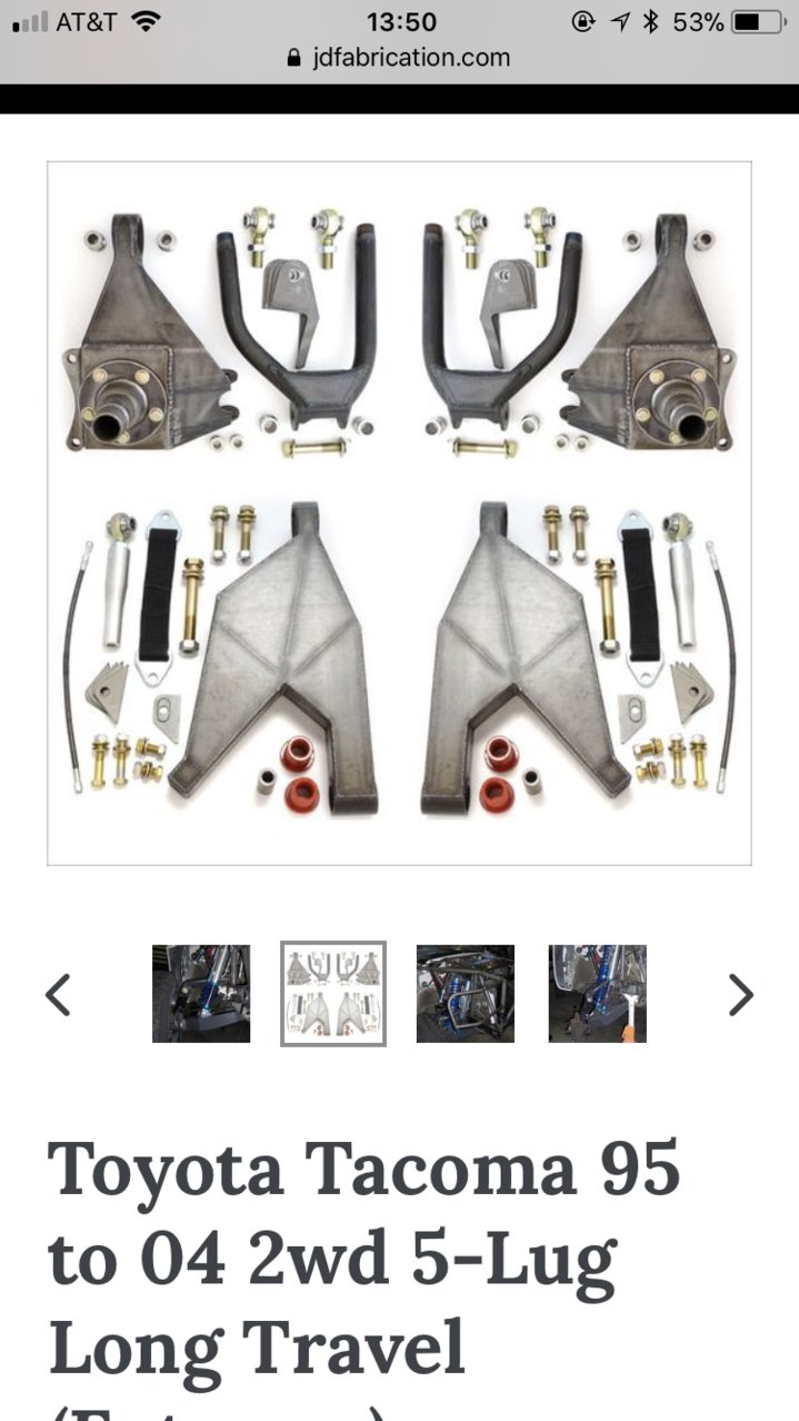

    Now, that kit you posted is for the 1st gens though?

    And once again 2nd Gens Get not love lol

    ^^^^^ it's all about leverage ^^^^ The mid travel shocks keep the same geometry but the uniball allows more movement and theres not as much metal in the center allowing bigger shocks. If you look at the pictures I posted there's a substantial more room.

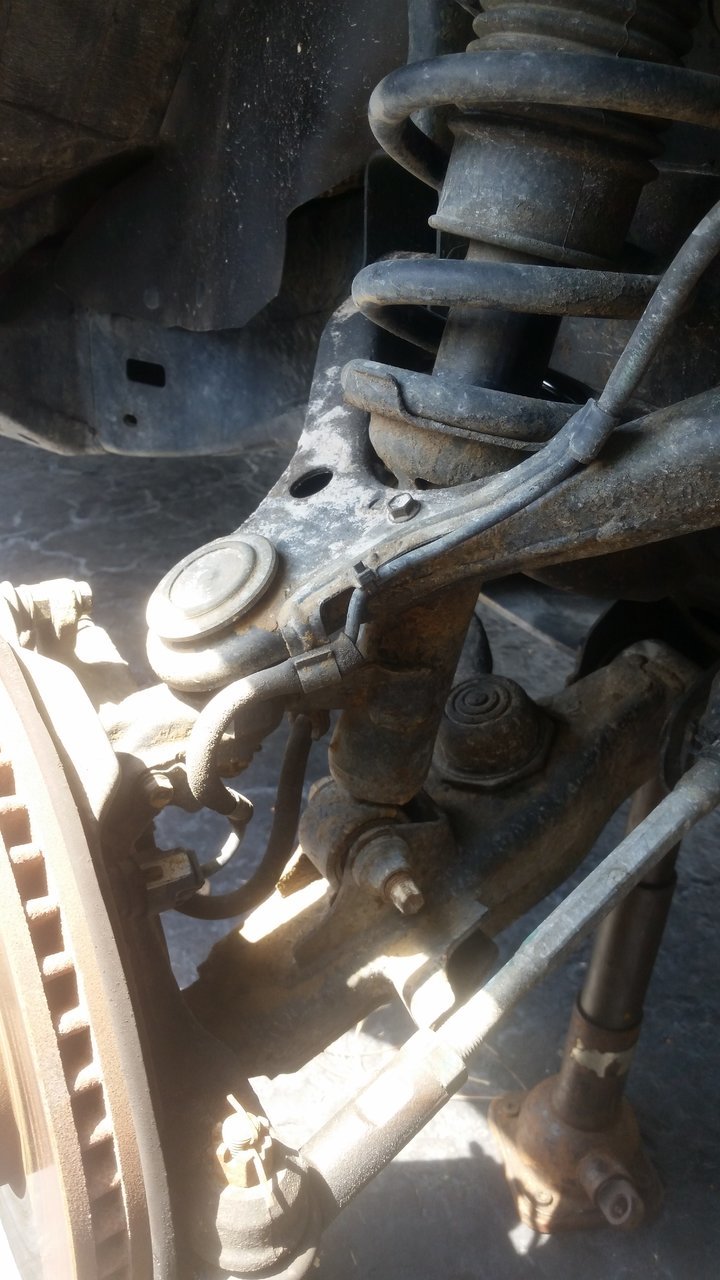

    Im talking more about getting the ability to put in longer shocks. At full droop with a spacer the uca hits the shock. Pretty much any extended shock would have a longer spring and would not fit with the stock uca.

    Looks like you need taller bump stops up top to avoid that from happening. Just saying
