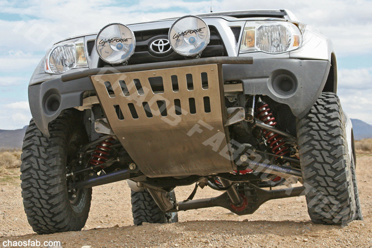

    You cannot fit anything larger than the readylift or fat boblift without a new UCA. That is why the readylift/fatbob is a dual triangle mount as the mounting point could not be lined up and still fit. That is also why the shock has to be over extended slightly a quarter turn I believe to utilize the lift.
    So here are the specs for the LT kit just fyi: I saved all of this info a long time ago in case they ever stopped producing them:
    Parts Included:
    Upper A-Arms w/ Bushings & 1" Uniballs
    Upper Shock Mounts
    Lower A-Arms w/ Bushings Uniballs & shock mounts
    4130 Tie Rods w/ ¾” outer heim joints
    Braided Stainless Brake Lines D.O.T. Approved
    Adjustable Limit Strap Clevis’
    Triple Wrapped Limit Straps
    17-4 Stainless Hi-Misalignment Spacers
    Grade 8 Hardware
    Parts NOT Included: (required for install)
    8" Travel 2.5" Shocks –Currently ONLY Fox PT# 980-99-246B or
    Sway A Way PT# 56000-108 8”- 2.5” coil over w/ 90 degree res. fitting & PT# 56107-100 single rate coil over hardware kit
    Fiberglass Fenders
    TC Accessories:
    Accessories Coming Soon!
    Vehicle Specs:
    Lift: 4"
    Wheel Travel: 13"
    Sug. Wheel Size: 15x7 3.75” B.S. (Caliper clearance required)
    Sug. Tire Size: 31” or 33” X 10.5 or 12.5
    TOTAL CHAOS releases the first performance long travel suspension system for your 2wd
    5 lug 2005+ Tacoma truck. After logging close to 500 off road miles on this system it is now available! 3.5” extended upper and lower control arms are built using 4130 chromoly tubing and were designed to eliminate the factory ball joints. The arms incorporate 1” Teflon lined uniballs for maximum strength and wheel travel. The kit cycles 13” of travel and is designed to bolt into the factory upper and lower control arm mounting locations and coil bucket. TC supplies a bolt on billet upper shock mount that is intended to utilize an 8” travel 2.5” diameter Fox coil over shock (PT# 980-99-246B) with external reservoir. 16” 600 lb coil springs MUST be installed with this system. Sway A Way intended shock systems require TC kit PT# 88000S and must be specified at the time of order. SAW systems include a welded boss style upper shock mount and will require installing SAW (PT# 56000-108 8” 2.5 diameter coilover with 90 degree res. fitting & 56107-100 single rate coil over hardware kit). Limit straps with adjustable clevis’ are included in the kit. These allow you to adjust the limit straps after they have stretched to eliminate any bind at full droop. TC includes an extended heim joint tie rod steering upgrade that replaces the factory outer tie-rod ends and uses a ¾” Teflon lined heim joint for max strength and travel. Weld on upper coil bucket gussets are also included in Fox packages to add strength to the upper shock mount. Some cutting and grinding is necessary for installation. The TOTAL CHAOS long travel system comes complete and includes urethane bushings & inner sleeves, hi mis alignment spacers, grade 8 hardware, uniball’s and heims, DOT extended brake lines as well as powder coat and an additional clear coat.

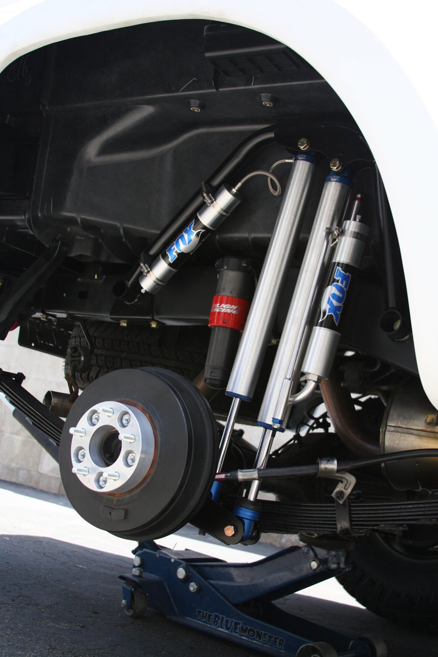

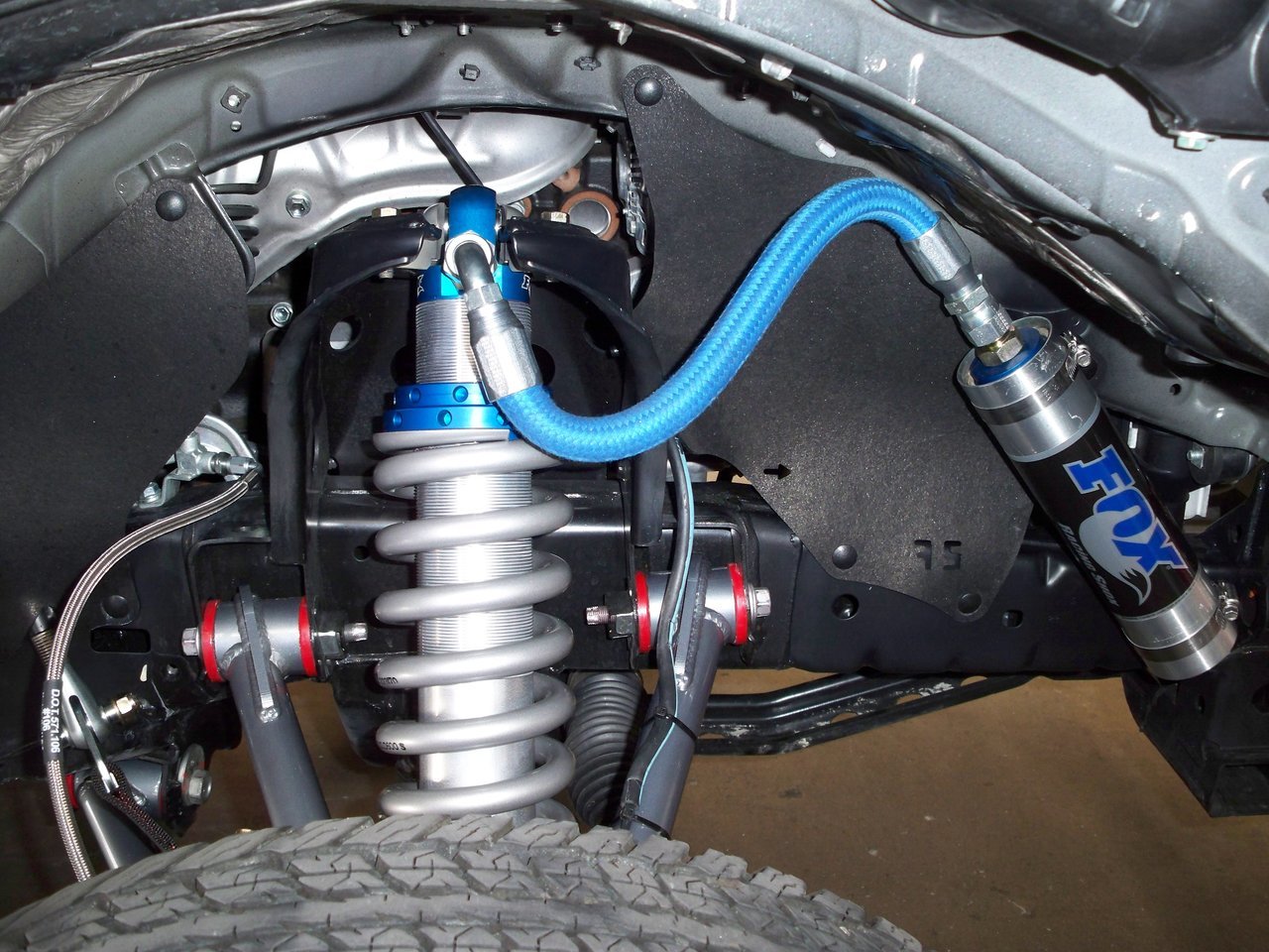

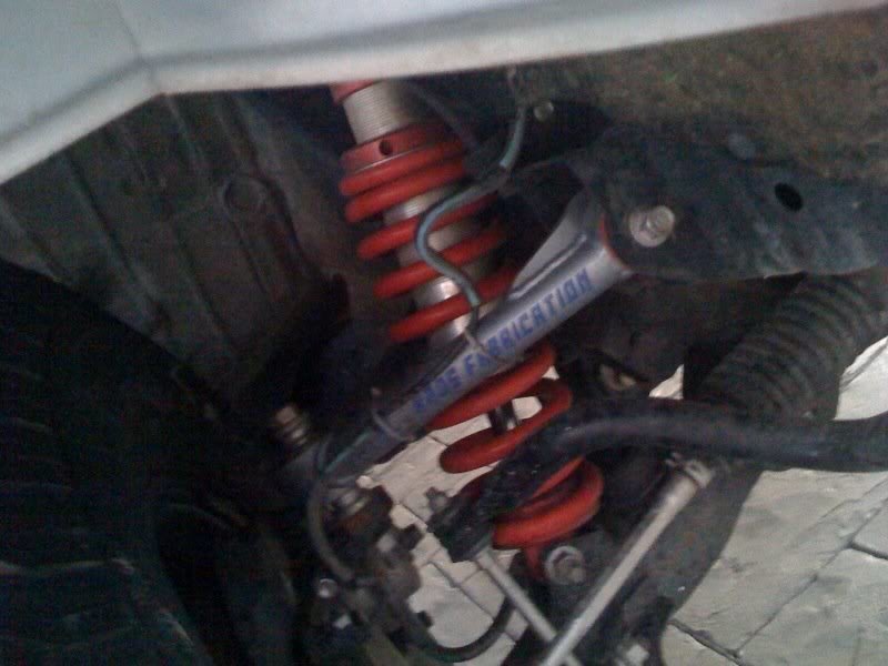

    Vehicle Modifications: TACOMA 2007 FRONT TOTAL CHAOS 5LUG ,LONG TRAVEL KIT 13" OF TRAVEL KING COIL OVER (550 POUND SPRING RATE) (18 INCH COIL) REAR BED CAGE 16" SMOOTH BODY FOX SHOCKS 2.5 2.0 / 2.5 BUMP STOPS FOX ICON ADD LEAF PACK WITH OEM SPRING 11" OF TRAVEL TRUCK COMES SPRING UNDER BY MANUFACTURE TOYOTA REGEAR TO 4.0 WITH AUBURN UNIT ENGINE 2TR-FE WITH AFE COLD AIR IN TAKE DOUG THORLEY HEADER MAGNAFLOW EXHAUST TIRE S NEW KO2 32/11.5 METHOD RIM 15" WITH -20MM OFF SET
    anymore pic

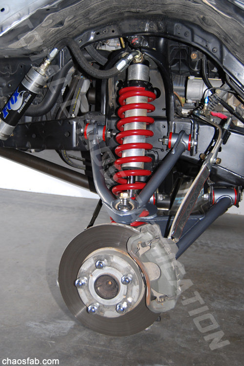

    tacoma 5 lug
    Icon with tc mid travel

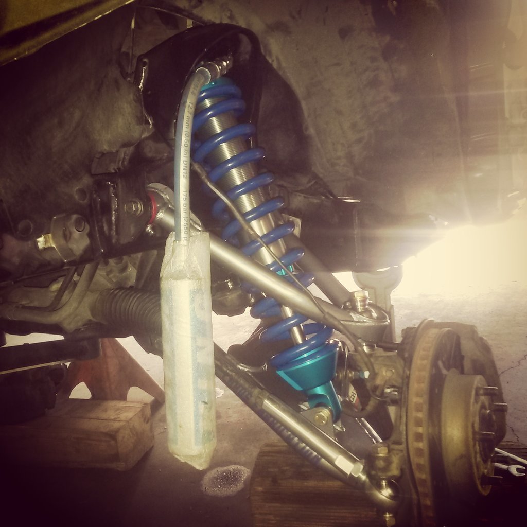

    tacoma 5 lug
    2nd

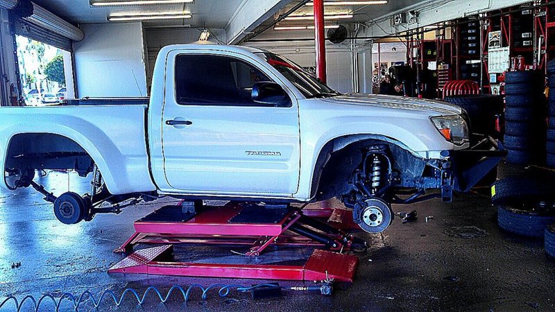

    dillon
    san diego
    tacoma 5 lug
    when the kit was new

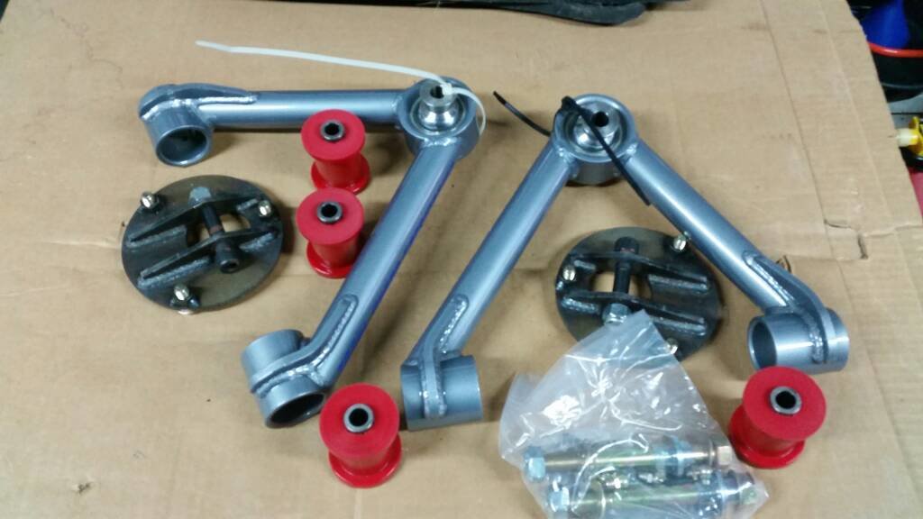

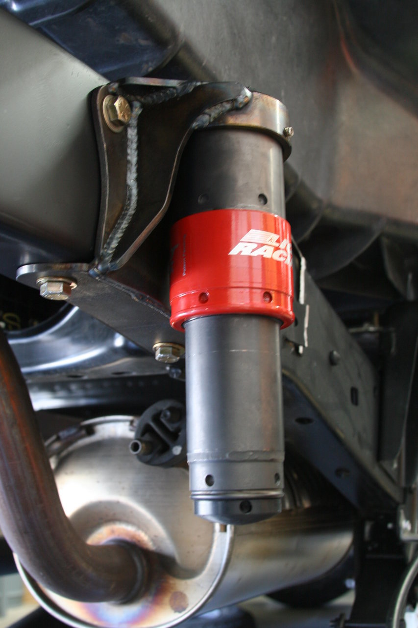

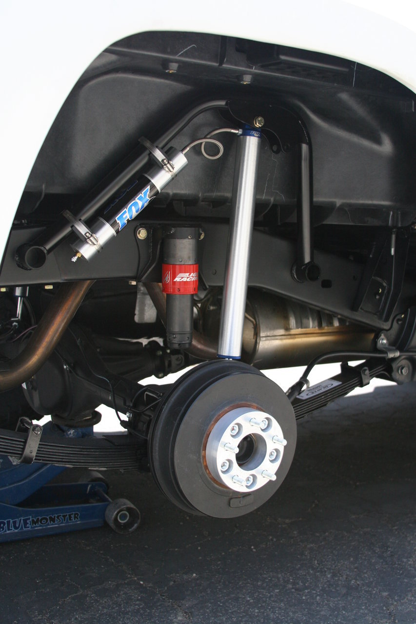

    everything I have other than manuals

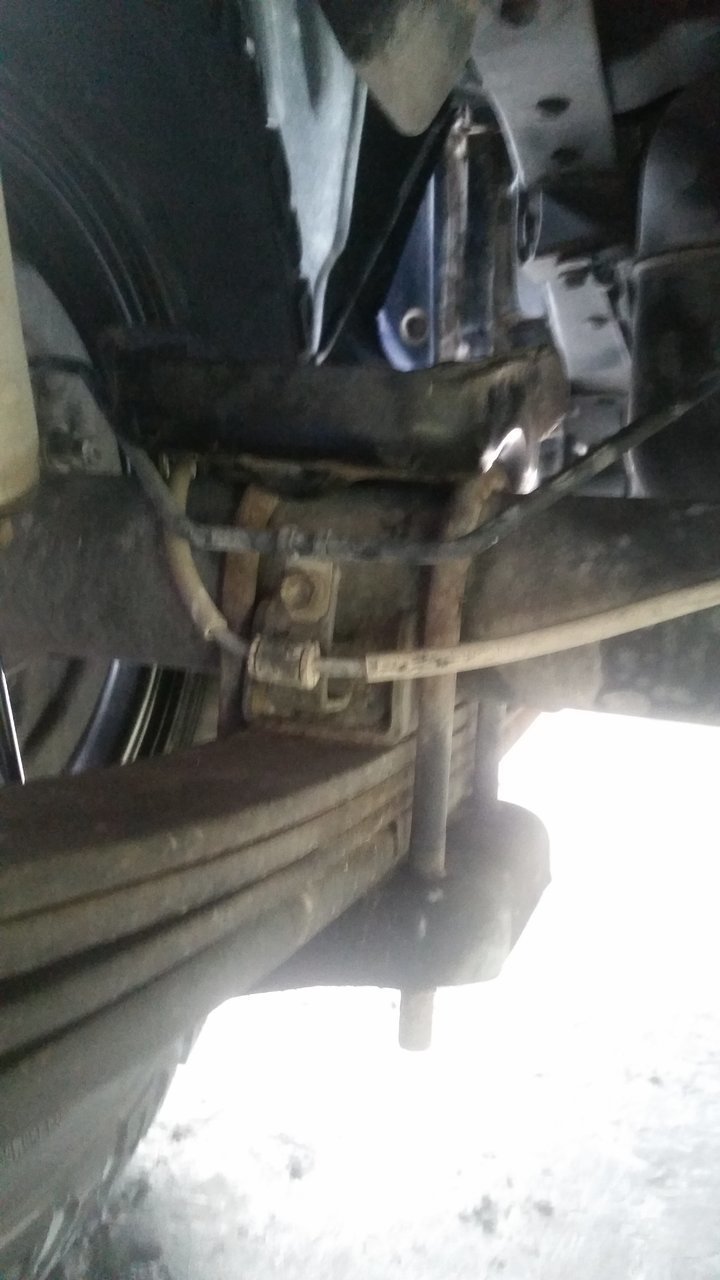

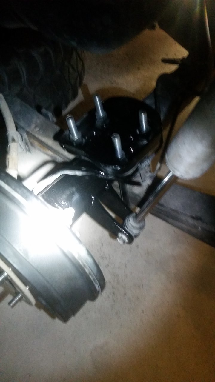

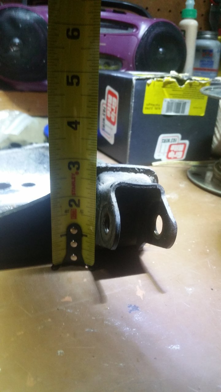

    OK here's a teaser of my ubolt flip/lower shock mount relocation. I'm going to make a separate thread for it when I get a chance.
    20180120_163718.jpg 20180122_201505.jpg 20180121_182450.jpg 20180202_150013.jpg
