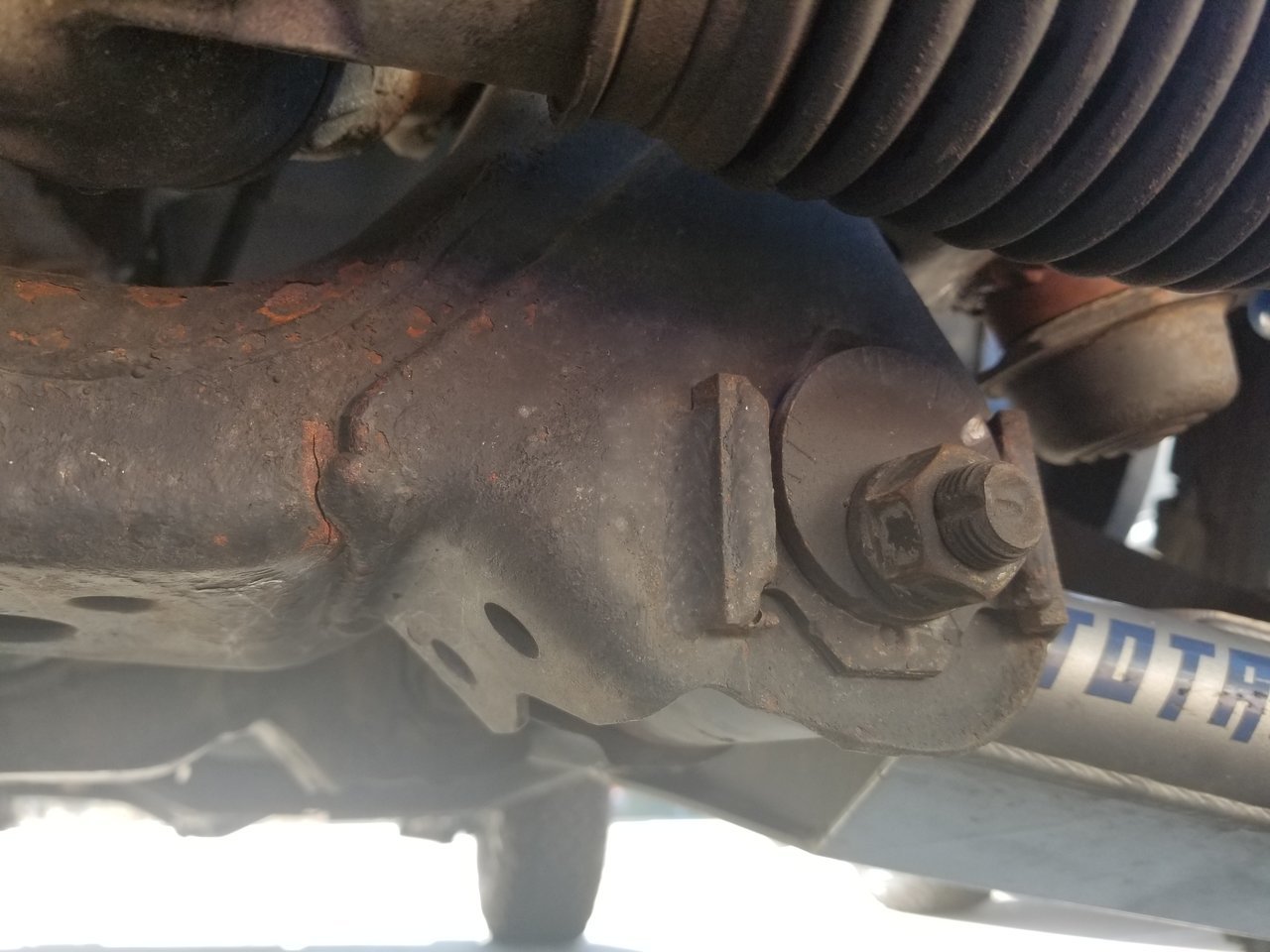

    Dude please PM me - is that your truck? I'm pretty sure you're Stup1dhurts buddy right? I need to talk to you - if you still have the paperwork and all the info on your kit I need that shit. Also, if you would ever be interested in selling your kit let me know. or letting me have someone measure the parts for replication?

    Isn't that a total chaos lt kit?

    yes that is

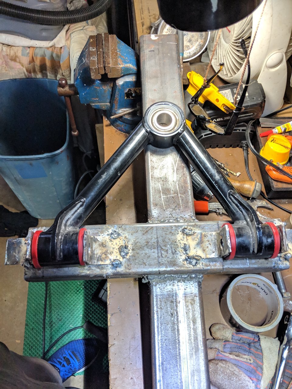

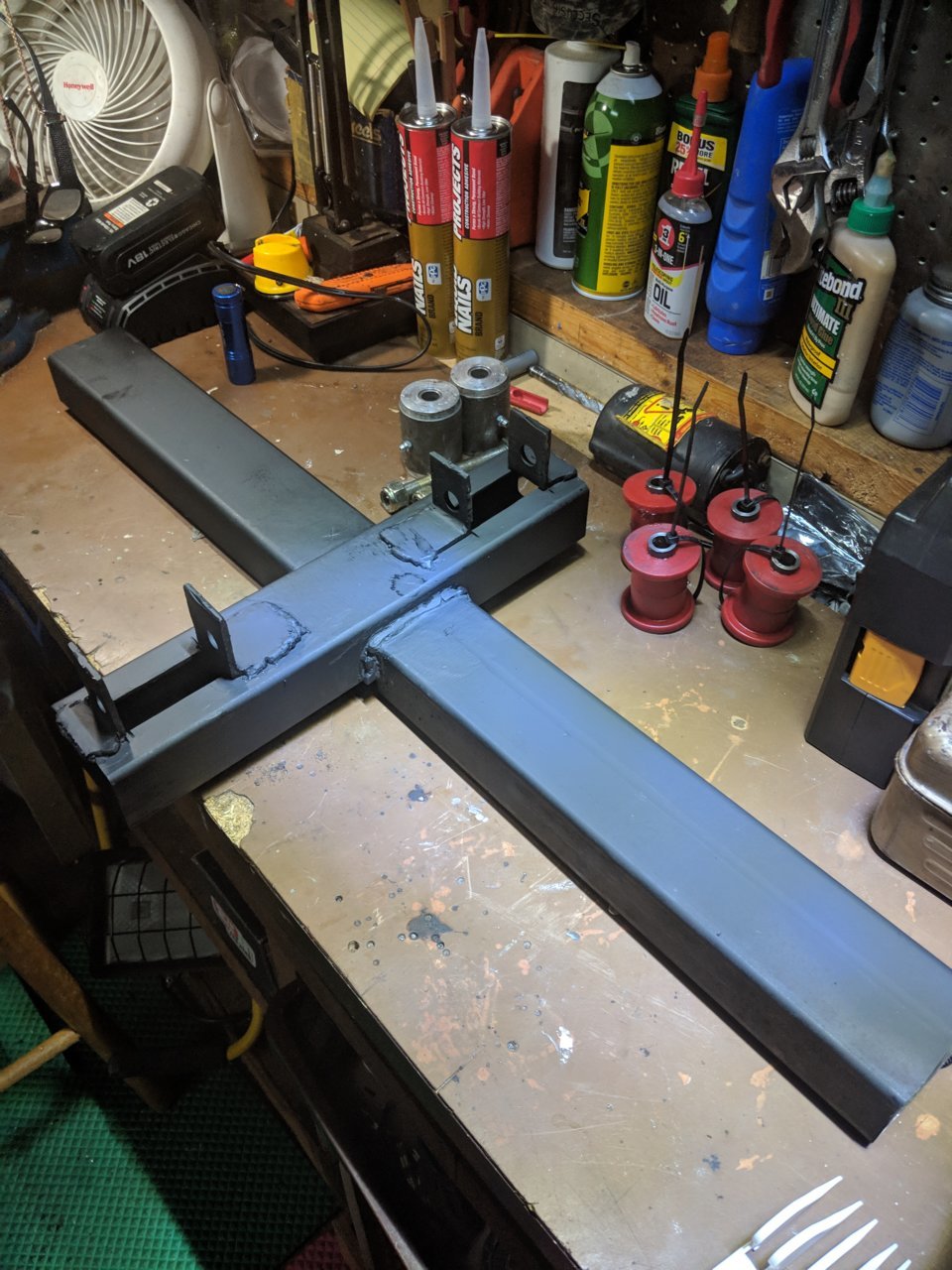

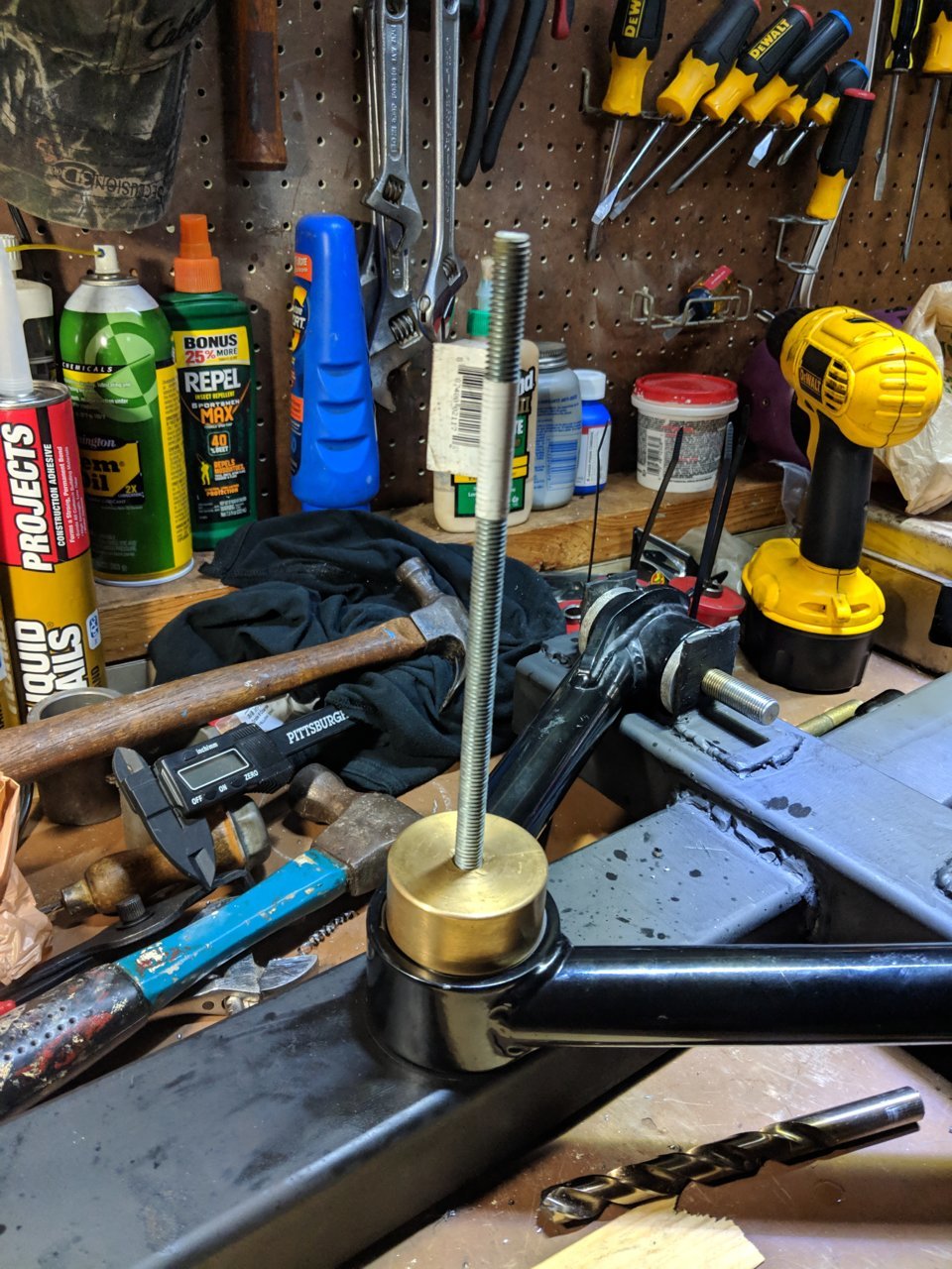

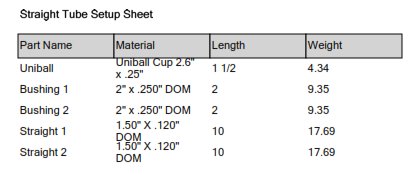

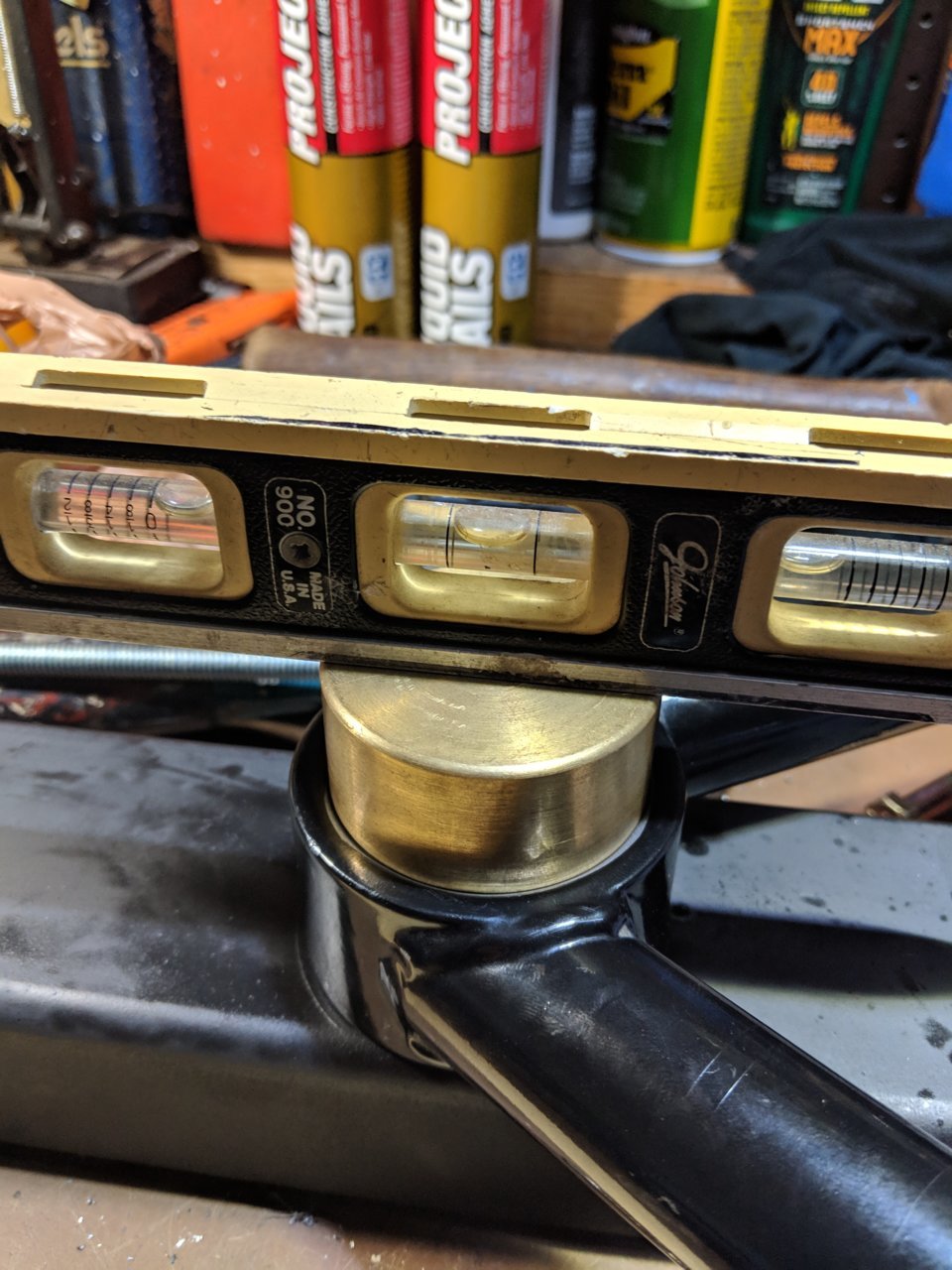

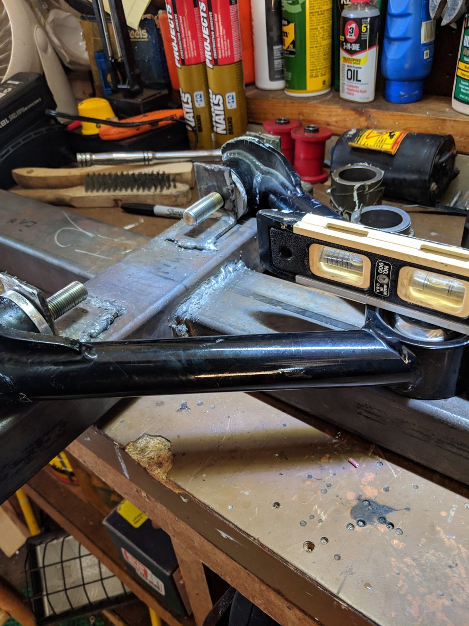

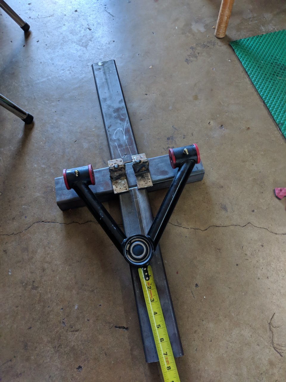

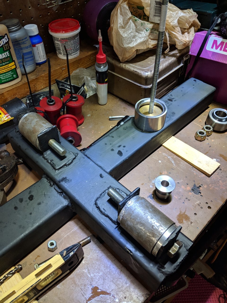

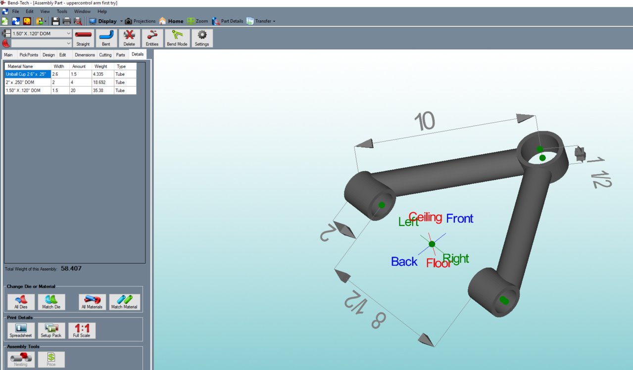

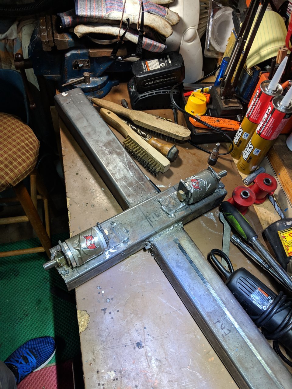

    Still working on it as im sure the measurements are slightly off buuuuuuuut :spy:
    Making it digital for notching angles

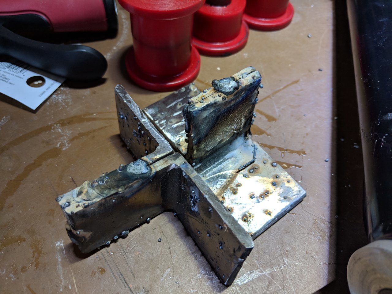

    Here's a photo dump of the jig i made.... Keep in mind the welds were done with a shitty hf 90 amp welder. I now have a lot better welder lol.
    Ready for some notching and welding(probably not done by me)
