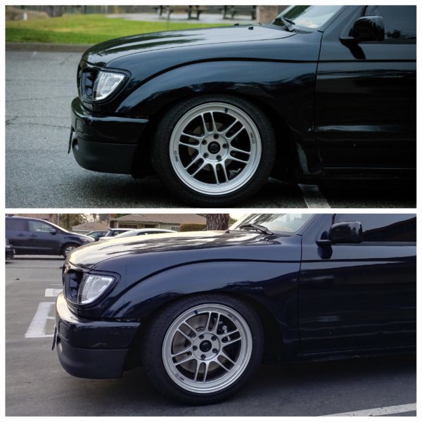

    Check out that difference lol

    Dude that's awesome. I bet it stops instantly.

    It does pretty good! Lol

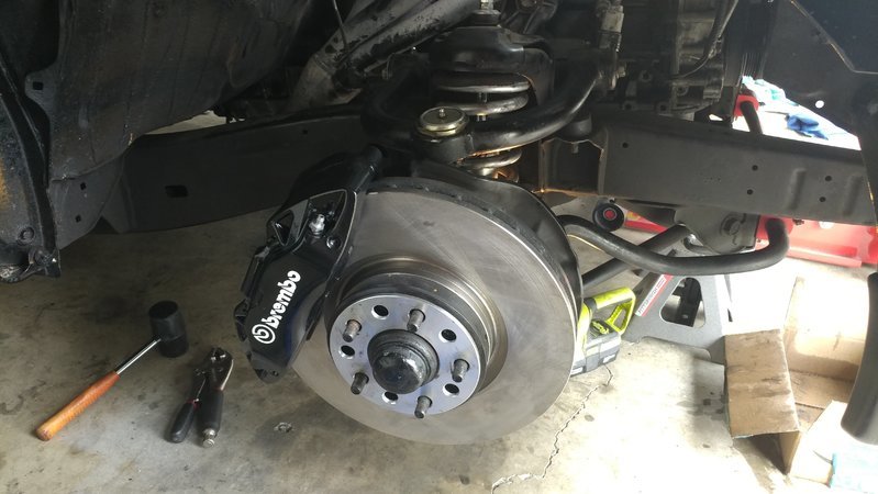

    Forgot to add the size of the washer to shim out the caliper to align it with the rotor.
    It is shimmed 0.13in or 3.3mm towards the rotor to align it with the rotor.
    There is also a 0.11in or 2.7mm washer on the other side of the spindle on the bolt to space out the bolt away from the rotor.
    I'll get the size of the bolt when i can.
    Edit the bolt is 14mmx1.5 still trying to get the length of it

    Looks like the chosen calipers are widely NLA now. From my research, it looks like the new caliper numbers are:
    AC Delco 172-2777 (GM 84089034) left
    AC Delco 172-2768 (GM 84089035) right
    These are the ones the Subaru guys are now using. I hope that the spacing hasn't changed and that it is still adapter free on the 5lug. They don't seem to have changed their adapter bracket so hoperfully these new parts fit. I will know soon.
    I'll also need to determine whether the hardware kits and pads are the same as used with the prior calipers.

    Looks like you are running wheel spacers. Is that required to clear between the calipers and the wheels, or is it for wheel fitment reasons?
    I got my rotors, hardware, and pads. Waiting now on the new part number calipers to see if I am screwed.
    Lee

    He probably has wheel spacers because his back spacing is to high so it would rub. With a lower bs on the same wheel he probably would clear. Thats just my guess

    Next Q: Is the Cadillac logo embossed on the caliper? Looks like they have been repainted (or powder-coated) and Brembo logo'ed probably with a high temp decal.

    The spacers would depend on offset of your wheel. Mine clear without them, I only have them in there for aesthetics. I went to wider fenders and wanted a little more offset to account for them.

    Great upgrade! Just wondering where you got the calipers with the big Brembo Logo instead of the Caddy logo? Thanks

    They were powdercoated then I put the brembo decals on

    you dont happen to have a measurement of the center of each mounting bolt do you? im curious for my avalon if the 4 lugs have the same caliper mount spacing

    sorry man i dont off hand. i do have a stock caliper that i can measure though i'll try to measure when i get home from work.
