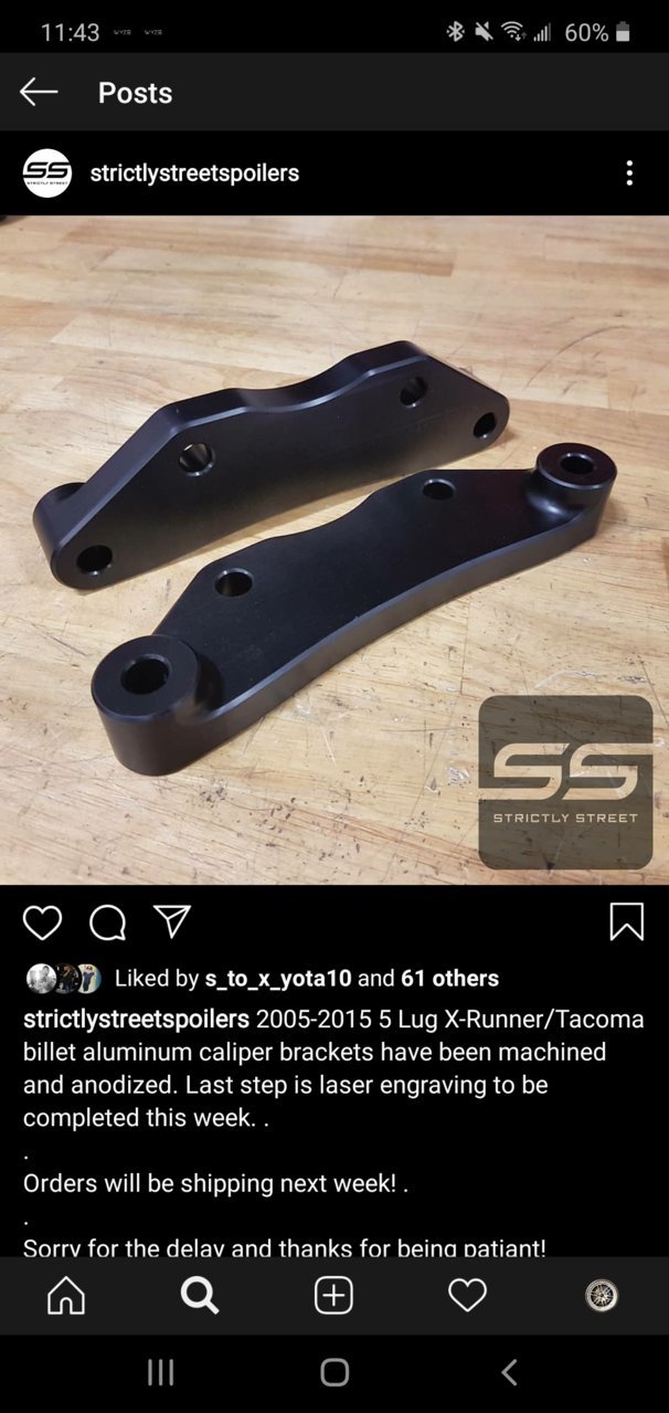

    Spindles are different on the pickups so these wouldnt work without a bracket.

    Hi everyone, has anyone tried this mod on the Second gen taco? the spindle looks very similar.

    I have a word of caution for the people preparing to convert their spindles to the Cadillac ATS calipers (I got them for a 2014). My 1995.5 Tacoma spindles have caliper mounting brackets with a center-center spacing of 5.123” (4.645”min & 5.600”max). The ATS calipers had a spacing of 5.040” (4.500” min & 5.580”max). I make no claim as to the accuracy of my measurements.
    The calipers can be made to fit. But if you just enlarge the holes to 9/16”, you may find that the caliper will not bolt to the spindle.
    The method that I may have used is to carefully use a die grinder to remove metal from the 4.65” value and get it down to 4.50”. I then may have used a 14mm drill bit on a small drill press to make sure the holes were cleaned up.
    i may have also clamped the old rotor to the Subaru rotor for a template in drilling and tapping the 5 holes. Aligning them is crucial.
    A machine shop would have done this better, but there may be people wanting to tackle this themselves.
    This is an awesome upgrade. Now I just have to get those QA1 coilovers…

    Because of how the 5 lug rotors bolt to the back side of the hub, there's not going to be an easier (direct bolt-on) source for the rotor. You'll have to get them machined. Or you can go 2 piece and get a custom rotor hat made by someone like Wilwood then you can just replace the rings.
