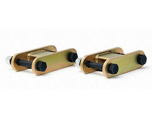

    The coil spacers claim 1.5" combined with the Fabtech spindles the front would reach 4.5" The rear would sit at about 5" with the shackles supposed to add 2" with the AAL and shocks. Total n00b you guys so plz understand. A lot of the better kits were discontinued before I could even drive lol One last thing I know there are 5 lug lift threads but they aren't really to 2020 spec. Finally yes before you ask it would make way more sense to buy a Prerunner or 4x4. Sentimental value high school truck first kiss blah blah blah. Plz help get my mini truck in the sky thanks

    If u do the fabtech spindles and shackle, with v6 coil springs and the spacer and 31s you will actually be a tad bit taller than a stock peerunner/4x4. 5lugs are p fun on the forest roads and around town for sure, have fun

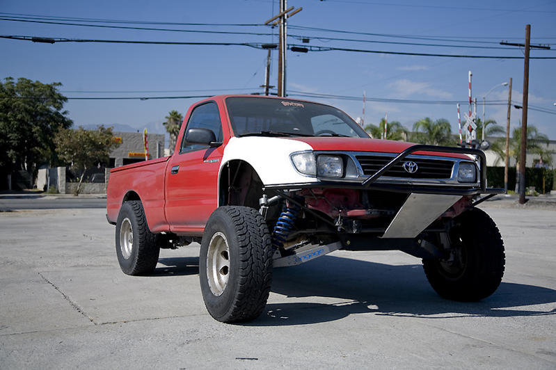

    What long travel kits should just look at?
    Pretend like your talking to someone who is proud of themselves for finding a vacuum leak.
  8. Sep 26, 2020 at 8:36 AM
    jruiz555
    jruiz555 Well-Known Member
    Jan 12, 2019
    #279080
    1,178
    Mmmm. Total chaos makes a solid kit but your looking at min 4k for just the front setup.
    U can beef up your truck a bit, throw on a rear pre runner locking diff "complete axle and leafs" then on the front either long travel or solid axle. The front suspension on a 5 lug is very weak. I would replace my ball joints every year to be safe. Thats just me..

    Ouch. Budget is about $1500. I get what you're saying but I've already invested a lot of $ and <3 into the current 2wd truck. Maybe I'll find a used LT kit. That's a real risk tho.

    I had my trunk since 04 and i only came across 1 used long travel kit. The kits normally stay with the truck because u need to cut and weld the shock hoops.
    Fun truck to drive, i ran the fabtech ultimate lift. I dont think they sale that kit anymore because people kept confusing the lift with a offroad suspension and kept braking it

    Yuuuup. And that's what I'm trying to stay away from. I only want minor fabbing or trimming. Something to take on or off if it comes down to needing another 4 grand and an open parking space lol. Spindles seem to be the best way ATM

    U put big enough tires and reinforce the lbj bracket with a rear regear/locker u can still have some fun with a 5 lug. Prior to lt, sas would run u another 2-3k more than lt most likely but yeah itd go anywhere

    Wish i could find this kit haha

    Really appreciate it my man Ill check out those then. I'm not sure if I should use those Fabtech struts with them or not but maybe someone else does. That long travel kit looks tight. But so am I :facepalm::D Money solves so many things amirite
