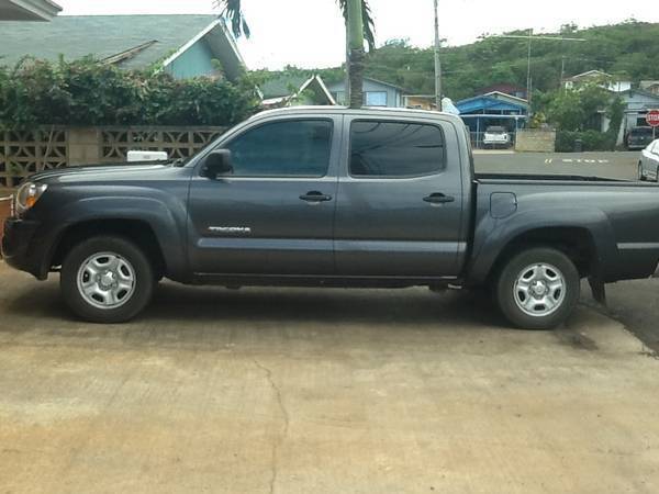

    and a lift or something. i know that 235/75 is the biggest on the stock steelies. and i heard that if you do the black box mod you can fit 30x9.5/15 with no lift and no rubbing. i really want to do that but its not 100%. its just what people heard. so if anyone knows if its true please inform me on it. my taco looks like a little girl with those ugly tires. but i still love her

    here she is

    Im runnin 30x9.5 on my stock 5 lugger. Removed the black box and I was good to go.

    really like the way it looks.. im going with this. no mods just the black box?

    i wanted to drop it but i go riding my dirtbike at the tracks and inorder to get there you have to climb the mountain. so thats ut the picture. but all my budds said it would look awesome. but imma go with the 30x9.5 and the black boxes

    Yuppp ... No other mods. I went with some ProComps 7169??? i think that was the model. 15x8 and 30x9.5 tires. Had to put 3mm spacers in front to clear the calipers though. 5 Luggers should have came with 30x9.5! haha my Tacoma looks and feels like a truck after the bigger tires.

    Thanks bro. Looks pretty bad ass with no lift and some pretty fat tires. Stalky like bull dogg. Now time to save up. Or just use some tax return money. Hah

    I'm new to Taco world. What is the black box? I'm wanting to modify my 5 lug reg cab and have been looking at Ready Lift's 2.75 2wd lift but I like the look of yours with the 30/9.50/15s.
